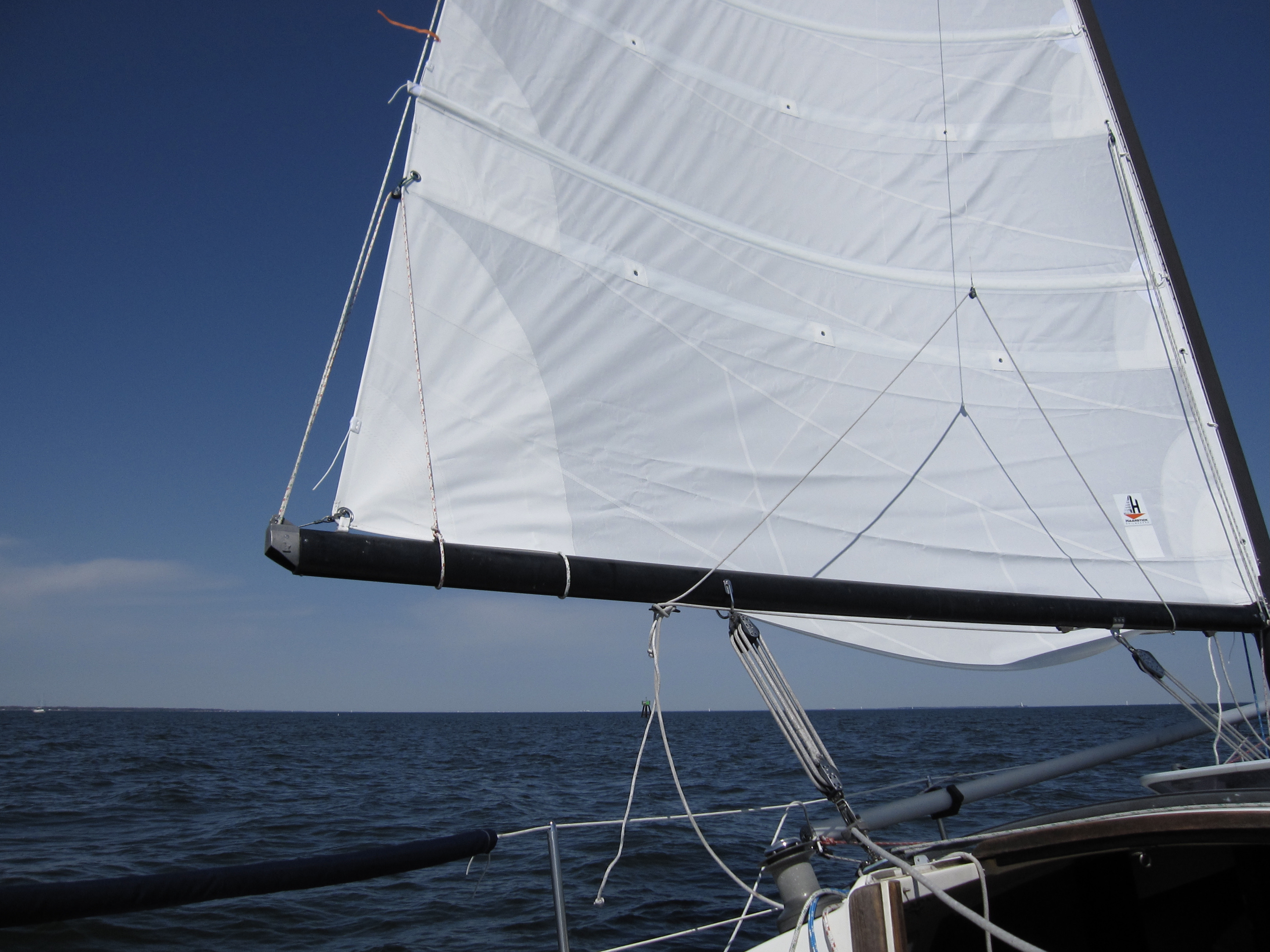

I hope this helps!

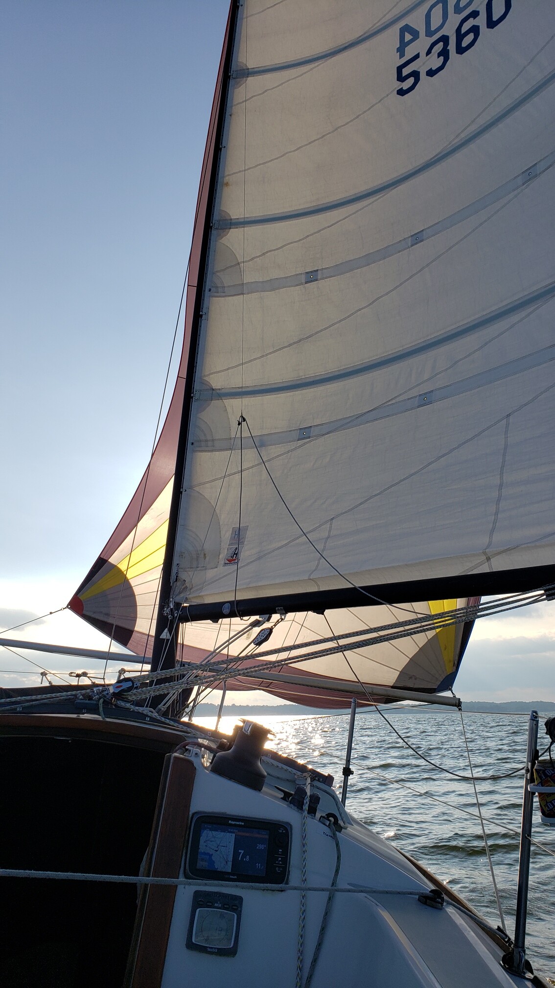

If you have the fractional rigged spinnaker with the round mast like me then I don’t think running back stays are needed.

Yes, that’s a big help, thanks! Shows where the lazy jacks go, and both reefing lines. I think I’m missing the vang, though. I only have one set of lines with a pair of blocks.
It looks like you have both a solid vang holding up the boom, and a line and blocks holding the boom down. Am I seeing things?
It looks like a kicker.
Yes it is a boomkicker. I posted some info about this and some other stuff you might find useful in this thread a few years ago:

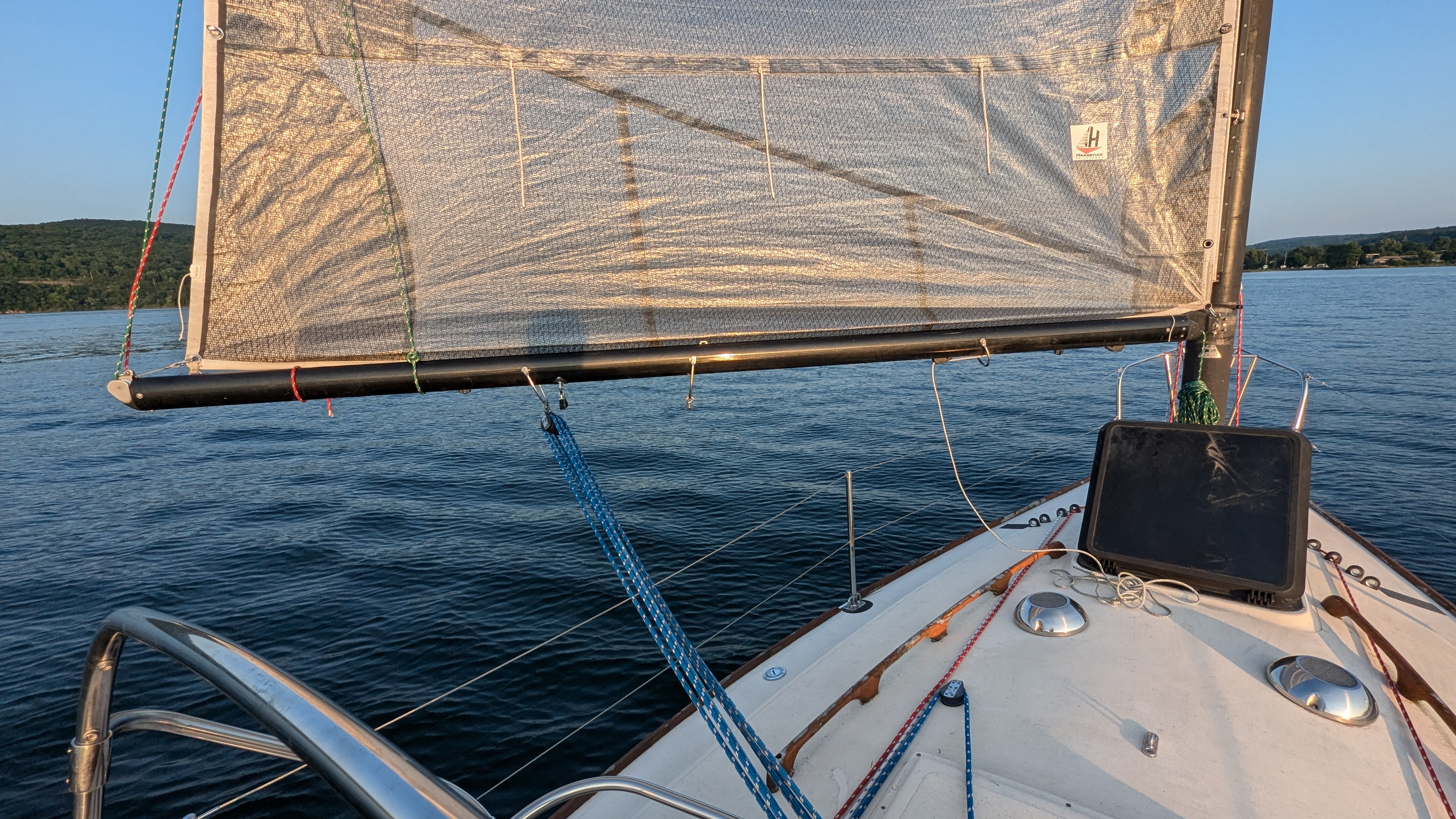

Can I get a little help with identifying things on the boom? The manual isn’t an awful lot of help. From left to right, you have:
  1. the red first reef line
  2. the green second reef line
  3. bullseye for lazyjack?
  4. attachment for the mainsail sheet
  5. smaller attachment with two blocks
  6. attachment with one block
  7. cleat for the outhaul line
  8. attachment for vang
  9. bullseye for lazyjack?
  10. cleat for lazyjack line?
Oh, and see the block on the roof of the cabin that I have the mainsheet running through? I’ve seen pictures of other F25’s and they don’t have one. Is it really for the mainsheet? Also, what’s that attachment to the right of it for? Anybody know?

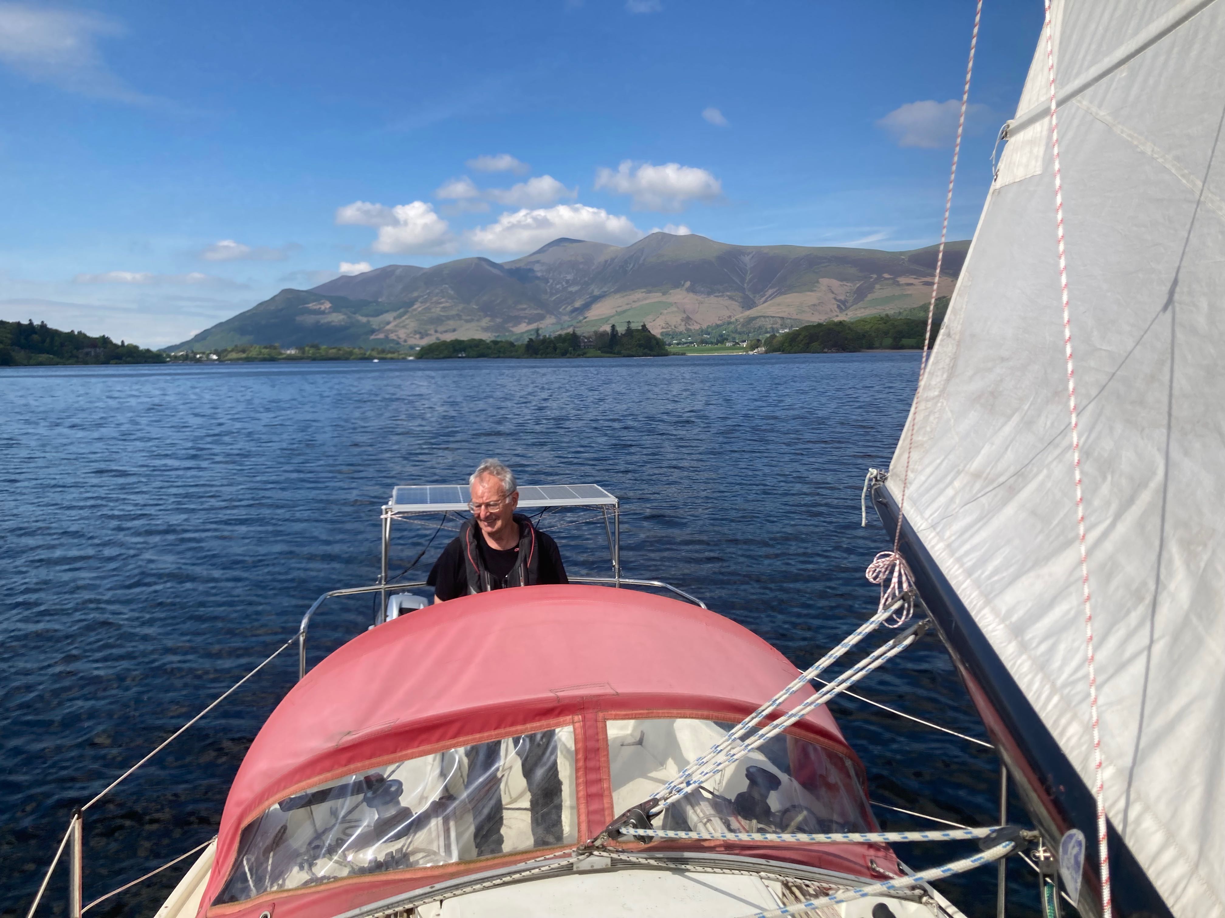

Concerning the mainsheet. If like me (I have an F21 not 25 but they are very similar) and you have a dodger, the standard way of running the mainsheet gets blocked. I therefore have rearranged the mainsheet to go forward to a block on the boom and then down to the deck through a block and back through a fixed port in the dodger. This was I can use the traveller and the mainsheet does not move. You can see most of it it here but not the deck block:
