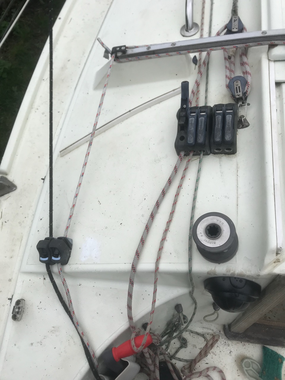

I have an F21 not F25 so can not give you lengths. However there is good reason to have a continuous line for the reigns. With separate lines from both ends of the pole, you are just adding more rope to the cockpit, which has enough from the clew lines and pole adjusters. My setup has lines direct from the pole, over the lifelines and into a Spinlock cam cleat on the cabin roof. The black line in the picture. When sailing, I run this to the starboard side across the top of the cabin, so no extra rope in the cockpit. A bit of slack is required if you want to extend the pole forward of centre when on a reach in light air.

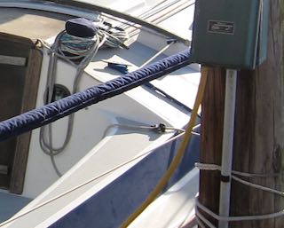

These are measurements made by the PO of my boat. I am still using much of this as-is, although I did shorten the (single-line) reins by a few feet. Basically, I shortened that line so that I could still easily hold the reins while standing at the tiller. This line runs through blocks attached to the bottoms of the stanchions on either side of the “bridge deck” area amidships.
Here is a photo showing how the reins are routed to a cam cleat on the port side of the front end of the coaming:
Starboard side is same. The stanchion holding the block is behind the dock piling on the right in the foreground.
