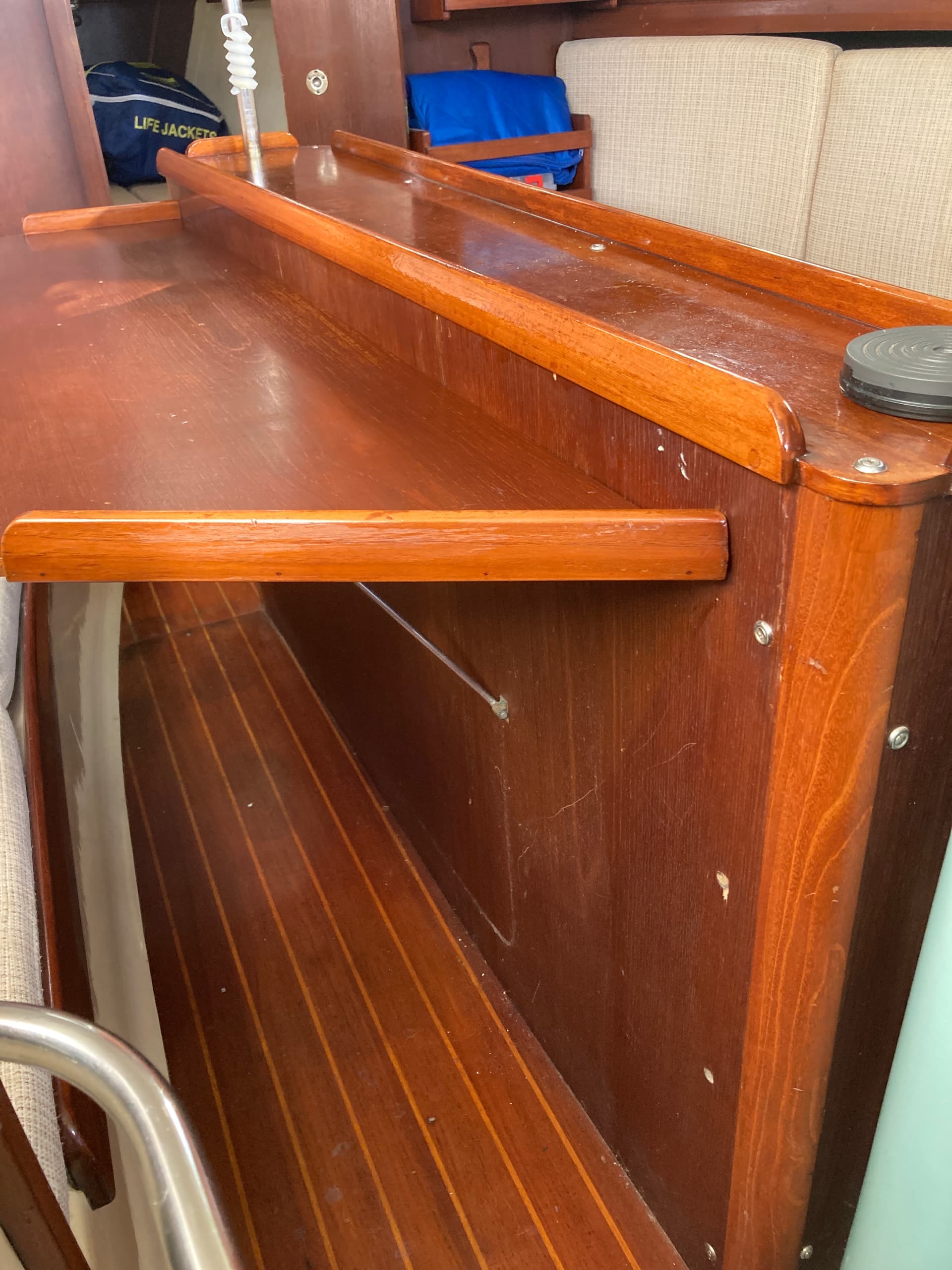

Could someone please measure the approximate dimensions (length and height) of the 2 plywood/veneer side panels on the F28/30 CK centreboard trunk for me (not including the two end pieces, just the side panels)?

Just saw your question. My Hamble built f28 ck #112 centerboard case sides are 32 3/4 “ x 63 1/8”.
Interestingly the US built F28ck I saw years ago case was 2” lower. Table on side same level as the top of case. Not certain for reason.
The first owner of my boat said he really appreciated the center board case in a seaway. Safer to move about the cabin… and helps with snorers on opposite side.
