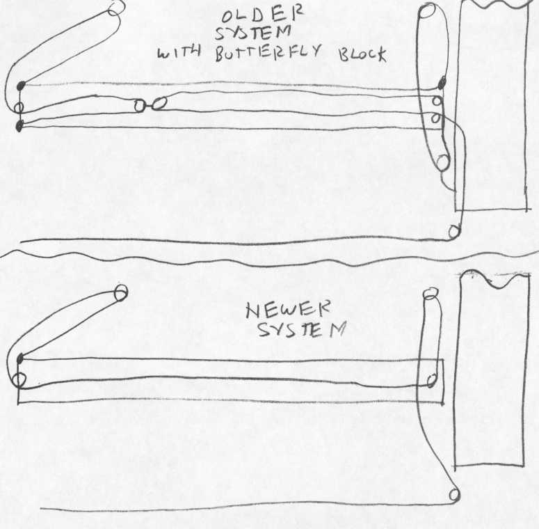

I’ve attached a quick draw of single line reefing on wishbone. Tied from the Padeye a foot or so from the end of the boom, through the reefing grommets on the sails, down to a block on the padeye on the other side of the boom, back to the double block where the outhaul uses one block, then between the sails to a block tied to the boom lash between the sails, down to a block on the deck ring, back to the pillow blocks on the deck and back to the cockpit. Dump the wind, lower the halyard some and pull on the reefing line, then tighten the halyard, and ;put wind back into the sails. When I’ve got it set up right, I mark the halyard and reefing line with magic marker so I can go there right away the next time. Mine’s a 40 so I can’t give you lengths.

Thank you, Carl, but that only brings down the clew reefing cringles. That arrangement is the one given in the document for the UK built 30 available in the forum’s documents section (Nausikaa original rigging schedule - Freedom 30 ck.pdf). There’s also the reefing points on the luff, so it’s a two-line system. I’m happy to rig it as a two-line system, but I am curious about references to a single-line system.

I installed single line reefing on SV Raven, F28CK with WB booms per the attached diagram. My sail has a pair SS rings on straps to attach the sail block (you could attach to the boom lash). It works just fine.

Thanks for that. I see that you drop the forward end of the boom. That doesn’t tie in with the description of reefing in the various documents that I downloaded from the Manuals & Documentation area, or with the diagram in the Freedom 30 owner’s guide. That pulls down a fold of sail parallel to the boom, with the reefed fabric being pulled down between the plies. Thanks for comments, everybody, but I shall stay with two-line reefing.
Original reefing setup.pdf (390 KB)
I was puzzled by the Freedom drawing (scan 0001). The boom remains at the height and angle you set when sail area at 100% (left diagram). The mast end of the boom does not lower as shown in the right diagram. Good luck with your setup.

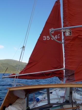

I have also developed a good way to put a second reef in the backsail, given that the wishbone is not strong enough to take the clew lines and attach a photo of an unusual 1.5 reef in the frontsail which works well on the run and keeps the outer end of the wishbone low. where it doesn’t hit the back wishbone on a gybe.

That looks like a “scandalous” sort of reef!
