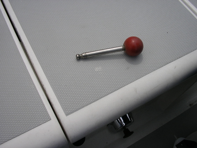

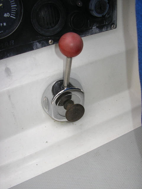

OK, so here’s the engine control, and the handle pulled out. From what I can see, there’s a little ball that must be sprung somehow that’s supposed to hold the handle in. Anyone have any ideas how I can remove the outside cover, snug up the handle retainer, and make the whole mechanism a little less wobbly?

Since you seem to have a different problem the retaining ball may just be stuck. Try filling the hole with penetrating oil and letting it stand for a while then stick a slightly smaller rod in there and use leverage to see if you can free up the ball then lubricate it.

Sorry I’ve been away. Bill is correct. There is a spring loaded ball that’s intended to keep the handle in place, making it removable. One more thing to check is that you are inserting it all the way in past the detente. It takes a little force to get it to click in. You should actually be able to look down into the hole and see the ball eclipsing a part of the circle.
