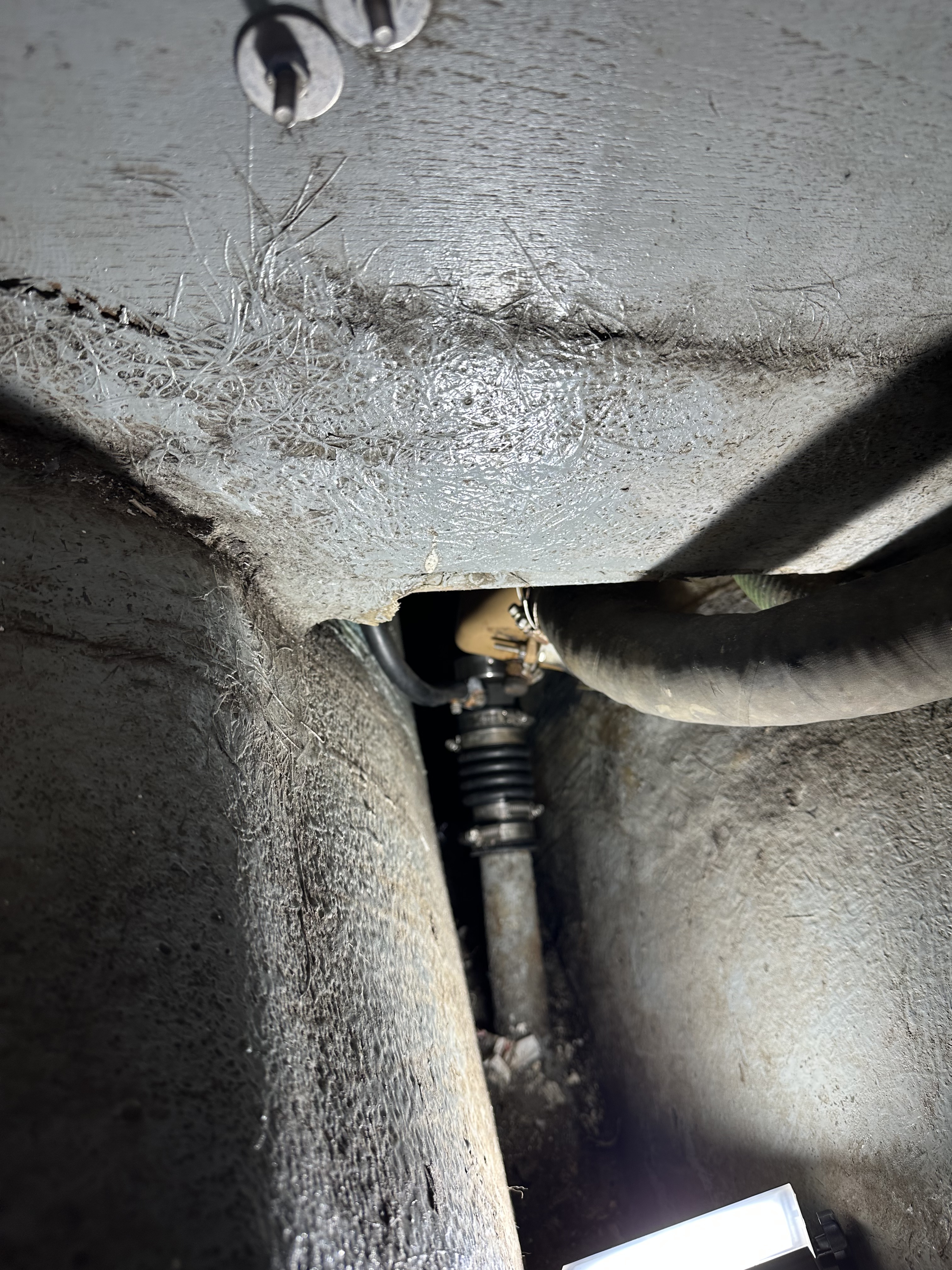

Tangentially related question: I need to hunt down my prop strut bolts -can you point me to the right place? I am suspecting under the quarter berth behind the gas tank?
[/quote]
They are located under fuel tank on my boat about 18 inches fwd of the aft end of the tank. I can just get my fingertips on them if I push my arm in there as far as it will squeeze.
I have an endoscope with which I can visually inspect the bolts, however the tank must be moved to do any mechanical/sealing work on them. I wold have to pull the tank on my boat.

Thanks for the tip on the prop strut bolt location. My immediate concern is inspecting to see if the strut is grounded properly, so maybe an endoscope is all I need -unless I have to do some work in there.
