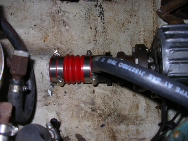

Thanks so much for the pictures and other info. I spoke to Warren River Boatworks and after discussing all alternatives I ordered the Tides Marine seal along with a new shaft and coupling. I will let you know how it all turns out!
JSchneider
Where did you attach the water hose? Before or after the motor impeller? Also, did you put an anti siphon valve, or put a loop in the hose?
Thanks again,
JSchneider
F30
The mechanic removed the spigot and plumbed in to raw water drain from heat exchanger. No added anti siphon valve or loop.

Lola: I just looked at the picture you added of the Tides Marine seal in Seaknots. I do not see any water hose attached to the seal. This is very important since it is the way the seal gets lubricated. Could that be the problem with the seal failing after one year? I spoke at length with the people at Warren River Boatworks and they have been using these seals for the last eight years without any failures (at least that’s what they said!)
Jorge
Weeble 1987 F30
