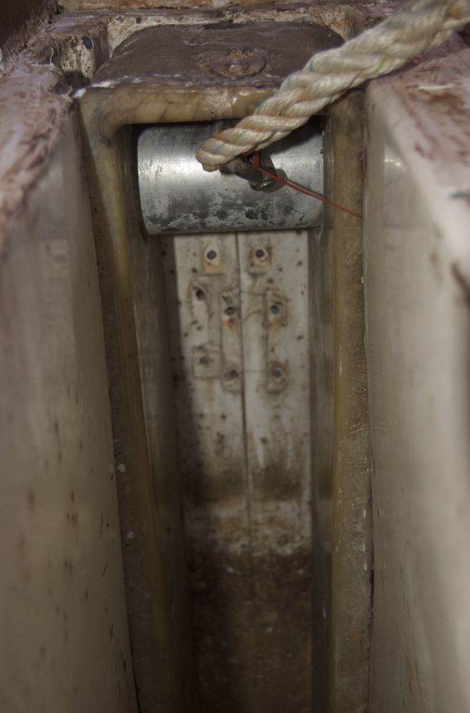

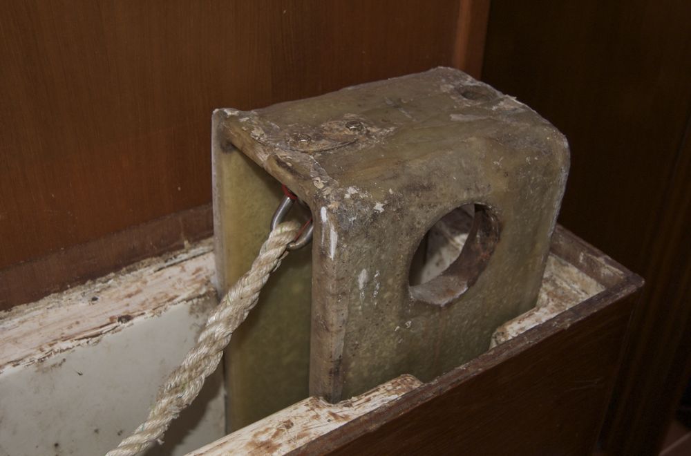

A few pictures of the centreboard in various stages of (partial) removal. I was replacing the bearing and pivot pin at the front. Unfortunately, a month after doing this, I hit a rock in Finland, and the board had to come out again, at great expense. However, I have no pictures of this. The damage was spectacular: the glass fibre casing was split along the entire leading edge, but the lead didn’t fall out. I wrote some notes to guide the repairer, which I think will have to follow in a second reply.

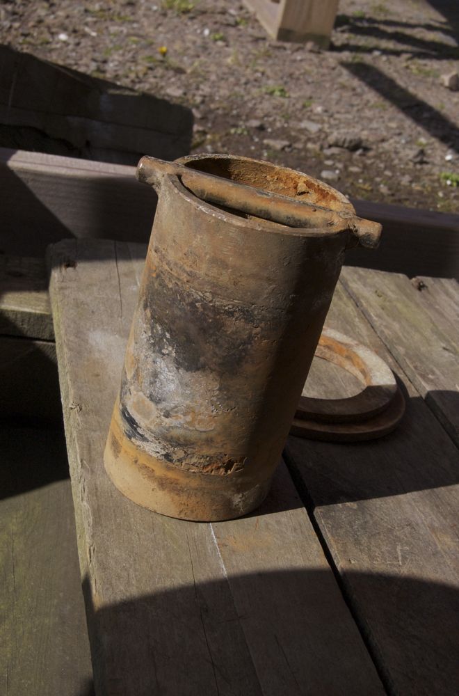

I hope this is the instruction sheet I wrote for the repairer, and another picture, of the lower pivot pin.
