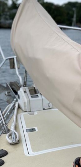

Thanks for the reply, below is a picture from the side where you can see the windlass and also one looking toward the bow.
If you could snap a few photos it would be very helpful. On the 99’ is there an additional cleat to tie off the line and relieve the pressure on the windlass? I have the two bow cleats but many windlass setups have a dedicated cleat.

We have a small footprint Lewmar. Horizontal feed, guts of electronics in chain locker. As another has mentioned, humidity in there a problem. Our original rusted. Have some long thin bolts that secure the windlass to deck. They can catch chain or rode. Process therefore requires constant '‘hands on’ feeding or sorting.
