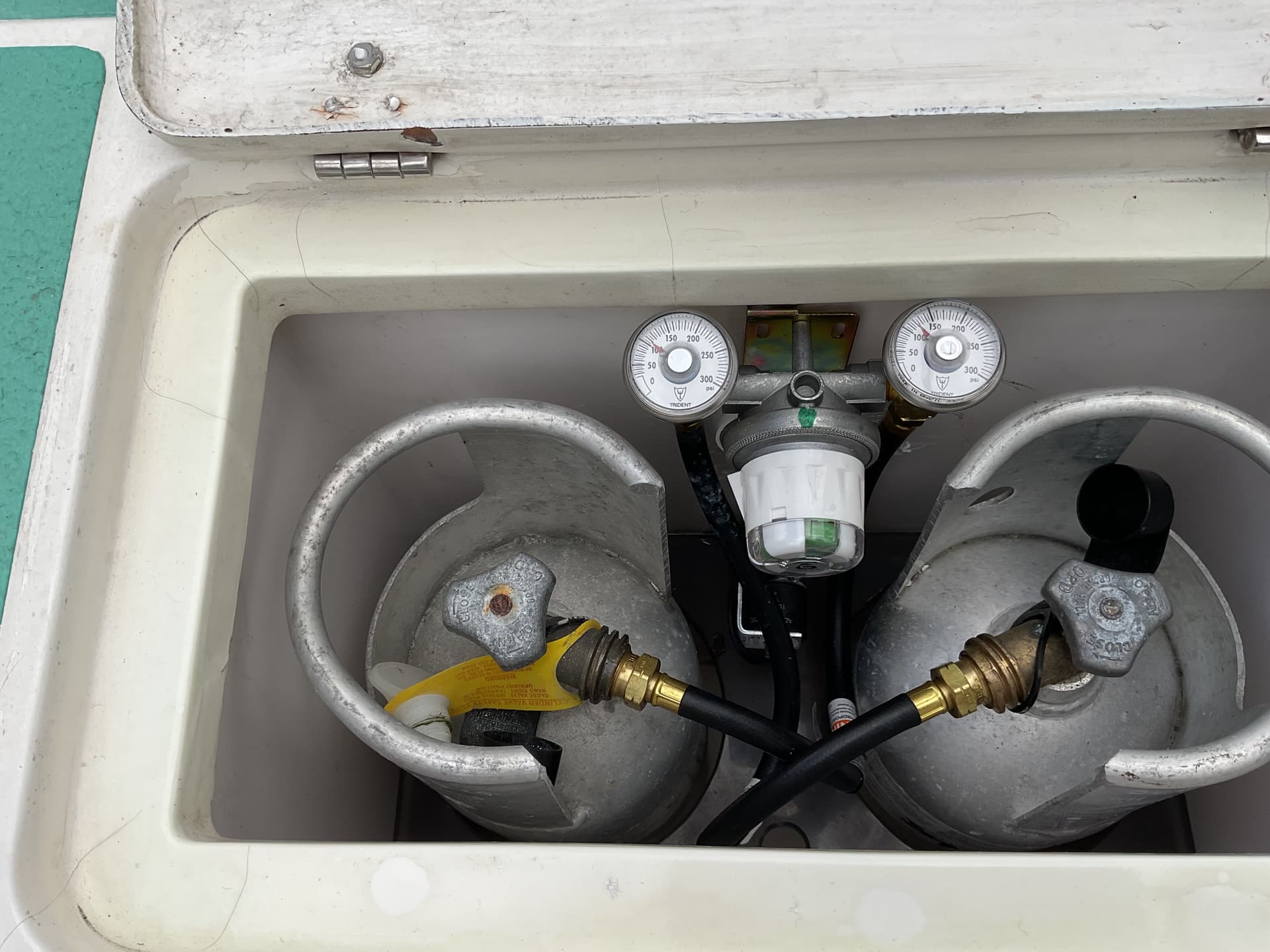

In case you still are looking, this was my recent replacement…
Nice. That allows you to switch bottles without having to move the hose from bottle to bottle, correct?
Would you mind posting the part number for the valve/solenoid?
Hello Mike - peppery on the bay today practicing asymmetrical gybes for the DDR. Hey I see on Amazon that same solenoid- but with 2 included hoses and different connectors the his original #2 below. I don’t see his nifty #1 housing…… I’ll check mine out and may order this if it can work here - mine is original…. Mine is the second pic
This link should get you there. Yes, it can be switched to either tank, or if both valves are open it will automatically switch over when one tank is empty.

I’ve approached my propane differently than most! You’ll freak. I leave my valve open nearly always and rely on the solenoid! My locker as seen is vented overboard- the bottom was covered with dirt, which I cleaned out. Taking out a tank took 2-3 minutes with a wrench. (All of those bolt holes seen will be filled in) This new system with the dual regulator will (should) make things a lot easier. Waiting for connector parts. My kit came with a 90 degree gas line to solenoid 3/8” x 3/8” - I needed a 3/8” to 1/4” ( didn’t know that until I started to remove the old. Then there is no room in the locker to install the regulator unit by spinning it on so I need a couple of 3/8” MPT to 3/8” FPT to wrench it all together - make sense? …and does anyone know if I can use a union coupler to join the regulator with the solenoid ( I don’t have space to turn the whole unit to fit the parts together)
Got back from the Port of the Queen of the Angels and today installed the new propane system. Surprisingly no leaks and all works. I used a coupler union which it didn’t have before. Specs on the union should be good for the psi involved Install was pretty straightforward- I spun the solenoid onto the hose, had pre installed the union coupler, drilled two bolt holes for the regulator bracket. (Shoved the bolts home and taped a wrench to each head to hold it while I went into the lazarette to put on washers, lock washers and nuts). Used a gas leak solution on joints.
I got a little wonky with using the union coupler so I removed it. I had just enough room to twist on the regulator to the solenoid and all good. Unit sits about an inch lower now without the union. No leaks and works. Didn’t want to mislead anyone with that coupler …
