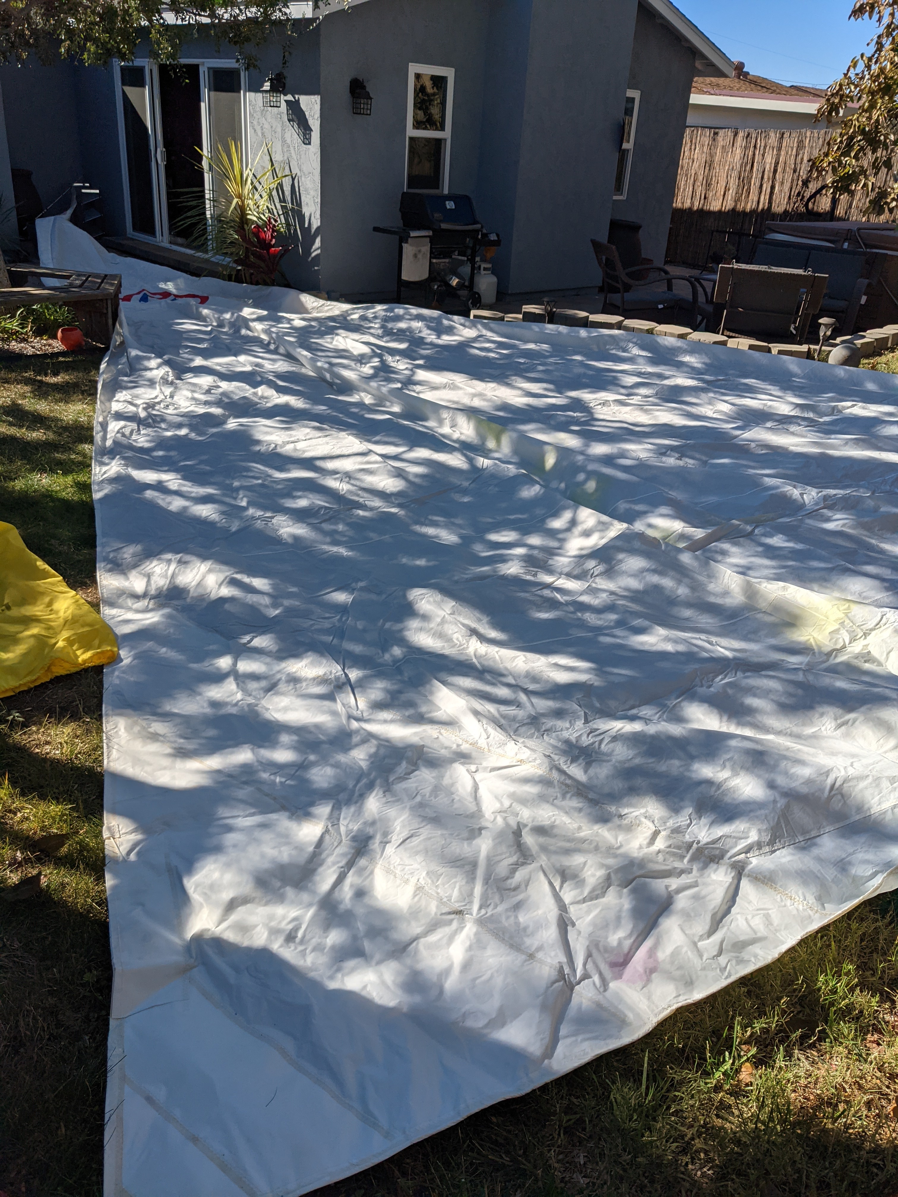

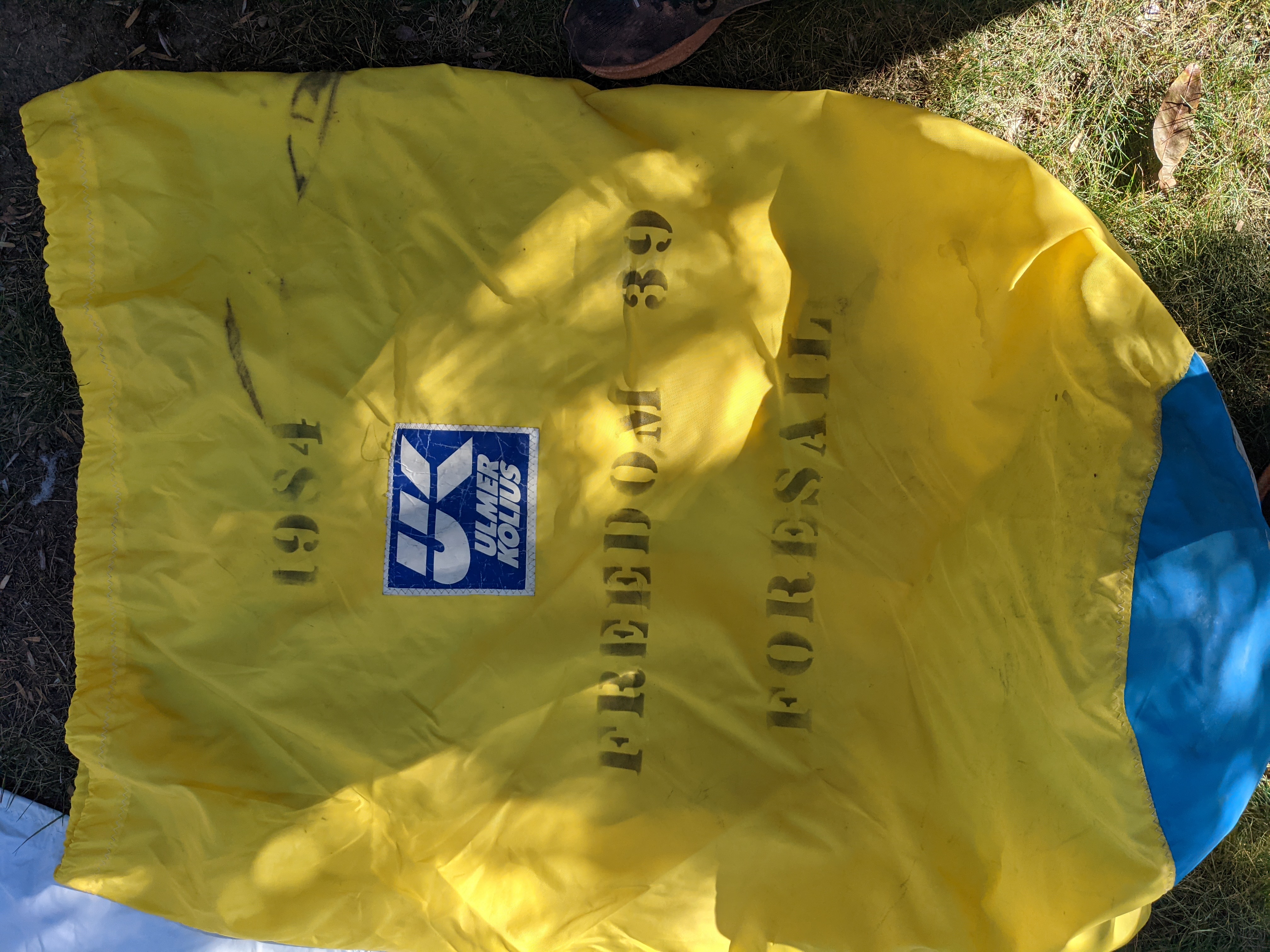

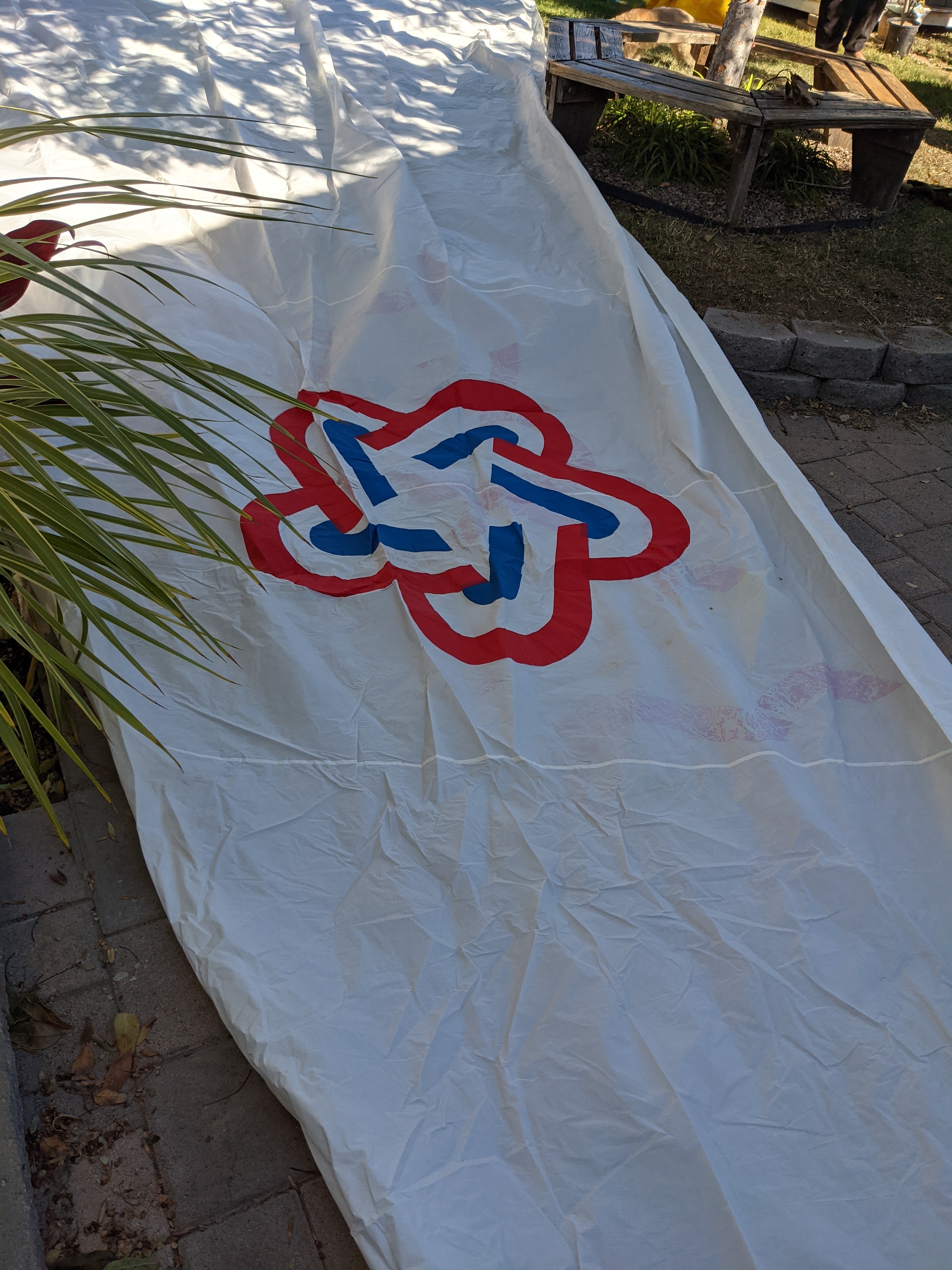

Living in San Diego, my back yard is simply not big enough to photograph the sail fully said out, but I have attached photos of the Staysail and the Head Sail that were included with “Heart of Gold”. I will try to run them down to the park and re-shoot the photos and confirm all measurements.
Luff on both sails is 48’
Staysail
Foot of sail is 13.5’
Foresail
Foot of the sail is 24’
