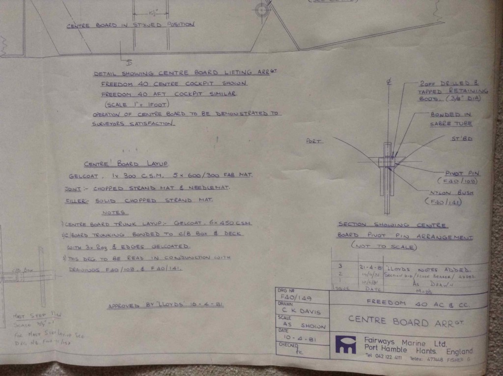

She was built in the UK, in early 1980s but I have found no Hull ID Number; she was a bare hull that my father bought when Freedom were selling up in the UK (or possibly going into receivership) and my Dad then fitted her out inside completely. He was an accomplished craftsman and engineer (everything he did was done with large safety tolerances).

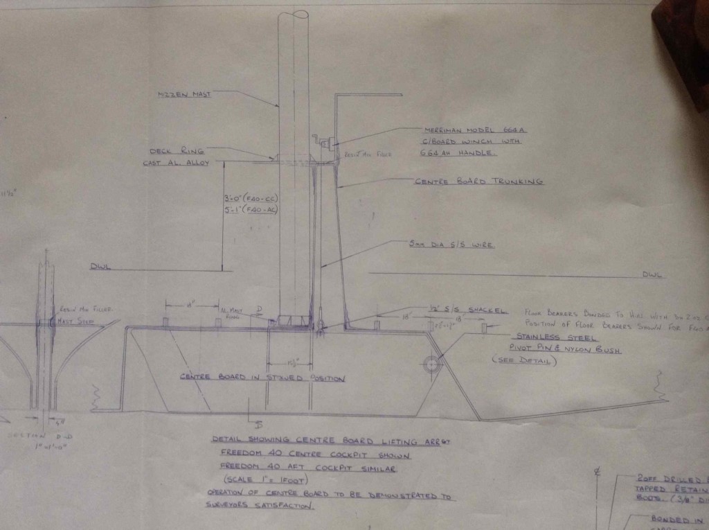

I have just found (photos of) some design drawings that feature the bit relating to the F40 centreboard. From what I can see/read the centreboard core is actually solid fibreglass mat (but Im not sure I believe I’m reading it right!). The drawings name Fairways Marine in Hamble - I don’t know if they actually built the hull or not.
I’ve no idea if my dad ever replaced the lifting cable, but I don’t remember us every having a problem with it. I think it does shackle to a block & pulley arrangement with rope that connects to the centreboard itself - unlike in the drawings, where the cable connects directly to c/b. (I say “I think” because the boat is currently 250miles away from where I live, and I can’t quite remember / didn’t make good enough notes or photos!)

I think some of the English Boats were built without centerboard and have a deeper keelsom with, I presume, more lead. It may be that the center board was an option… It wouldn’t surprise me if it were made of fiberglass per the drawing. Certainly the arrangement of the winch and single wire suggest that. If you have more drawings that also address the ballast on the boat it might clue you in as to the centerboard weight.

I would have liked to have drawings of the F35 centreboard of the quality in your pictures! Perhaps it’s worth putting those in the section marked “Photos and Drawings”, since they seem to accord with Erik’s description and pictures. Other owners would find them fascinating.
