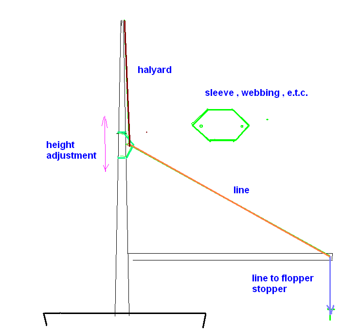

Marty, here is just a slight extension to Rick’s idea.
You may try some sort of sleeve wrapped around the mast connected to the rope going to the end of the boom. The sleeve is secured with halyard at the height of your choice . (idea is similar to main sheet traveler with control lines). This way you do not load mast tip excessively, you can adjust the height of the sleeve choosing thicker section of the mast while spreading the load around the mast with the sleeve and avoiding extra local load on lazy jack’s connection point to the mast (in my case it is wire going around the mast and thru just one eye strap with two rivets ),
also crutch takes extra storage room while not in use .
That’s a pretty cool idea. I think I visualize it, but what is your sleeve actually made of?
I like the idea of it being adjustable; main halyards pulls it up, a downhaul pulls it down.
I’m thinking it wouldn’t actually have to be a sleeve. Maybe some super strong wide nylon webbing straps with some sort of backing to hold this “bridle” in shape so you could slip the webbing up and down the mast. Do you have any snapshots of this rig all set up?
Thanks!
no,I do not have actual solution ( I am on east coast too, just read your post ). It is just an idea based on Rick’s and prev. posts. By sleeve I meant some webbing sling or patch of tough material wrapped around mast and connected to halyard and some extension rope via shackles. Something like " ATN tacker" http://www.westmarine.com/buy/atn--tacker--P002_063_002_505
Sleeve allows to spread load evenly around the mast while unloading top of the mast.
Halyard supports it at some height and rope holds the boom at right angle.
Sleeve is similar to the spinnacker sleeve
Maybe even add some rubber “snubber” into the line going to flopper / stopper. mooring “snubber” is going to adsorb shock load even more.

Hey’! Thanks for taking the time to post the sketch. That is pretty much exactly what I envisioned, I think some strong 2" wide webbing on the sleeve thing would work great. Very similar to that West Marine “tacker”…only a LOT cheaper! :wink:
