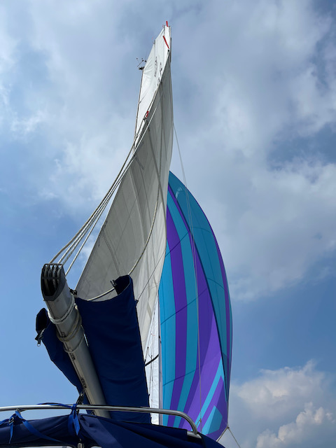

I have found that Feronia doesn’t like to carry the kite once on the beam. She will but prefers to be broader fo the beam than on it. What I have done is to get a cruising version of a code zero made for me by Kemp Sails. I can use this up to 12 knots apparent and she will happily sail up to 50 degrees to the wind. I use the Hoyt pole as a bowsprit pushing it out and tying off at the mast to keep it in place (sitting on a flat fender to protect the deck.
I have added a picture of kite and the zero.

Hi Peter,
it was a very light wind when I had Rockin on a beam reach using the spinnaker and we came up onto it probably due to boat speed approaching or even exceeding the forward component of the wind, i.e boat speed brought the apparent wind onto the beam.
I do like the idea of using the gunmount pole as a bowsprit, although for my mostly day sailing, I’m not sure I want (or can afford) another sail. It would cost almost as much as I paid for the boat ![]()
