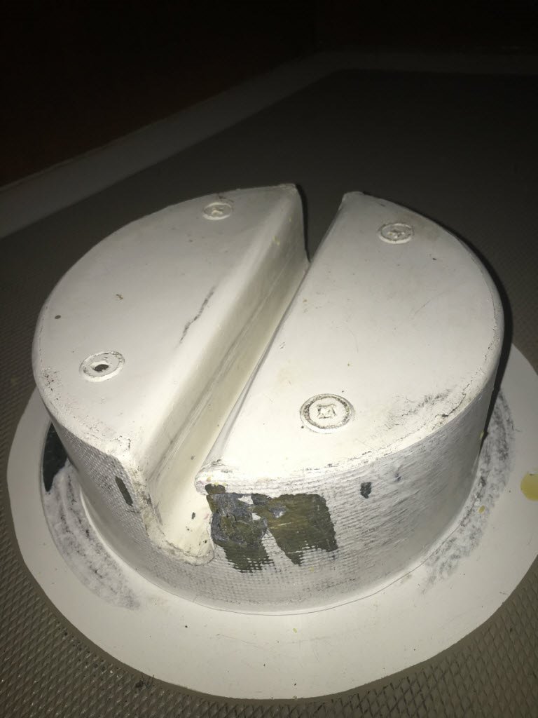

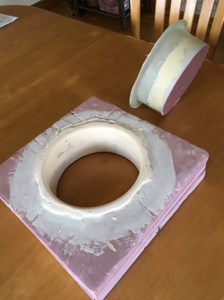

I’m not familiar with the F-21, so not sure this applies, but I did repair this on my Mull 28. After doing some light repairs to the mast step (the “top hat” shown below" I covered it with packing tape and mold release wax to make a female mold. I then used the female mold to make a male mold, both shown below. Next I used the male mold, which is now essentially a replicate of the top hat, as a template to build up the interior of the mast with 3" strips of fiberglass cloth until I got the fit I wanted. In my case the gap between the top hat and the mast was almost a full 3/16", so there was a lot of build-up needed. The mold let me get a snug fit without worries that the yard would have problems installing the mast.
The creaking and banging, especially at anchor in nasty weather and when going downwind in swells, was anxiety-producing even if it’s not a structural concern. Combined with the separate project of rebuilding the mast collar at the deck, all of the problems went away and it has made a world of difference in the liveability of the boat.
