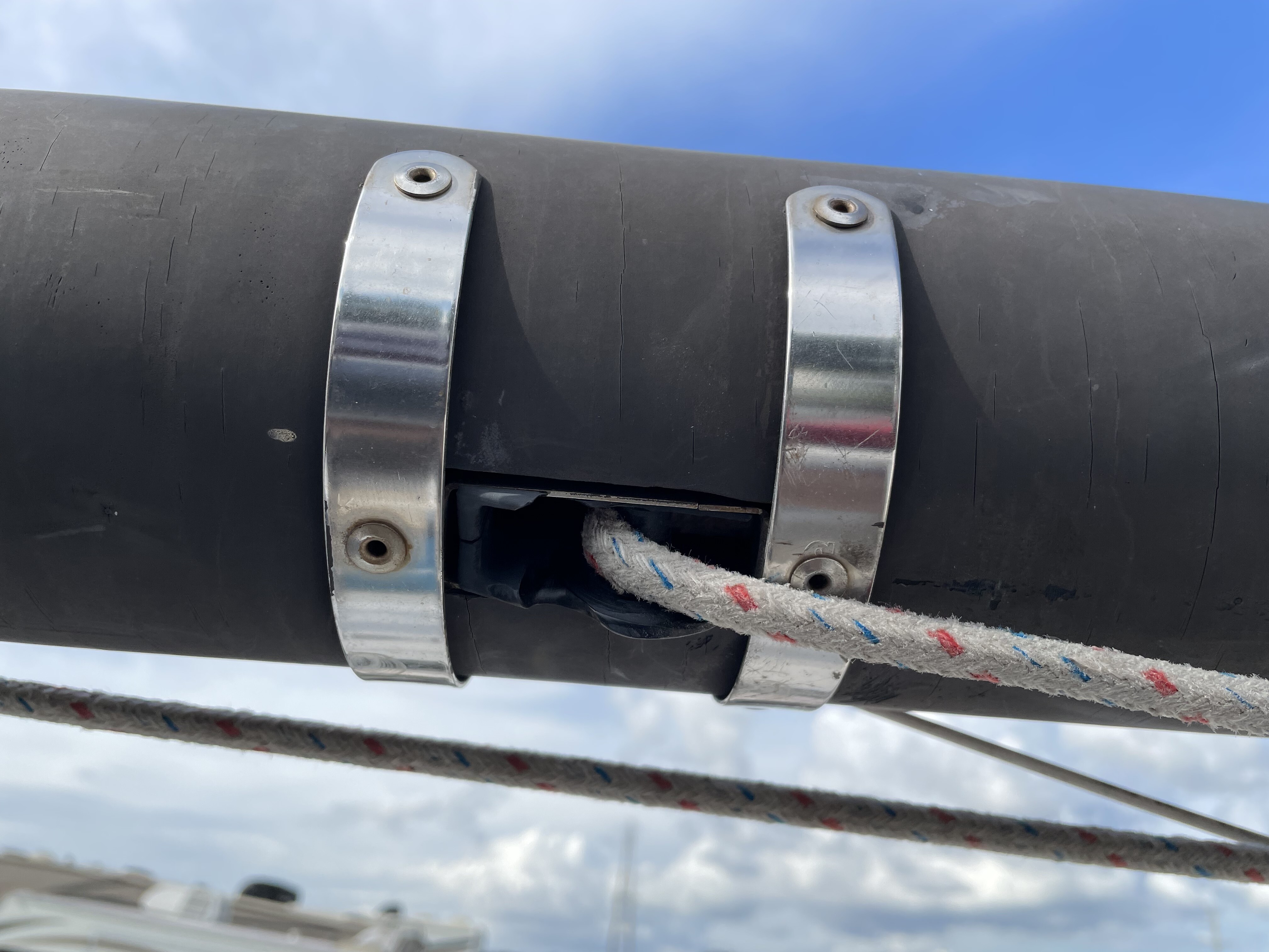

I need to replace my jib halyard exit block. The block that fits into the mast for the 8mm jib halyard line. Does anyone know where to find a new one?

Ya, I only have one fore halyard so it may have been for the spinnaker. My boat is a 1987 vintage. Looks like some kind of plastic pulley and a stainless steel housing. I checked harken and schaefer but couldn’t find anything. You don’t know which manufacturer may have fabricated this block?

Yes that is the spinnaker block and its exactly the same as the one I have. It is an unusual fitting, exit blocks usually have attachments either above and below or to the sides on flanges that sit against the mast but ours is recessed on that pair stainless straps.
What exactly is the problem with the block? It might be possible to just replace the sheave if you remove it.
I would be interested to see more if you do decide to remove the block to investigate further. It may be a standard block with a custom strap fixing to recess the block.

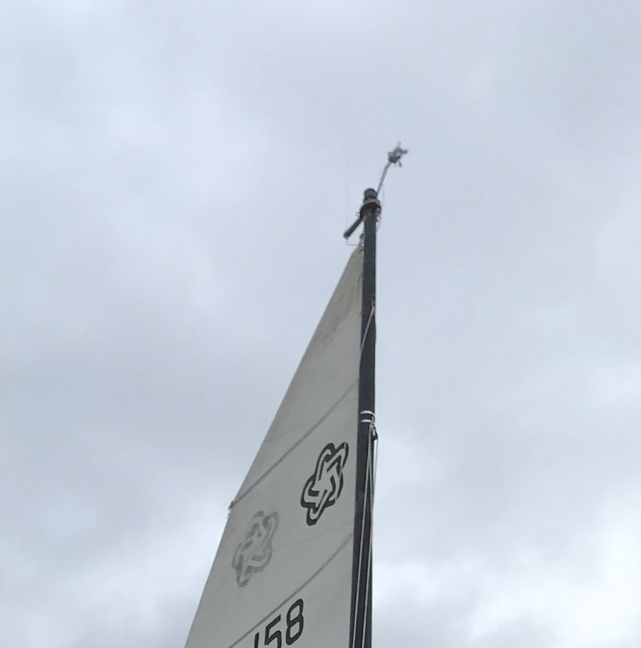

I attach a pic of mine, you can see the job block mounted just below the spinnaker block, externally. Sorry for the poor quality its a blow up of the whole boat.

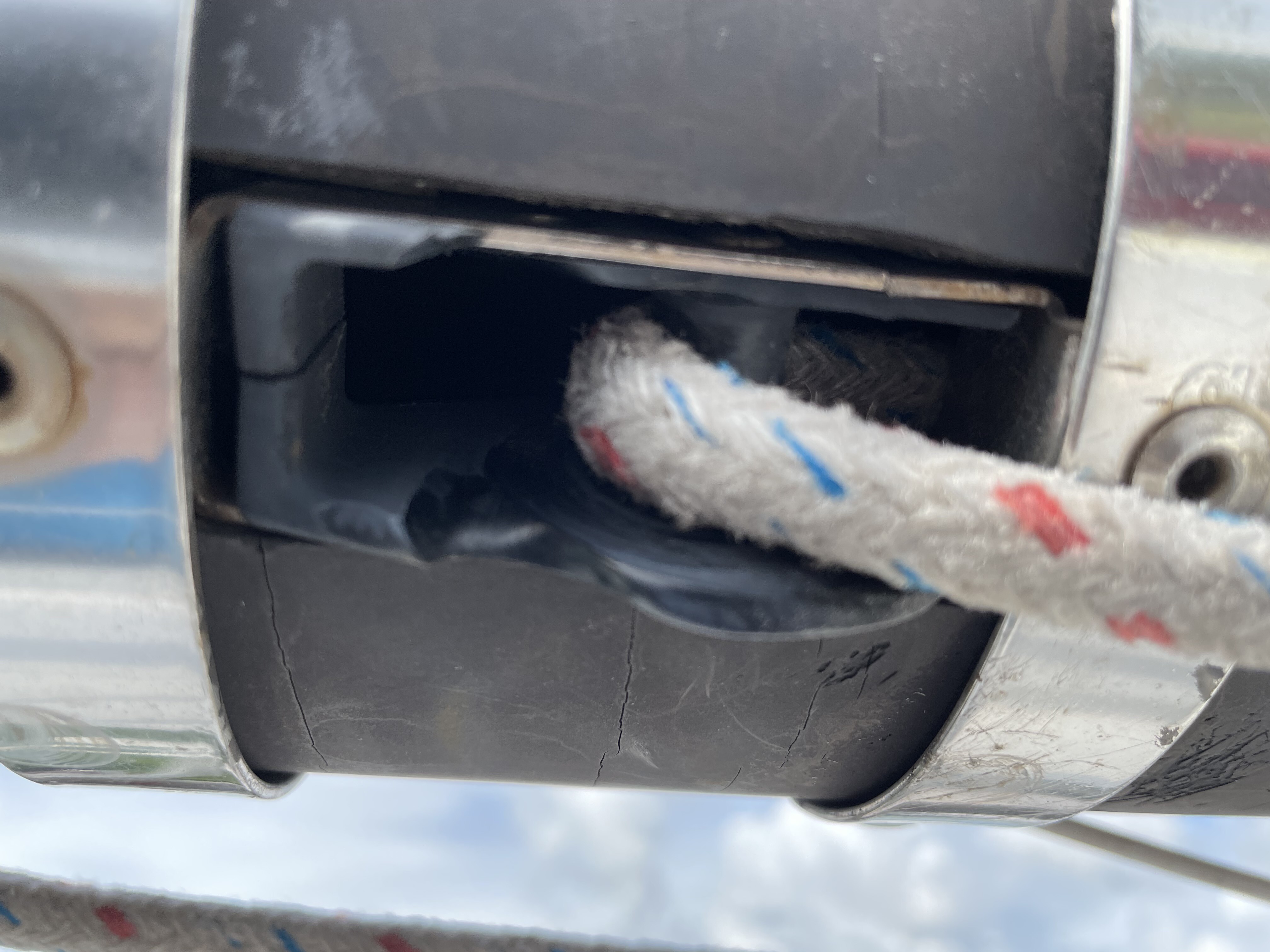

The sheave is missing. I believe the rest of the block is intact. Here’s a closeup of it. I’ll send you another pic when I take it off. Thanks for your ideas.
It’s a harken through deck block. Double check the size, but if my notes are correct it should be this,
https://www.harken.com/en/shop/small-boat-classic-292/38-mm-through-deck-big-bullet-block/
you don’t use the black plastic trim piece. You need to drill out the rivets on the stainless steel strap so you can move them out of the way to take out the block You’ll need these rivets.
https://www.amazon.com/RV6602-6-8-B-Bayfast-BayTite-Blind-250-500/dp/B07ZRPYBFK
It’s a pretty easy job to do. I replaced mine about 10 years ago.

Sorry to revive an ancient thread, but can anyone confirm that this is definitely the Harken big bullet block and not the regular bullet block? I need to do the same repair and frustratingly forgot to measure the dimensions when I had the mast down (that’s what I get for hurrying…).
Also, do the rivets on the block itself go all the way into the mast or do they just go through that steel strap?
I’m thinking about upgrading to a Harken 1202 40mm Protexit block. Much more expensive but more than 2x the breaking load feels worth it.
