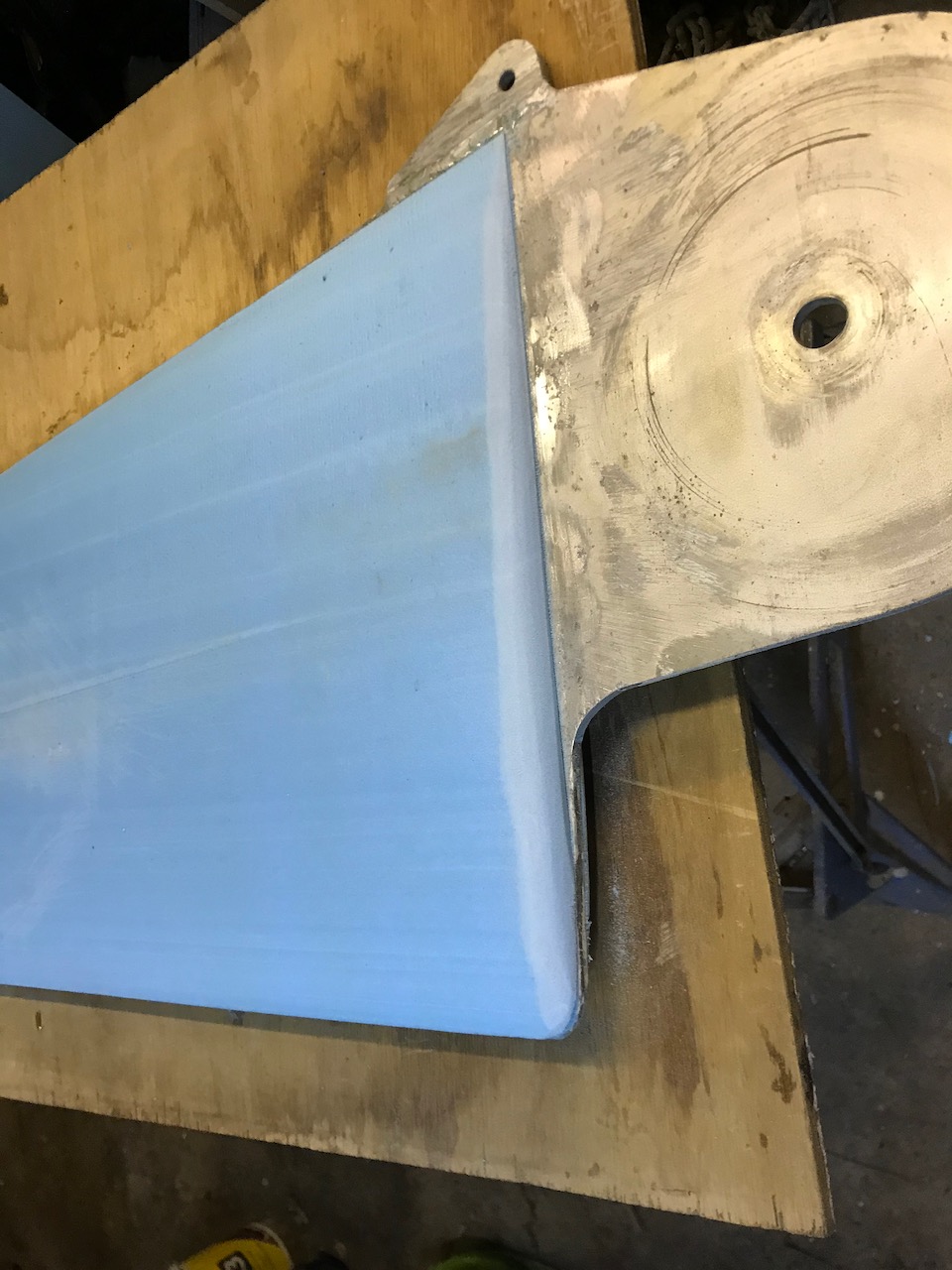

We may have had a bit of a tide against us to start with but no more than 1/2knt, but on the bigger waves… bang and we were almost stopped. I think next time I will try it with fuller sail (more power), even though we had a good breeze. I tend not to reef until 16-18 knts and do not have any trouble with weather helm until then. Do you have a flat plate rudder? I had the same problem when I first bought Rockin but added a foam cored NACA 0010 profile to it after the first season. It made a big difference.
I do have a flat plate rudder. That sounds like a cool project and I’ve read your posts about it, but unfortunately I think it’s outside the limits of what I can accomplish working out of my apartment. It’s great that you got such a good result though! Weather helm has always been my nemesis on this boat.
