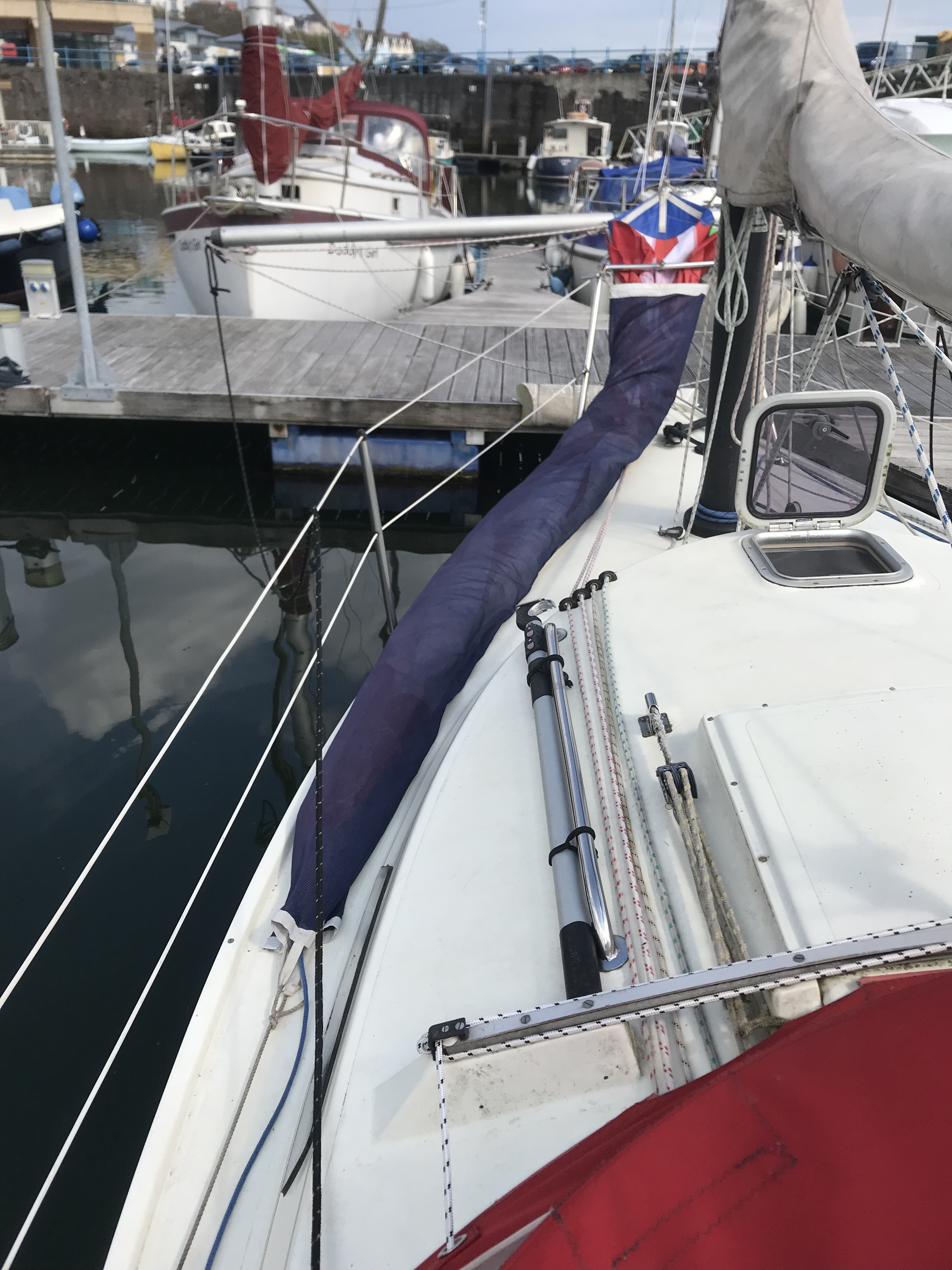

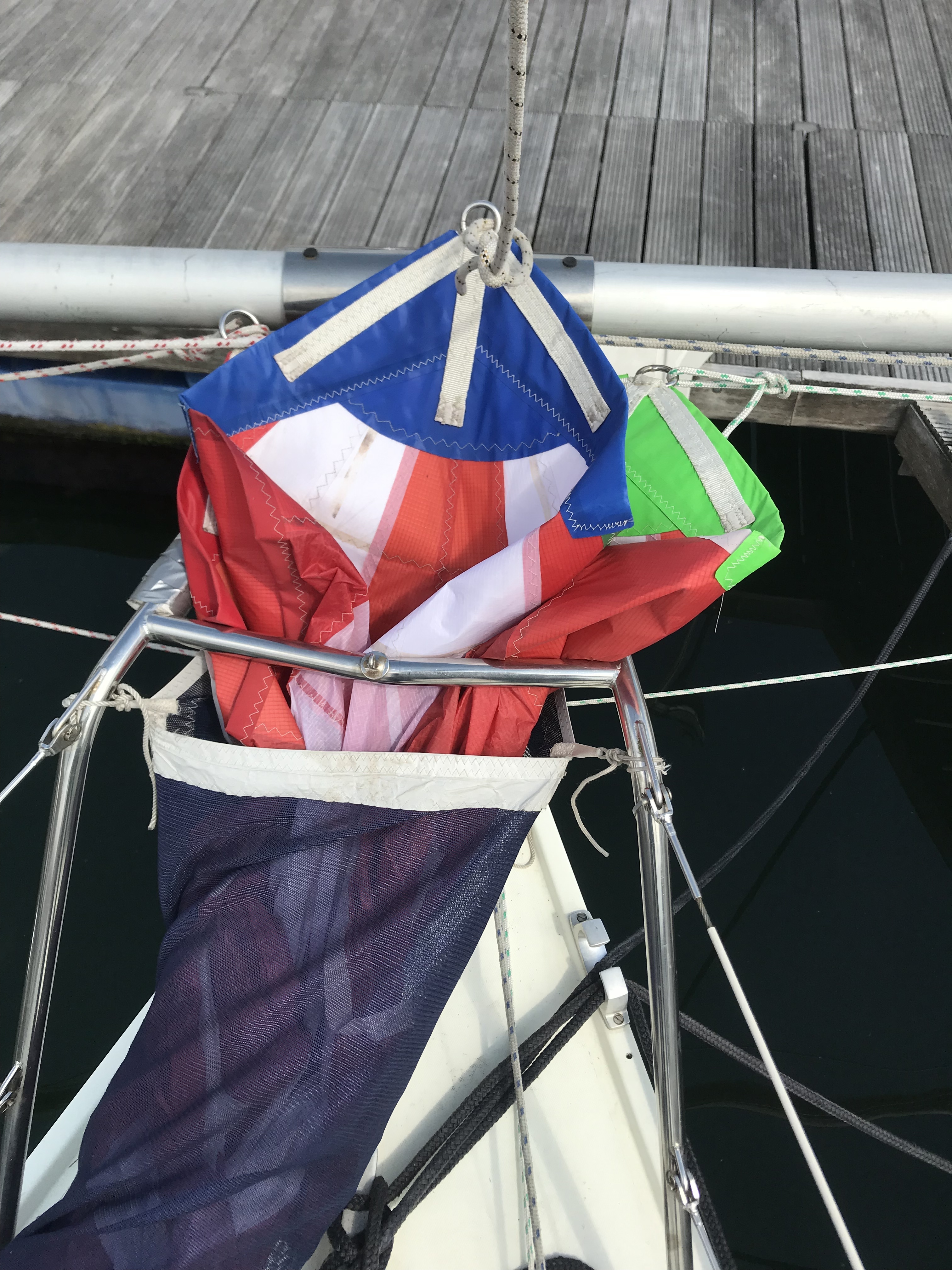

Hi Ian,
the F21 is a great little boat. I’m sure you will enjoy it.

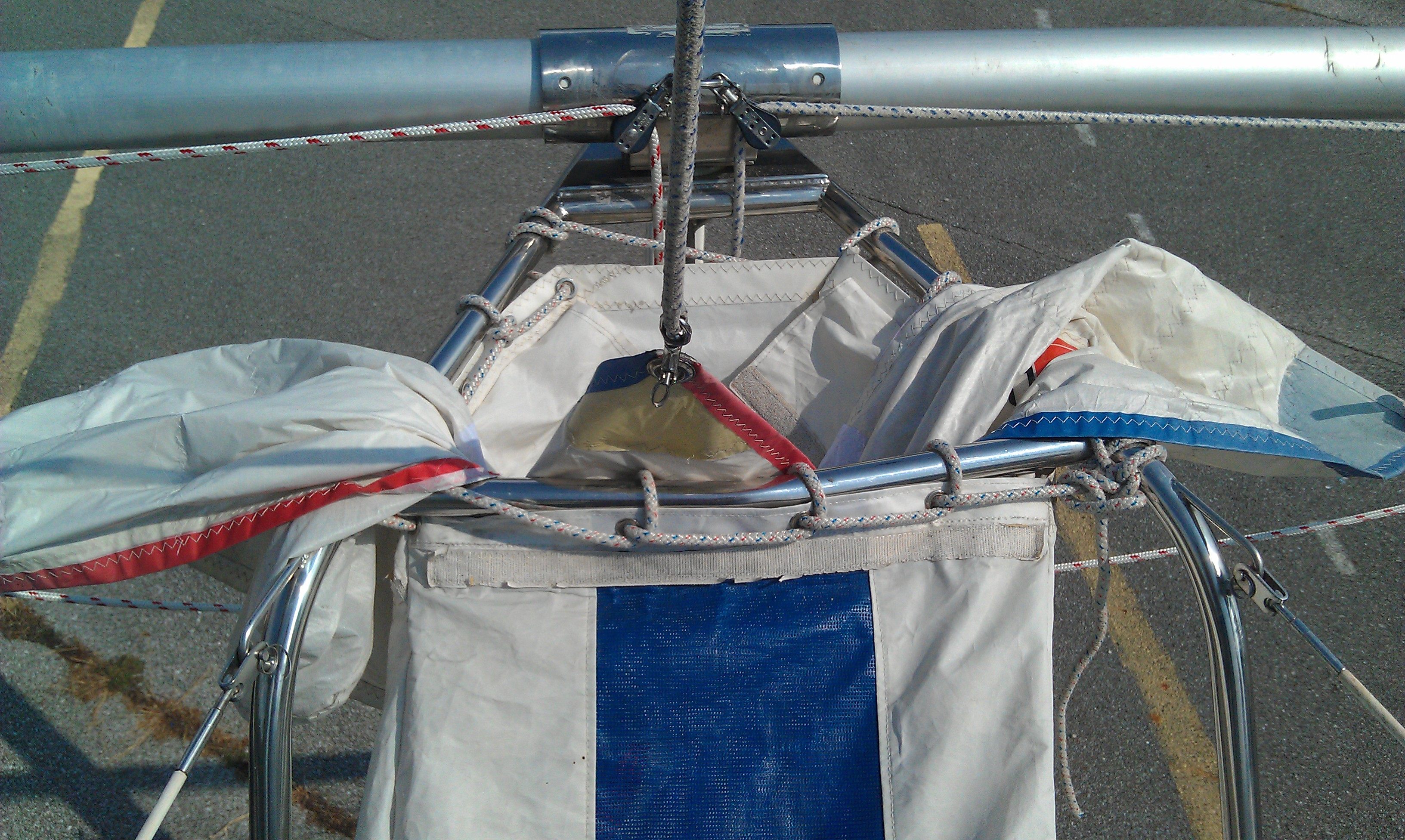

My spinnaker sock is made from a lightweight mesh material using strengthening tape along its length. I can take some pics when I am next at the boat. It attaches to the pullpit using a number of lengths of cord. If I remember 4 corners to the top and two down at the front.
I’m sure any decent sailmaker would know what material to use and be able to make one up.

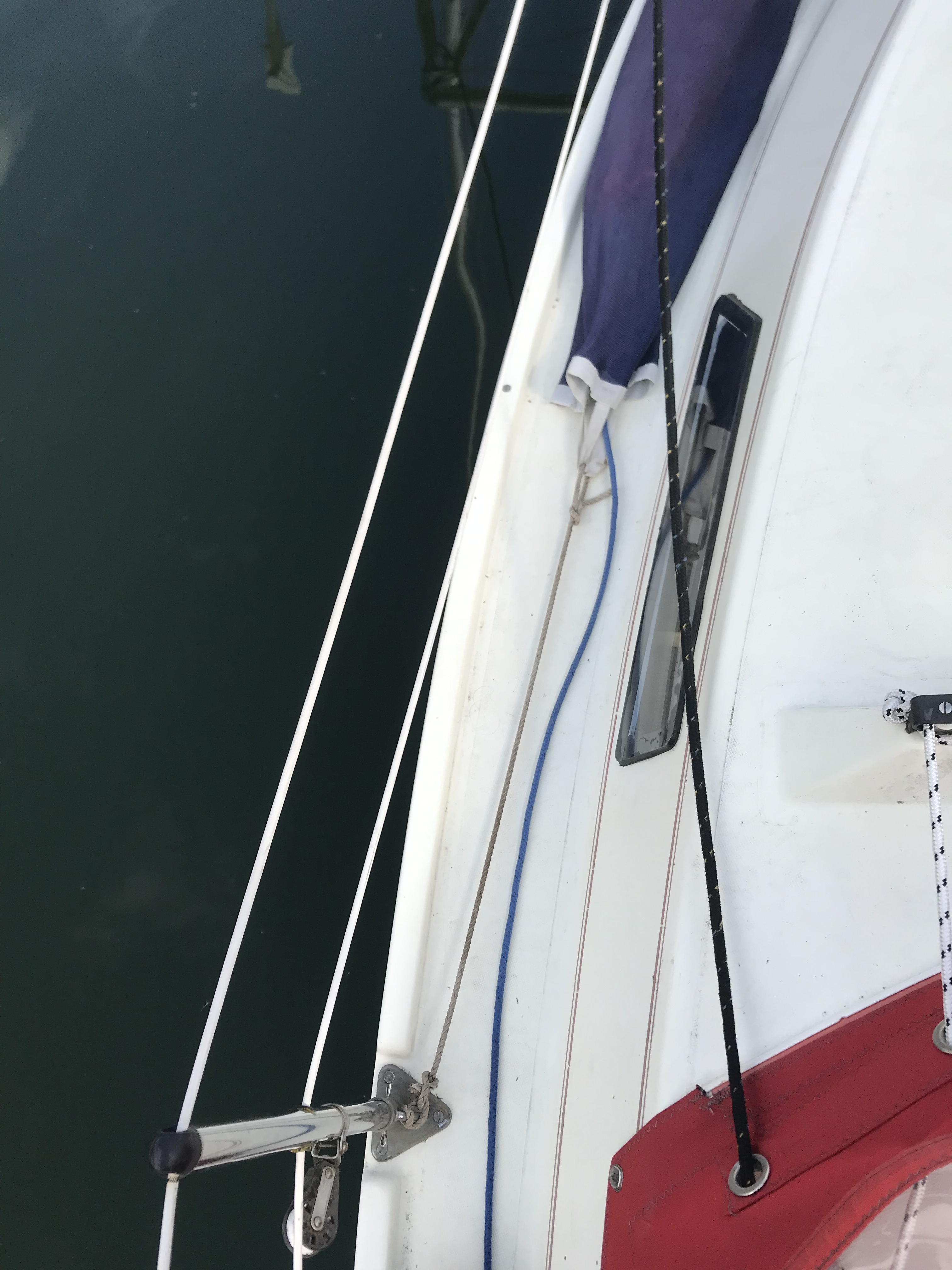

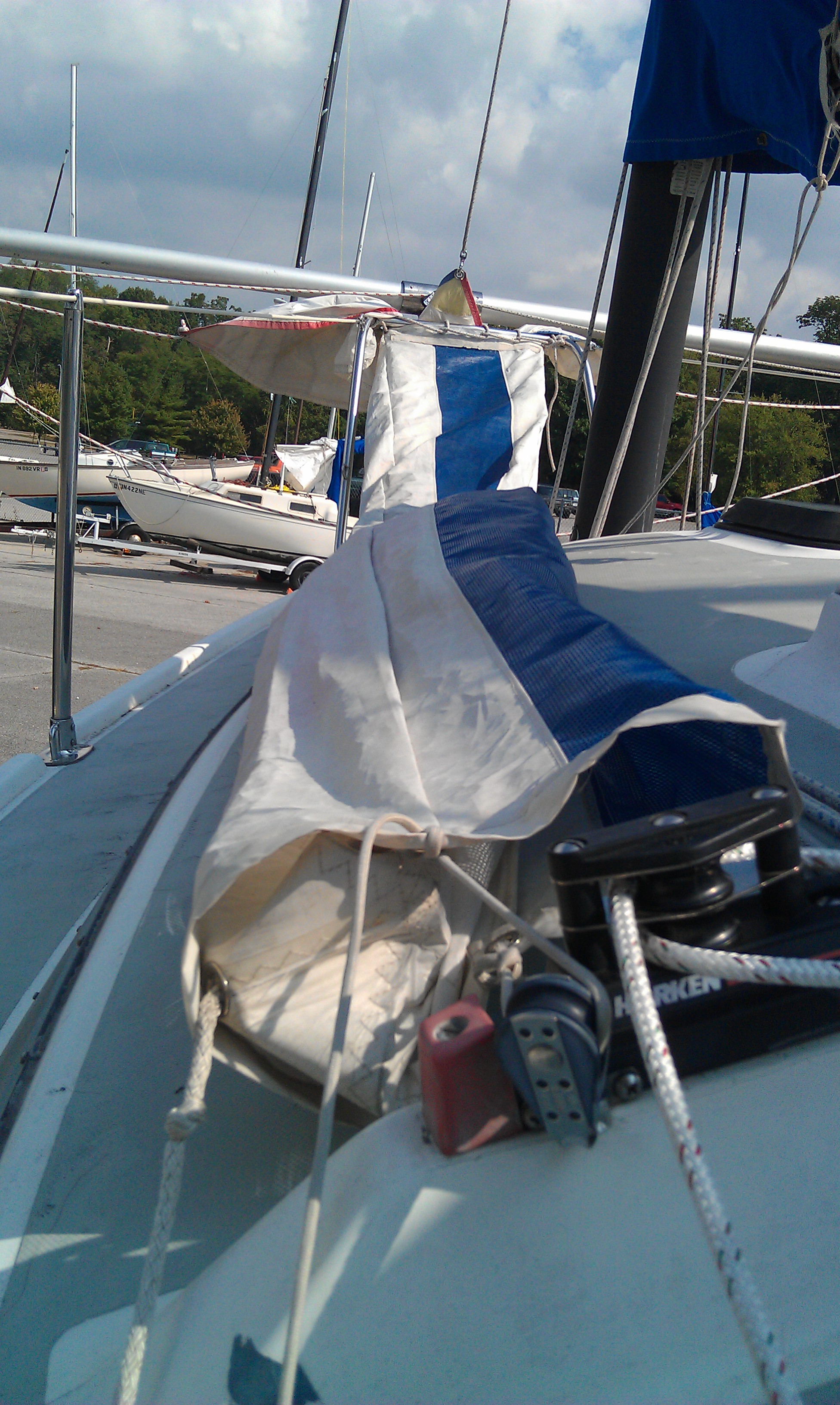

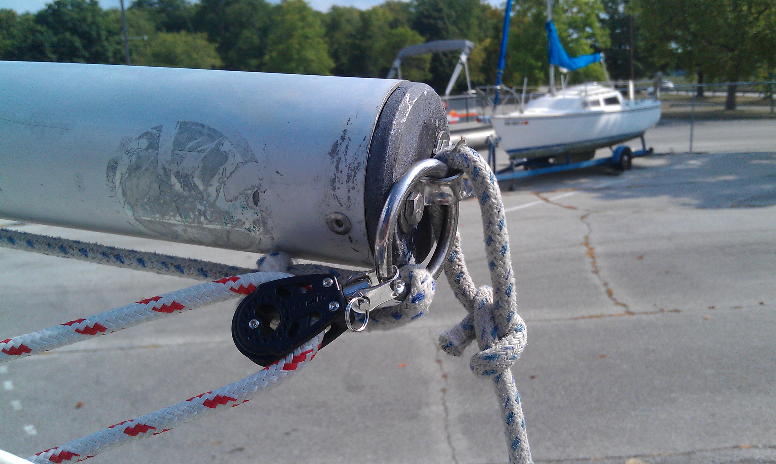

Hi Ian, there is a cord at the tail end that attaches to the base of one of the stanchions. The retrieval line exits here and is tied to the end of the halliard to make them continuous.

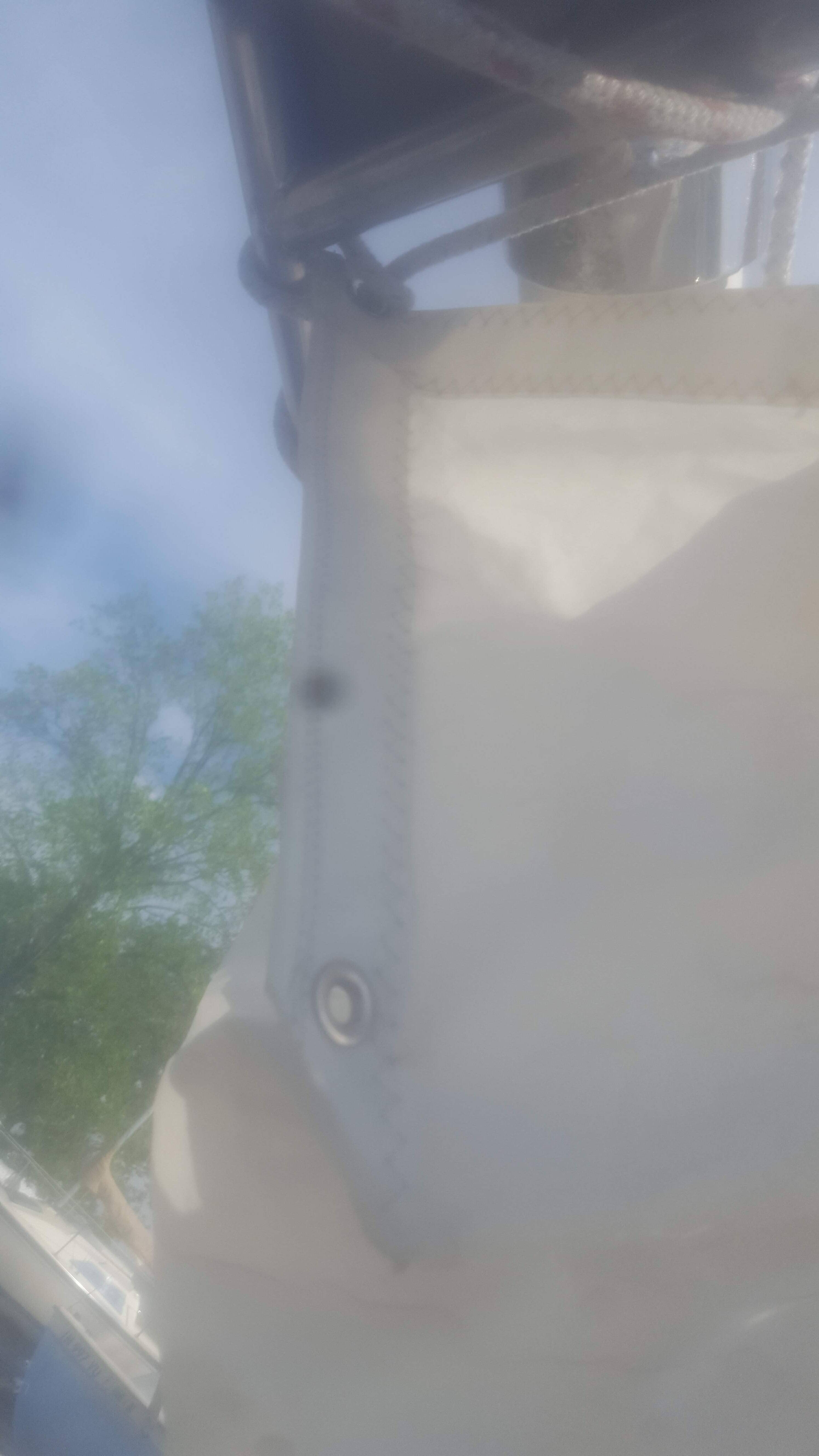

Here are some pictures. Whatever dacron is used is pretty much the same weight as the main. But you could just make it out of sumbrella.

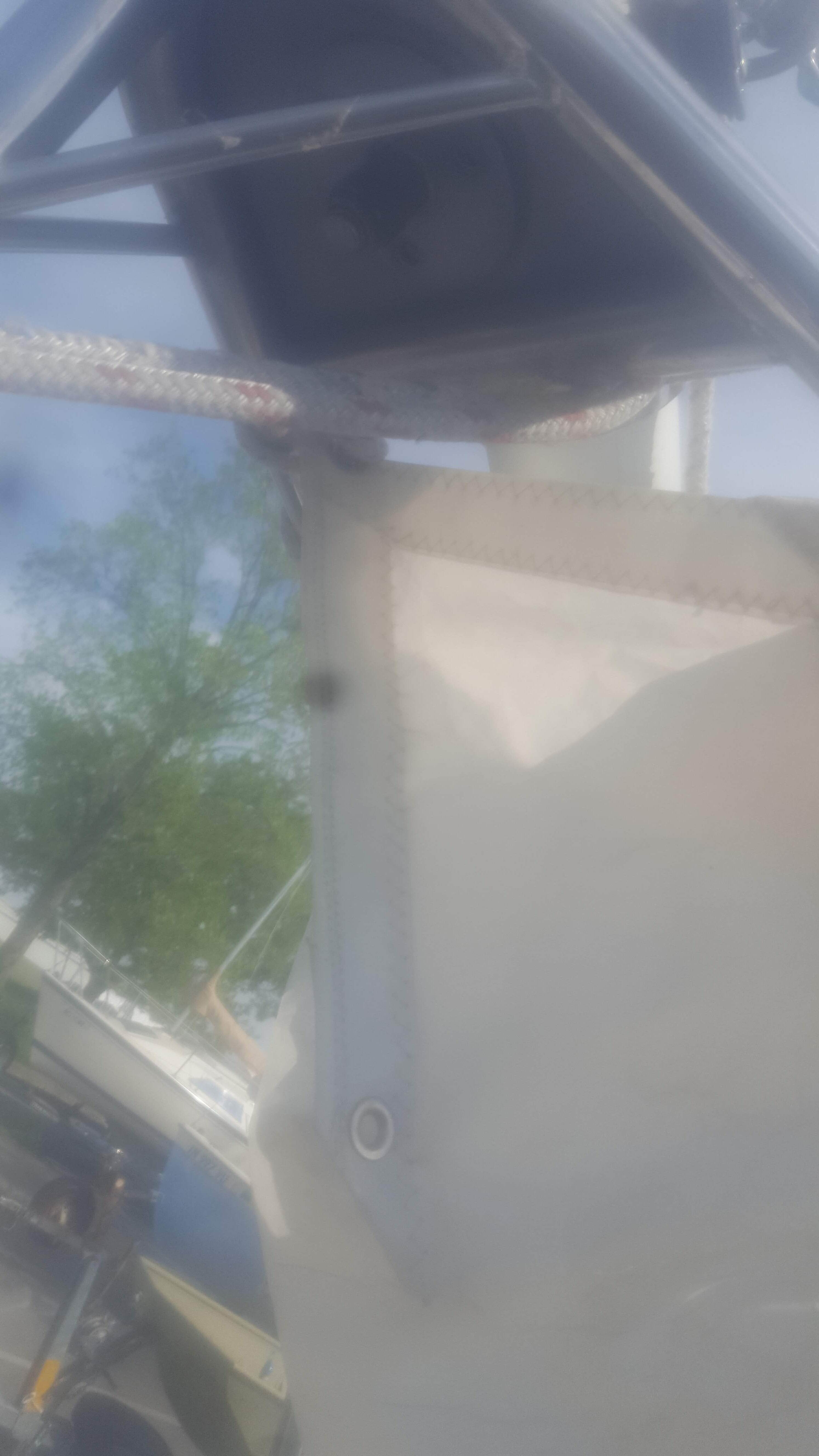

I don’t have a picture of the front but there is also a grommet on the bottom side of it to tie it down to the bottom to keep the hole open. Although I never tie that. you can kind of see it in the brochure pictures and the freedom video on youtube.

Not the best pictures but hopefully it gives you the idea of the bottom portion of it. From the top to the corner of the fold is 12"

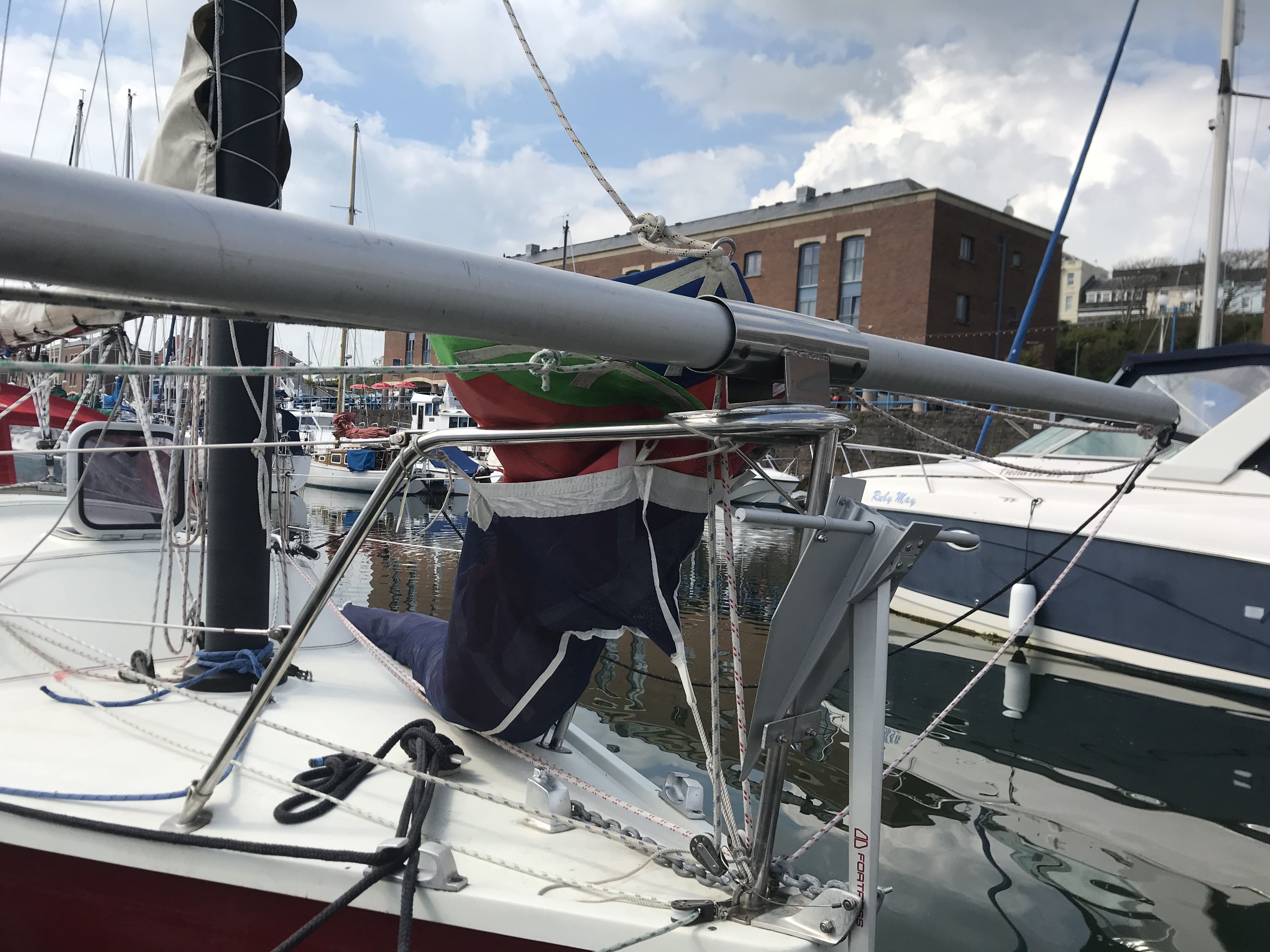

Ian,

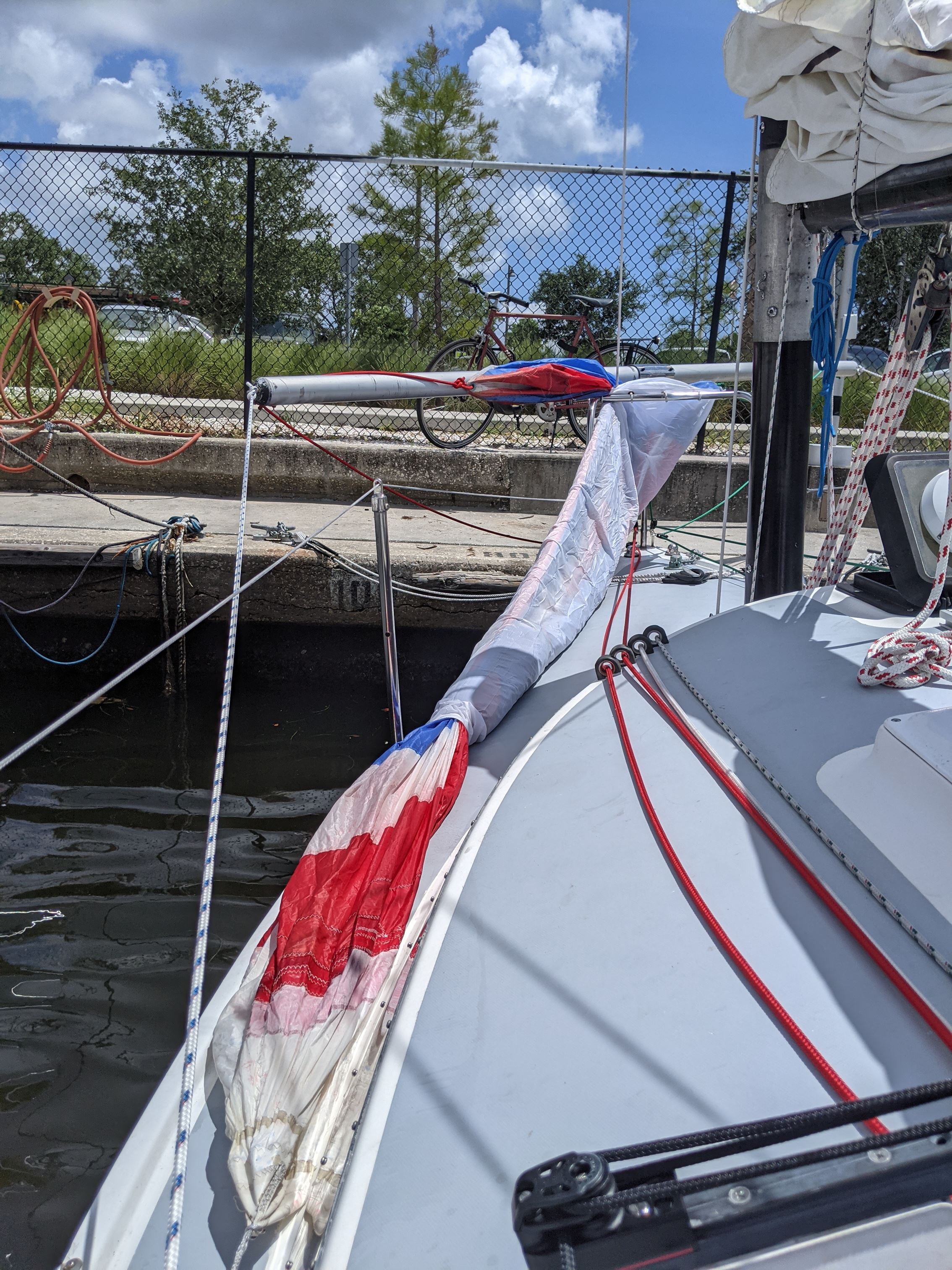

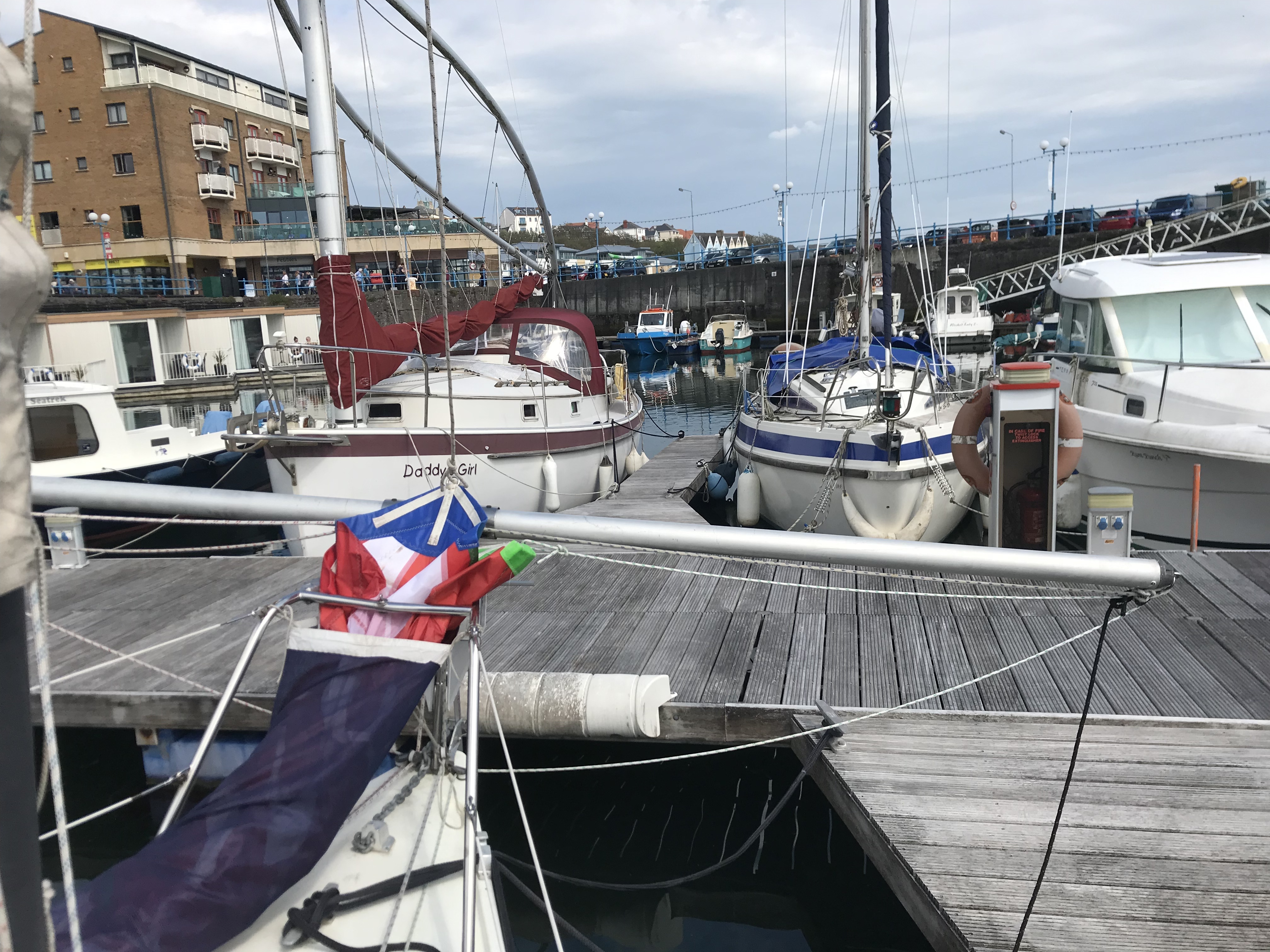

Just got down to the boat today and got the spinnaker ready fora sail tomorrow. I took some pictures, as you can see my spinnaker sock is much lighter than that already posted. It is made of a fine mesh material with taped seams under and around the ends. This allows the spinnaker to drain/dry if you get it wet. I find it works well.
…and the next two.
Thanks! It all makes a lot more sense now that I can see it in action. I’ve decided to sew mine out of lightweight (1.9oz) ripstop nylon (mostly because I’m already familiar with the material) reinforced with 2" poly webbing where the grommets will go. Will update with some photos when I get around to actually doing it.
