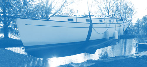

And with regards lifting these - are there any definite no-nos in terms of where it is safe to lift from / place strops etc? Or any specific places that are particularly advised to lift from?

Moy, thanks to Archimedes, we know that displacement = weight. A boat will displace its own weight in water. However, to nominal you will have to add fuel, water, plus anything else not in the boat when originally delivered. Sorry can’t help on stropping your 33/35, except for general issues, like avoid through holes and aim to be close to bulkheads.

The LK is notably stiff and stable as a result and it is all but impossible to dip the lee rail under sail. I’ve no experience of the centreboard boats but slinging them should be simple provided the centreboard is avoided. The lines are well ‘V’-ed giving a strong shape and the GRP is all solid down there, no balsa.

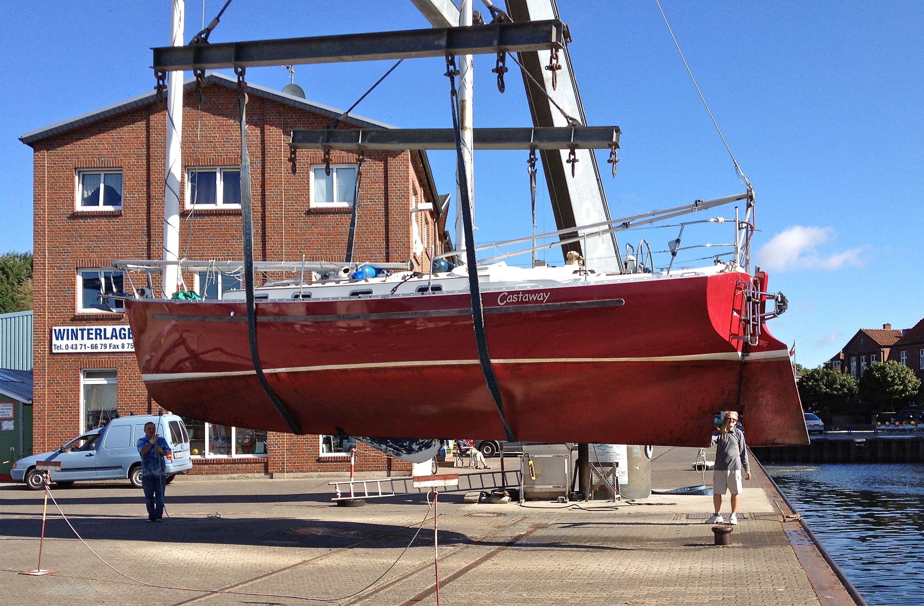

I have a UK built F35 Cat-Ketch with centreboard. It has never been weighed accurately, but crane operators have suggested figures from a bit over five to around seven metric tonnes. The Channel Handicap System rating displacement is recorded as 6,100 kg. I generally ask for crane capacity of at least 8 tonnes, preferably 10.
The volume between the CB case and the saloon sole, for the length of the case, has glassed in lead ballast, and there is said to be about 500kg of lead in the centreboard itself. That figure is very believable when you raise it with a manual winch. The rest of the lead is said to be 2000kg or more, which is a very creditable balance ratio.
The hull is very stiff. When I had it stripped before being epoxied, the underwater hull was almost translucent, and it appeared to be balsa cored to within about 30cm of the keel. The hull is stiff enough that there is no significant flexion where support pads are placed when ashore. I generally place strops aft of the forward hatch, and just aft of the end of the main hatch. Obviously, one would avoid the CB, and not be so far aft as to allow the strop to slip into the cutout for the propeller.
We don’t often have the luxury of a crane, more often a forklift or a submersible lift. We do tend to leave the masts up, but this presents little problem for the crane operator, as all the rigging can be held out of the way.
