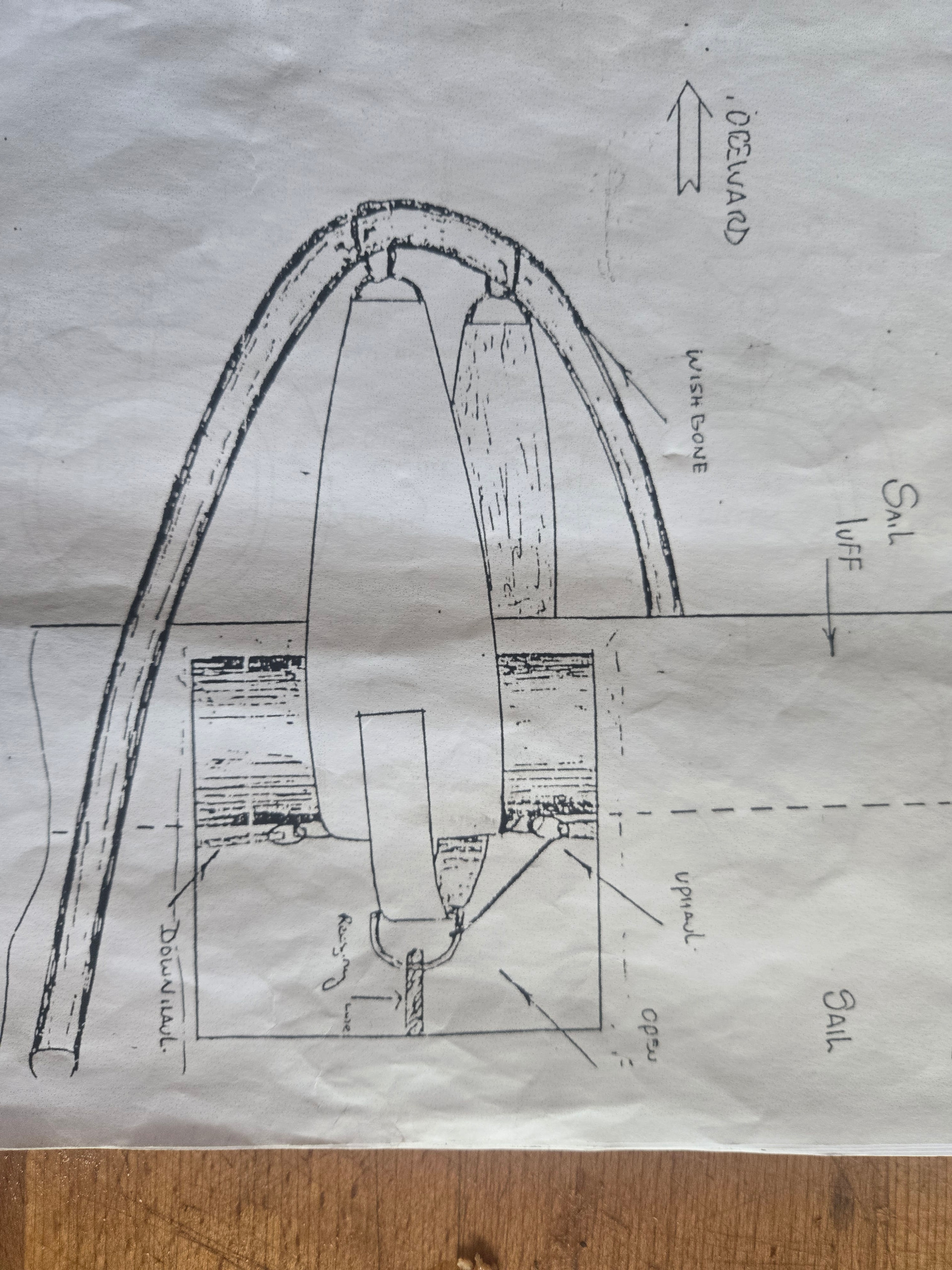

Does anyone have any idea where i might be able to get 2 mast bridles for the freedom 33?
Any pictures of them on your own boat would be really helpful.
Some measurements would be great incase i have to have a pair made.

That is a good diagram, I kept it to add to my owners manual
I made my own straps from 5β x 2β nylon hoisting straps from the industrial supply store. The straps were long enough to wrap around the wishbone before shackling to the fittings in the front of the wishbone.
The length is determined by the need for the main wishbone to clear the mizzen, and also to ensure you can fully tension the sails with the outhaul for stronger wind
I donβt have a sewn loop to attach the uphaul, I just use a spiced eyelet and small smooth shackle to support the weight of the wishbone with sails down.
