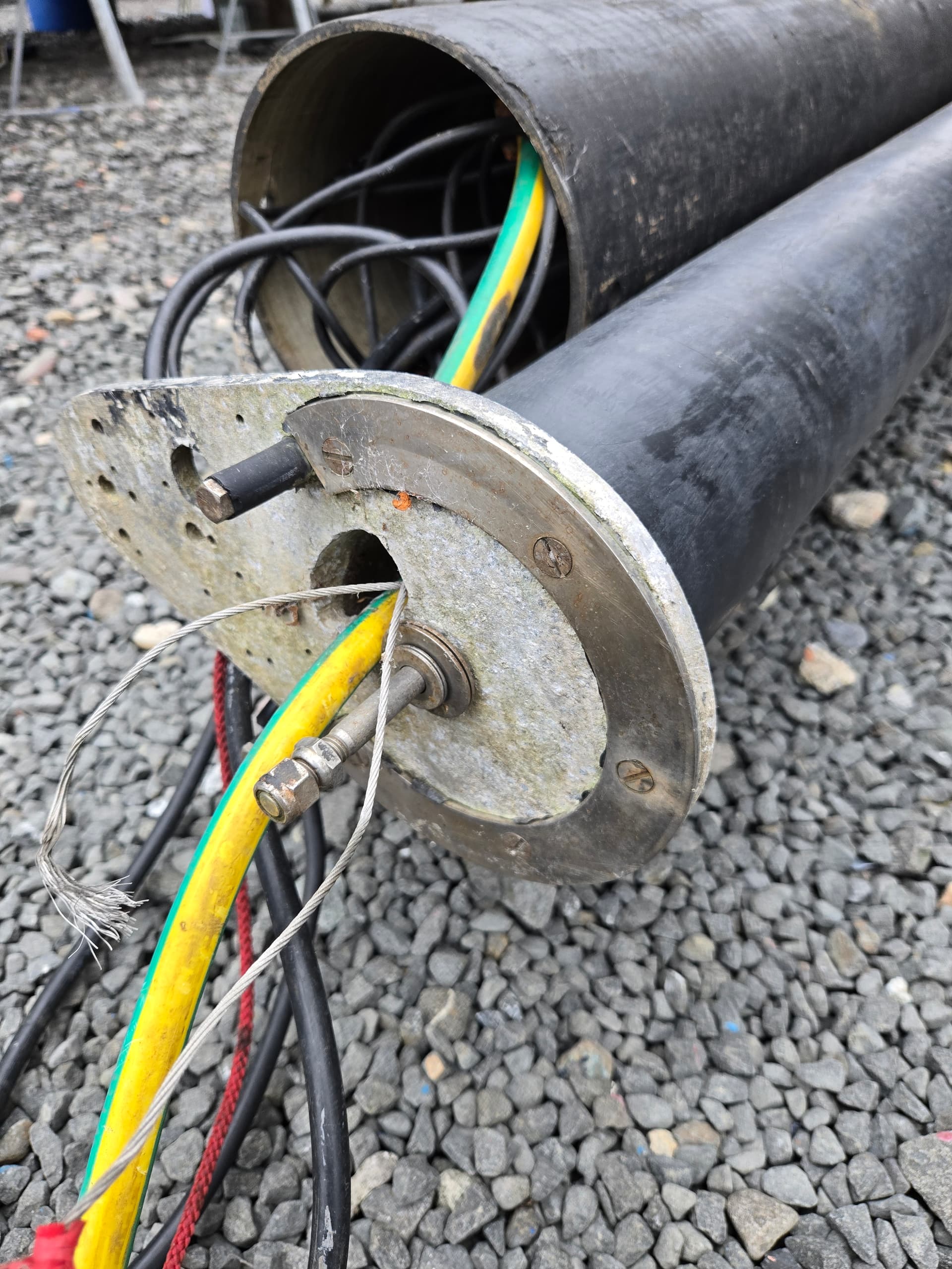

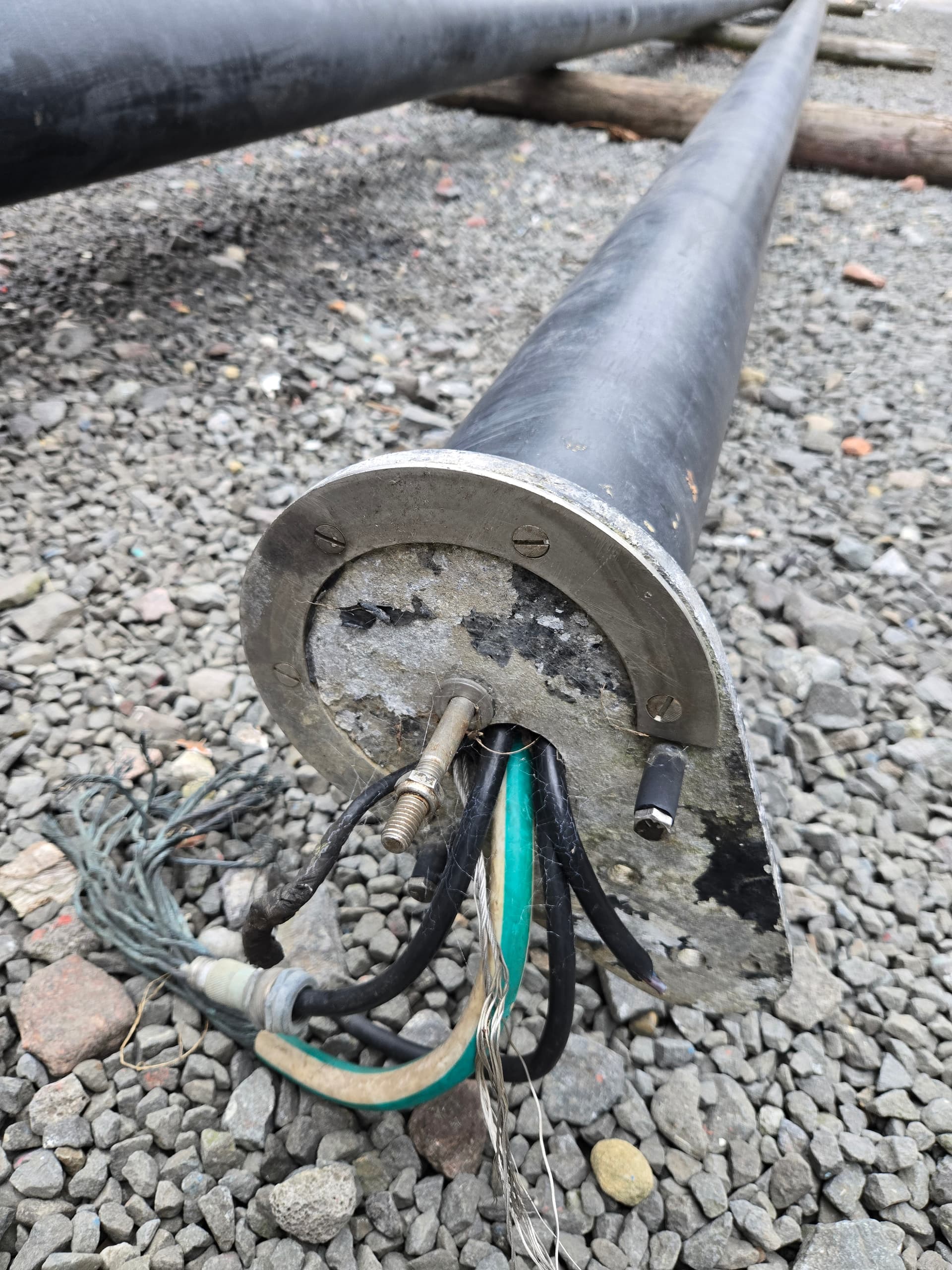

Hi, im looking at my masts. Seem to be missing the halyard swivel bracket . . . . Sorry not sure of the name
I cant find any pictures online, can anyone help me out?

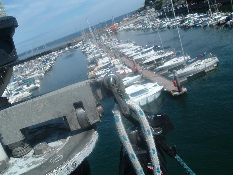

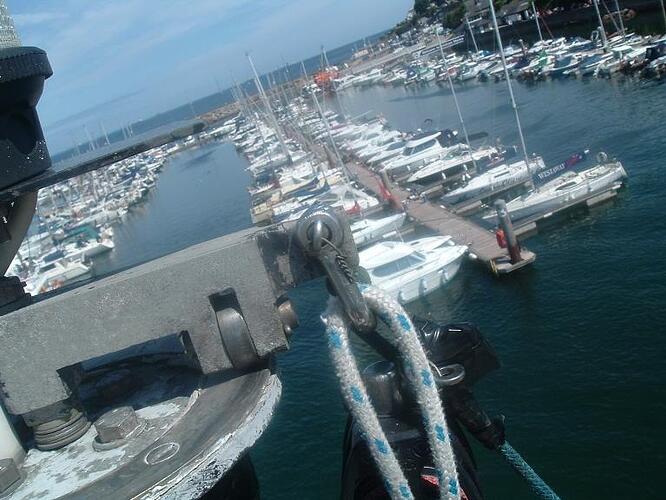

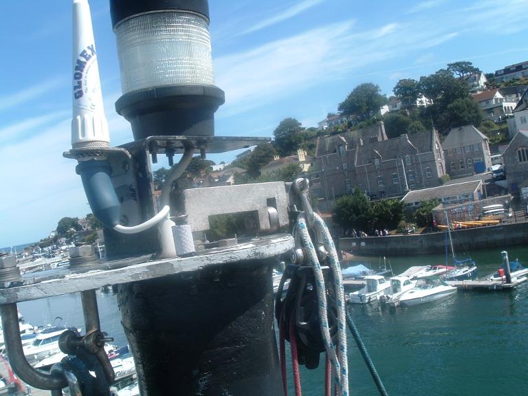

I have these two pictures from a Freedom 40, I think, I was looking at. That’s all I know so not sure that helps at all!

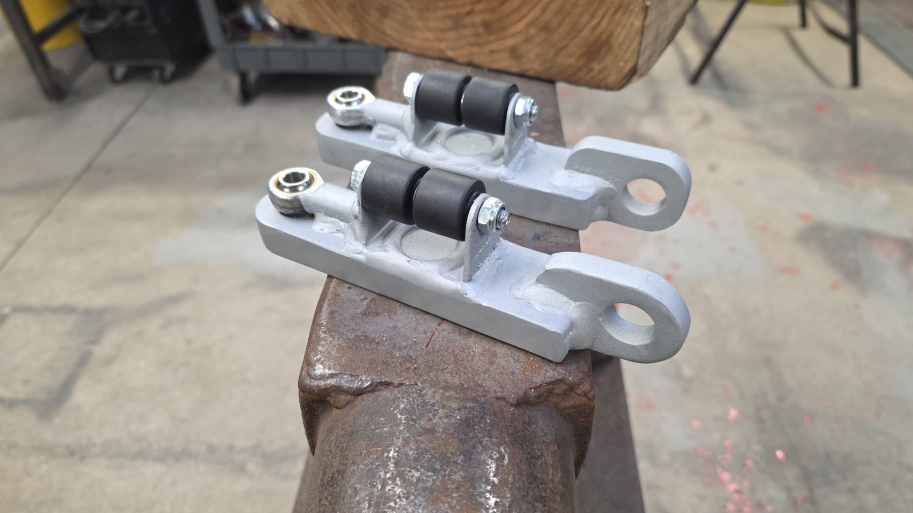

That’s great thanks, it looks like i will need to get something made up so the more pictures the better ![]()
These swivels are peculiar to british-built Freedoms, and in my opinion are over engineered. I have them. They require regular maintenance (the ball bearing and pivot pin) and you need a crane to go up every time. You can get away with the same effect with a swivel shackle on your halyard, or nothing at all. Minimal impact on the twist if your sail.
Look very smart!! ![]()
