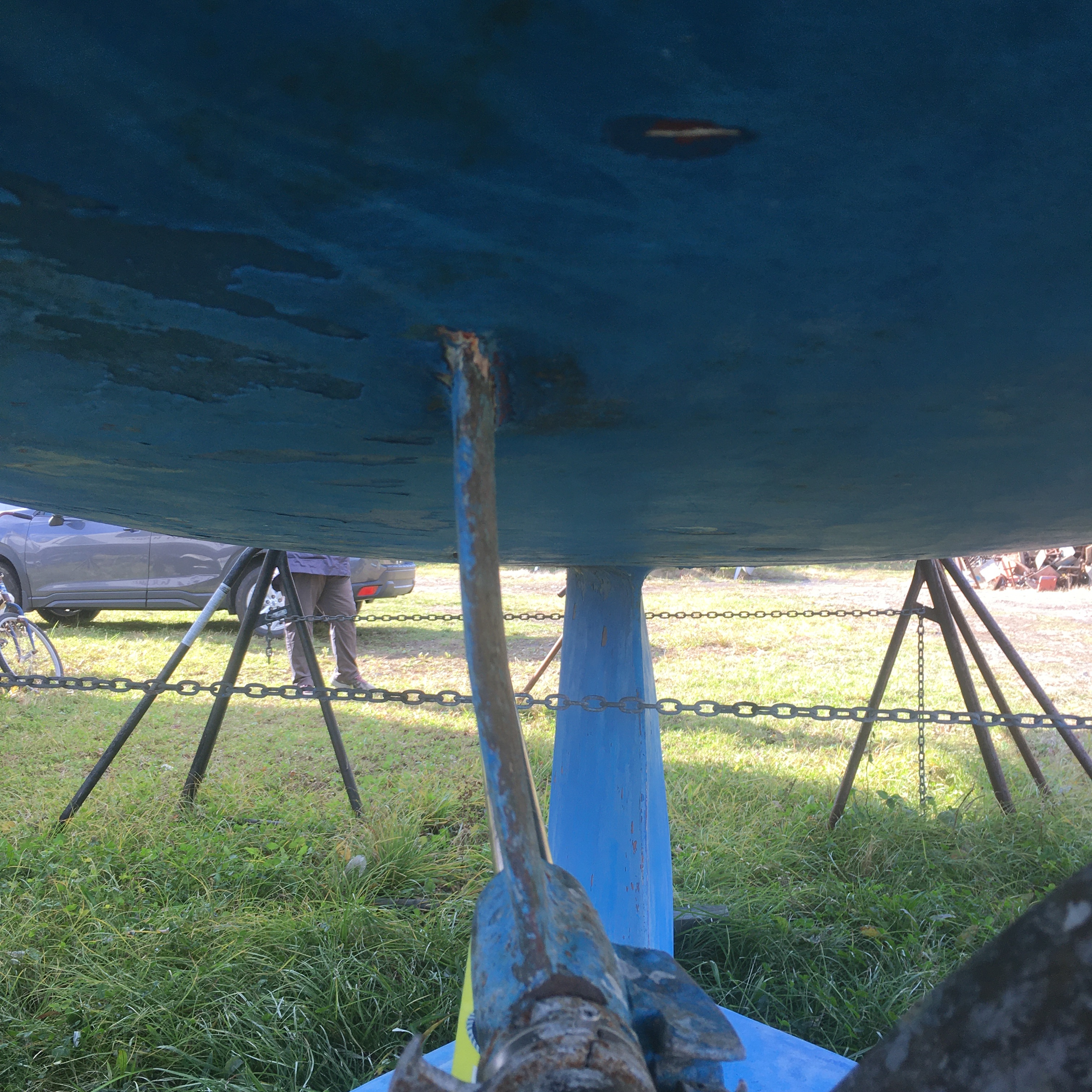

I recently viewed a F35 and was wondering if the prop strut was curved from the factory. This may be a silly question as I have never seen anything but a straight prop strut. I figured I would ask the F35 owners here. Do the later model (1999) F35’s have a curved prop strut?
I have a 1999– while the yard did manage to bend my prop shaft, first pic, the strut is straight ….and just off centerline….hmmmm
The strut is bent and should be replaced. Be sure to get a new cutless bearing to go with the new strut. The shaft should be removed and checked for straightness. If it is out more than 0.004" it should be straightened. The shaft seal and the motor mounts should be checked for damage or possible replacement. Now might be a good time to replace the rubber hose and hose clamps securing the shaft seal. After reassembly, the engine will need to be aligned with the shaft and strut.
I’m pretty sure this is the boat I’m in the process of buying. The surveyor said that there are two approaches to repairing the strut. The first is to replace it as you describe, but straightening the original strut off the boat (though if a new strut is available I could spring for that)-it’s glassed into the hull in addition to any mechanical fasteners so this involves essentially cutting it out of the hull and then restoring the glasswork to original condition. My concern with this is that the quality of the repair match the original specification in both strength of the strut and resilience of the glass. Obviously this is dependent on the abilities of the yard chosen. Is this a common enough issue on any boats with prop struts that a large yard with a good reputation should be competent to do the repair? Is there anything special about the Freedom 35 to be aware of?
The second approach is to straighten it on the boat after pulling the shaft. This involves building jigs both for straightening the strut and to rig a laser to confirm alignment. He said the strut/hull union was not affected when the strut was bent.
Cost for either approach probably close enough due to need for custom jigs so that is not the issue. My instinct is to have this done without cutting into the hull so the big question is does the on the boat method seem reasonable if the yard agrees that the strut mounting is still solid and will not allow any water intrusion into the hull? Is there a compelling reason to replace the strut instead? As in full replacement I realize the end result is operator dependent.
This occurred during the haul out in the current yard and their reputation is not stellar so they will not be doing the any work on this boat.

Seems like most yards that work on engines, drive trains and glass work should be able to handle. Getting the job done in a timely fashion given current supply and labor issues could be a challenge.
Am curious where one would get a new strut and what a reasonable estimate for this project would be. Seems unlikely that the existing strut could be bent back into alignment.
So the possible tasks would include new strut, cutless bearing, prop shaft, shaft coupling and alignment. Maybe shaft log, engine mounts, and rudder removal. Including all the labor
Presuming most of the above what would be a fair estimate? $6k-$8k ?
