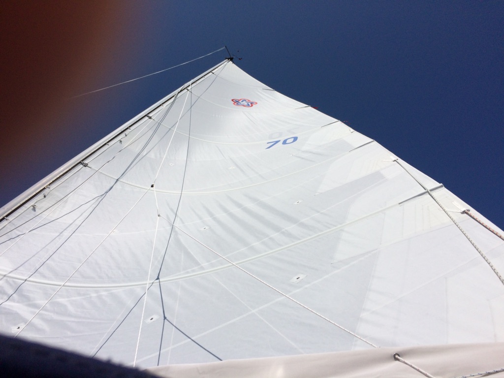

I took a piece of stainless tubing like used on a bow pulpit and mounted it to my masthead. One bolt thru the tube into a flat piece forward of the wind vane. Two u-bolts on either side to keep it from spinning. A small block on either end. I run a club flag or courtesy flag up one side and carry a radar reflector on the other. You can just make it out in the attached picture. (Sorry about the finger!)
I first tried flat stock of aluminum. Downward pressure of the halyards and snow bent it. Same thing happened with an L shaped piece. Round tubing is stronger and doesn’t hold the snow.
