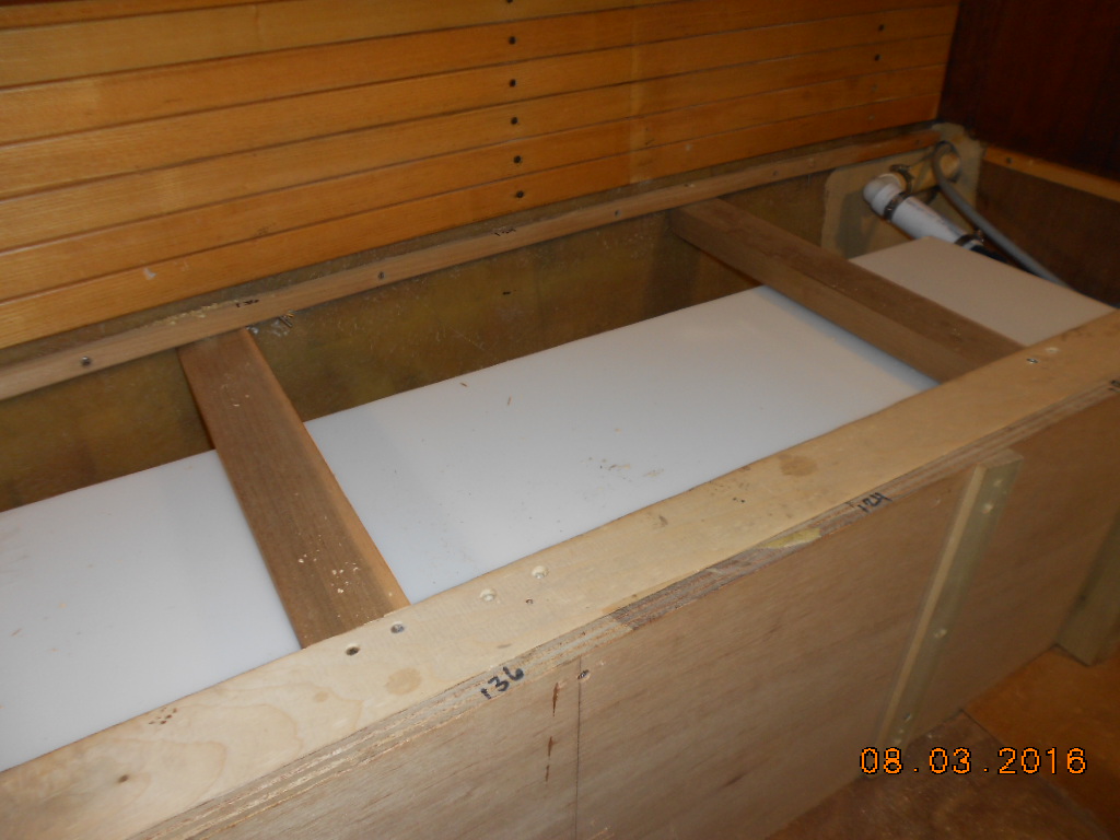

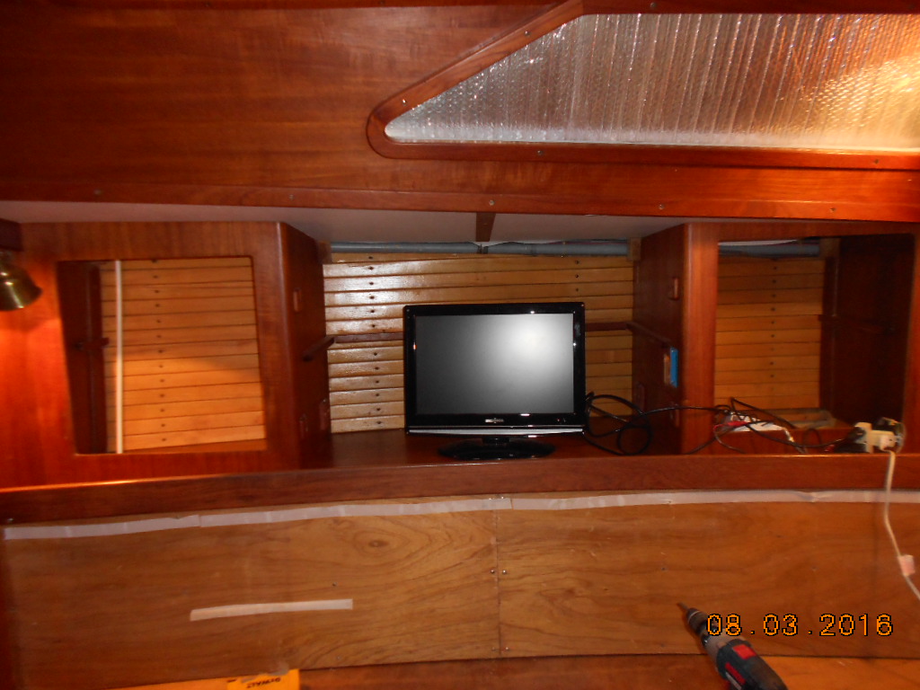

Wish I could tell you that there was an easy way but there is not. The tanks are full enclosed by the cabinets. I have pictures from when I changed one of the tanks but they are to big to load. The fills are easy to find by following the hose from the deck fill, the vent lines connect to the tank in the same place. The water is drawn from the lower forward point of each tank that can be accessed from the void behind the forward fuel tank on the starboard side or the back of the cabinet on the port side. There is no area on the top of the tank to place a viewing port or sender for a gauge. I attached a piece of 1/8 inch tubing just ahead of the fresh water pump that I hold up and open one tank valve at a time. How high the water comes up in the tube will tell you how much is left in the tank. I have the Express but the PH versions I have seen were the same as mine in this area. The only difference is that some models have cabinetry were some have bunks or shelving. Hope this helps.

I found some pictures that would post, one from just after starting and one from just before the tank can be removed. Hope you never have to go there though the entire project can be done without cutting anything, it all comes apart with screws.
