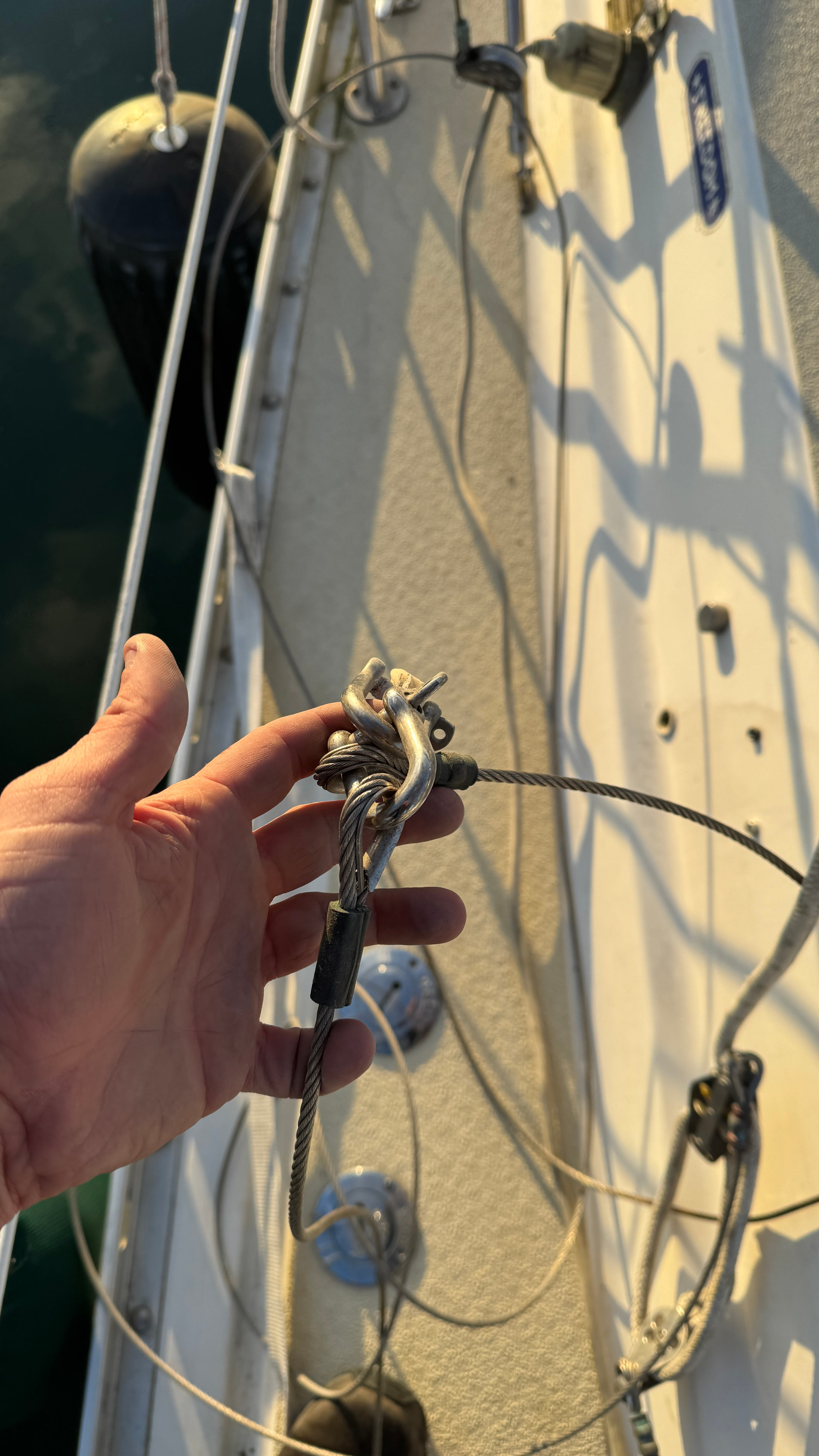

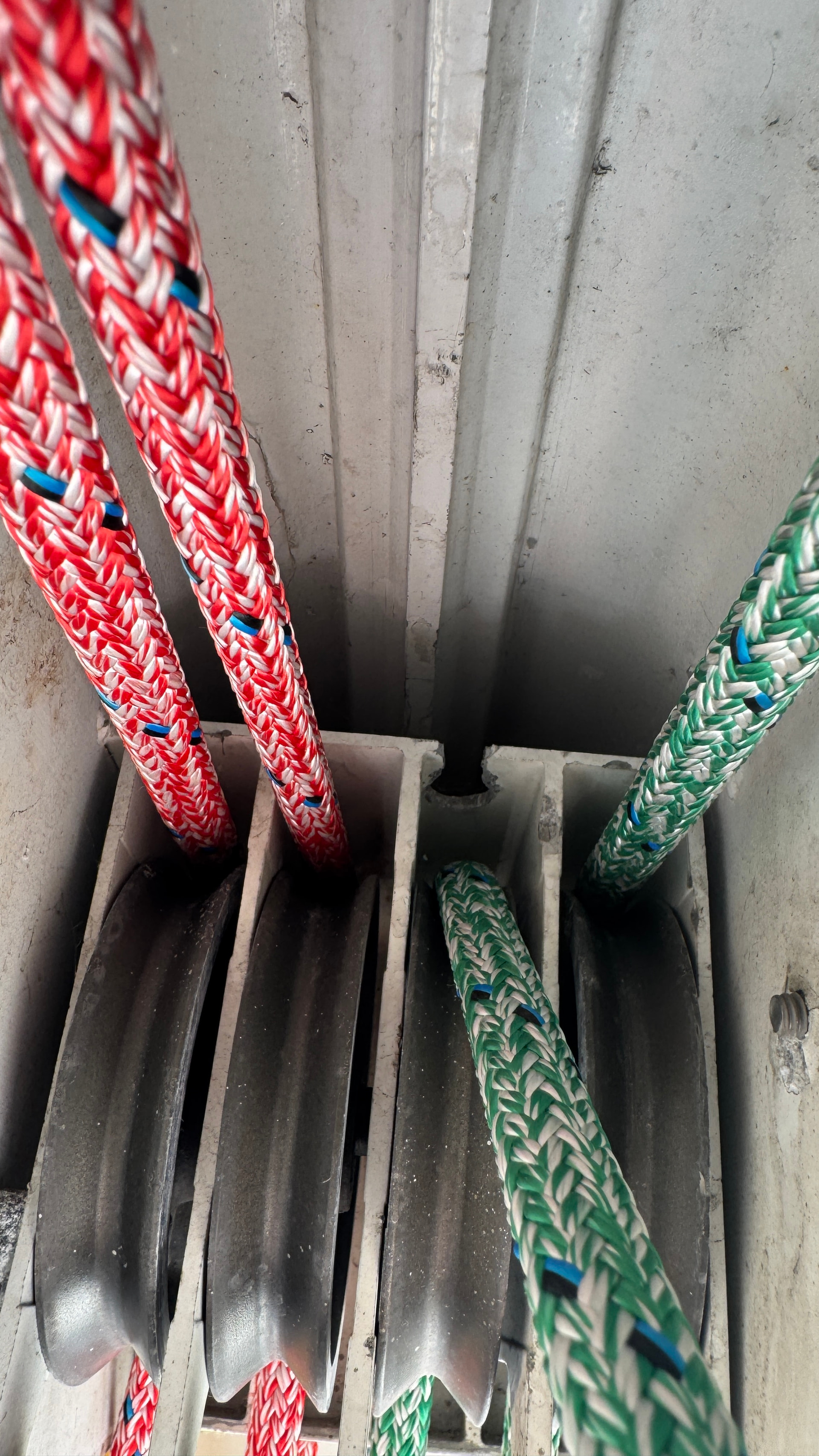

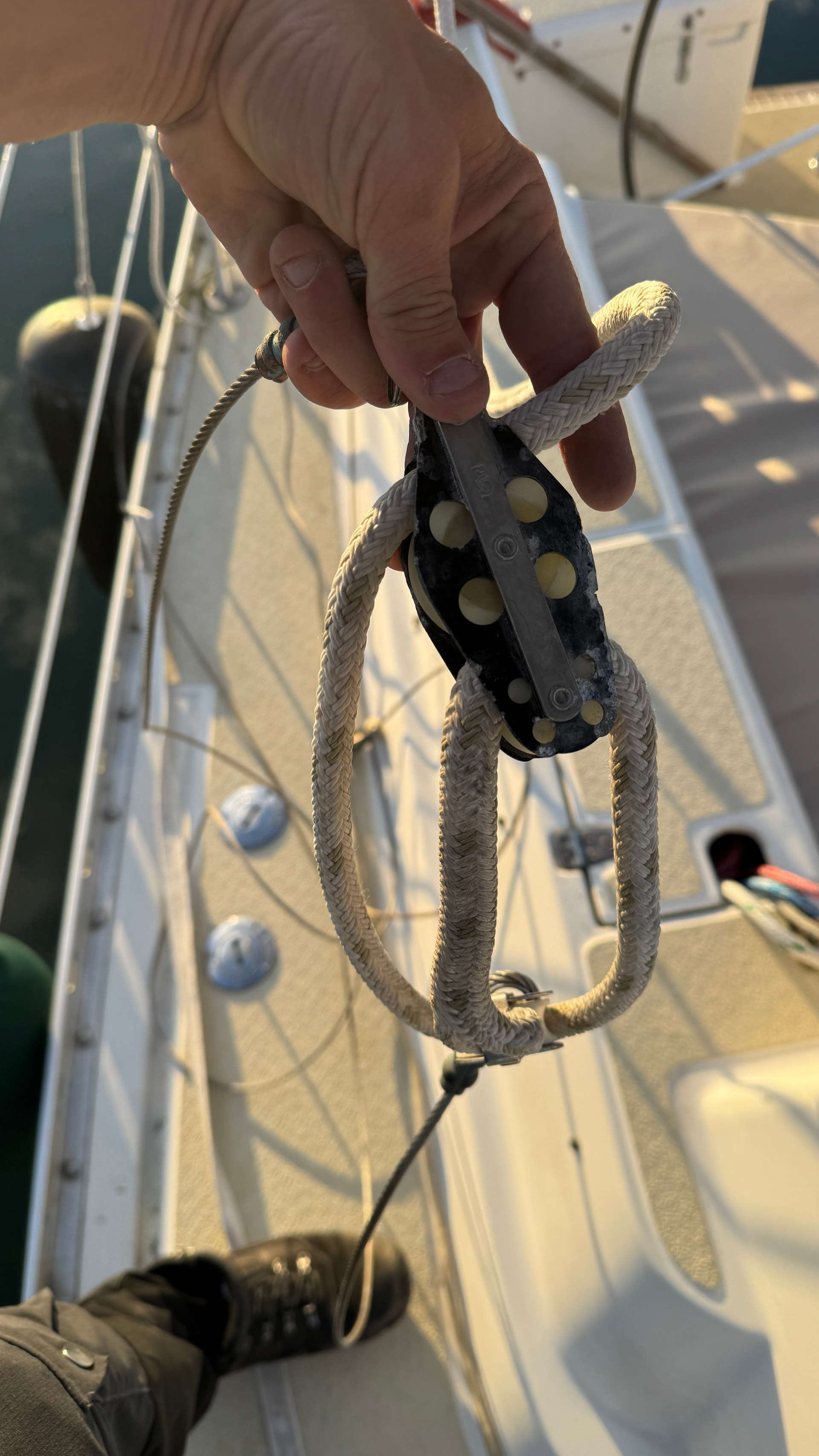

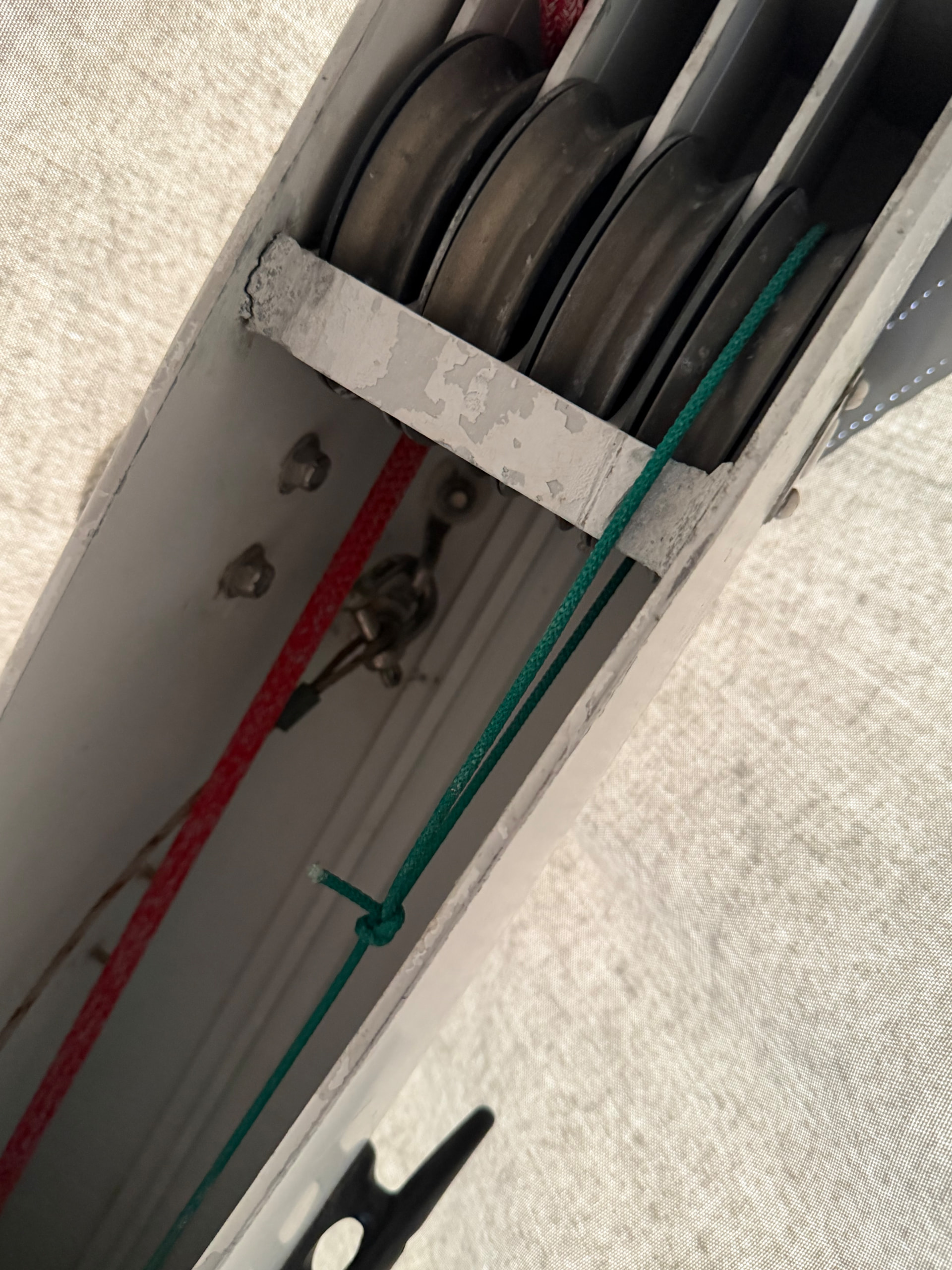

I’m hoping someone with a Freedom 40 40 might be able to help. How is your outhaul setup in your boom. When we were sailing this week, we had perfect tension and then all of a sudden there was a ping and it went partly slack. I have pulled the pulleys/wires and rope through, pictures below, but don’t really understand how it works and there is nothing in the manual.
I’ve fed everything back through, pulled as tight as possible and tied it off around the cleat on the boom but that seems to be the only way to hold it. There is no way to run it to a winch to tighten.

the outhaul does not lead past the cleat on the boom. I suspect that your block was partially skewed inside the boom when you thought it was tight… but under load, the block popped into alignment and gave you about 6” of slack. That block looks ready to be replaced.
That’s interesting. On ours there is a random wire with a shackle and washers that look like it was attached the front end of the boom above second reef. Do you have that as well? Essentially, it connects at both ends and the pulley block in the middle. Right now, the pulley block is right up to the rope opening. You don’t be chance have a photo of the underside of your boom at the front?

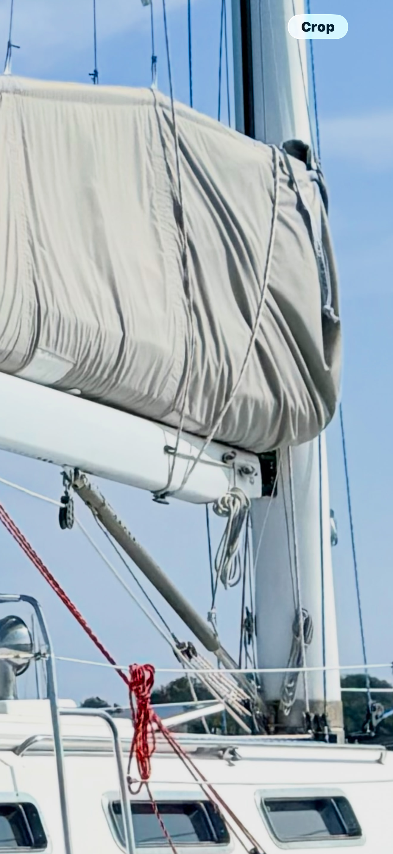

Heres my out haul
Yes, that’s exactly the same as mine, which is good. The issue is how the blocks and cable are connected inside. It looks like mine had a cable wire from the outhaul blocks in the boom, connected just above the reefing lines at the front on the boom, but inside, just above the pulleys. That is what we think pinged out. The whole outhaul system is now basically floating in the boom, and I can’t pull anymore tension on the outhaul because the blocks are right up to the but where the rope comes out of the boom, so there is no leverage to.

If you have chance to have a look at yours, can you have a look if there is a cable attached to the inside the boom, at the front just above the reefing lines. We think that part of the outhaul was fixed to a point just above the sheaves at the front of the boom, inside. Many thanks

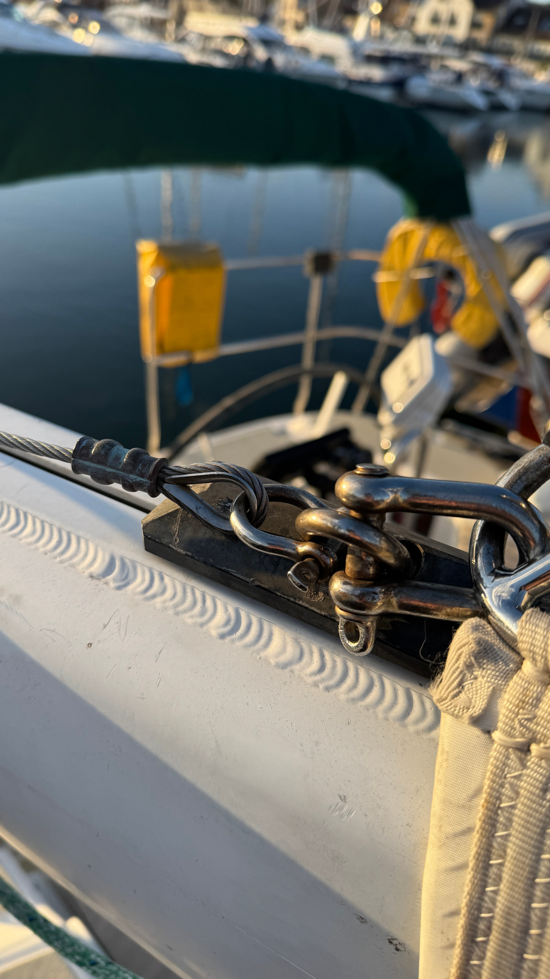

Here you go. Sure enough.. you can see the cable is attached to a pad eye with a shackle And look at that cracked weld. Oh boy!
Ah, ours was attached just slightly further back with a shackle above the sheaves. Thank you so much for sending this over. You should be able to get that welded back.

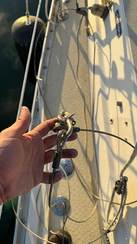

Thank you. What I found is that at the front of the boom inside the boom, underneath, above the reefing lines, the end of the outhaul wire was attached there with a shackle and snapped awy which slackened the outhaul. Need to find a new way now to attach it, or a whole new design.

What snapped? The pad eye? If so, just drill out the old rivets and place a new pad eye in the old one’s place.
No, ours doesn’t have a pad eye, it has a strange slot above the reefing line. I’ll put the picture below. A shackle goes through with washers but I can’t work out why it was done like that.
Ah I see. It looks like that was once drilled and the aluminum succumbed to dissimilar metal issues.
You could drill a new hole on another spot on the shive block housing or mount a pad eye like I have which I feel would be a stronger connection. You might have to cut and re crimp the stainless cable to account for a change in the cable run.
