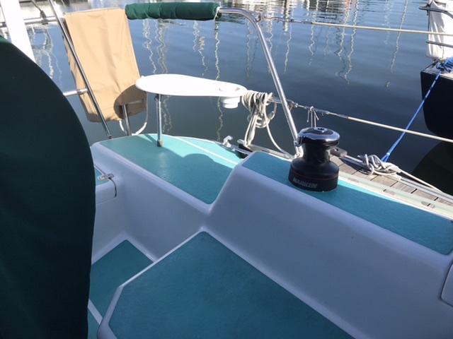

TonyB - I’ve been following this interesting thread. Specifically head stay tension with roller furling. I have F 35 (P) 1999. Roller furling. Had the boat 4 years now. I had zero problems or concerns with the operation of my roller furling until a few months ago. I had replaced the jib halyard and thought tensioning that would be good - not paying attention to the tension before replacing. In March, on the sf bay, sailing in 34 kts aws I tried to furl the self tending jib. Going upwind and tacking to get luff in the jib I tried to furl and couldn’t. In fact I ended up causing a slight tear in my meniscus, tweaked my back, and groin all in one :smiley: I headed downwind and managed to furl- but only just. Back at the dock I loosened the halyard- no real visible slack or bend in the forestay - but furling was easier. I then installed two harken 35.2 winches to (1) help with the asymmetrical and (2) help with furling the jib in similar conditions in the future
So the problem is not the same - my forestay seems right and has never bucked the mast (yet). My problem was over-tension in the halyard. I tested the new winches out Saturday-
Too breezy for asymmetrical I unfurled the jib, and wrapped the furlor line to the port winch and so easily rolled the jib in in a breeze - wow it was easy and light feeling. So all good here. When the wind pipes down in the sf bay I’ll try the asymmetrical out with those winches.
