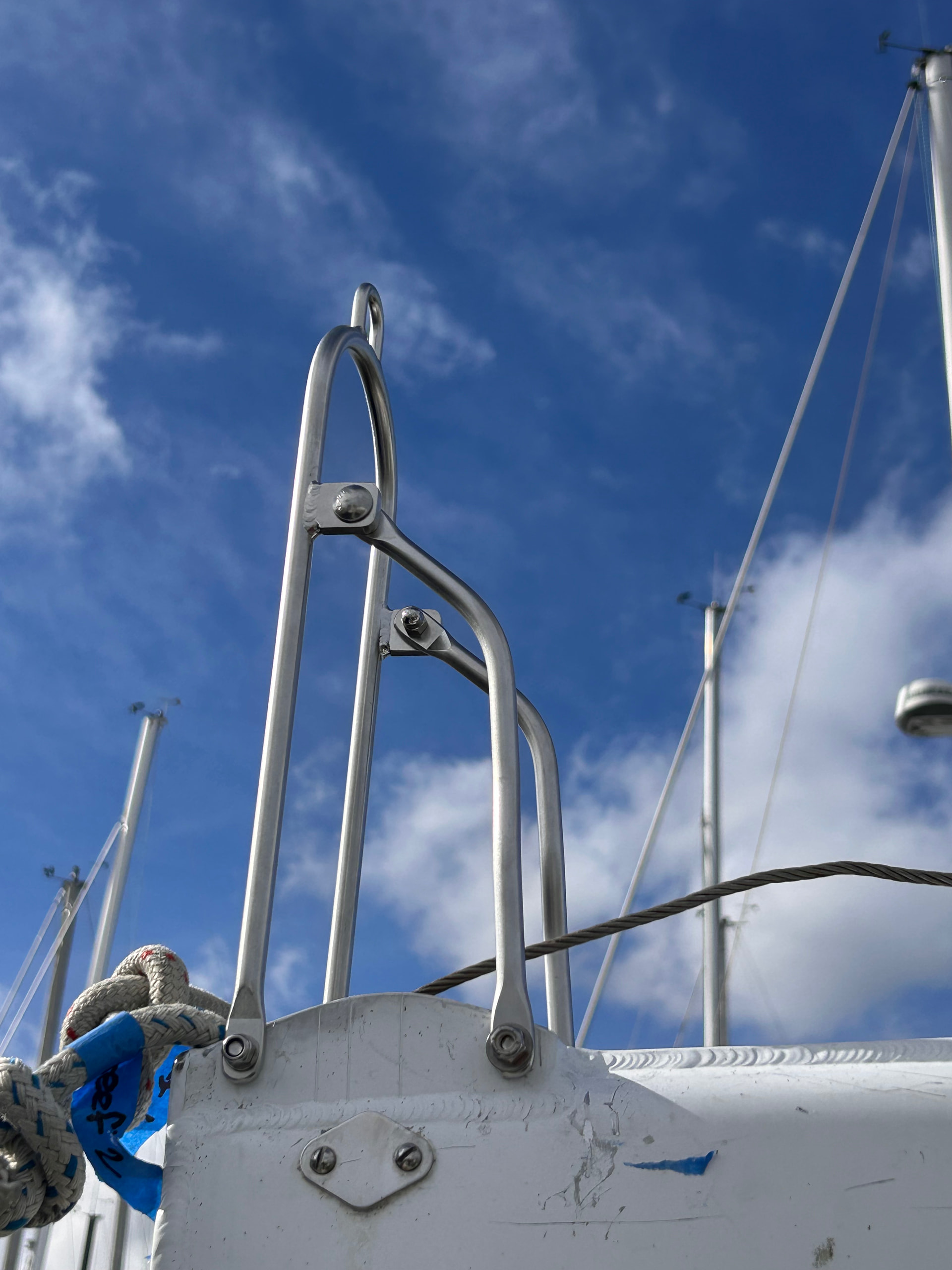

Thanks :slight_smile: My stackpack made the decision for me. Because it is so long, I felt that I had to mount the bracket as far aft as I could on the boom. Instillation was super easy. Held the bracket in place and drilled a 7/32” hole then tapped it with a 1/4-20 thread tap. Added some tef-gel to a bolt and screwed it in place to hold the bracket and then drilled and tapped the rest. Took about 15 minutes. Be sure to use tef-gel. If you dont you will create a little electrolysis problem around each bolt.

Went with an install as aft and high as possible. It was a bit of a tight squeeze betweeen the heads of the provided bolts and the sheeves. Bring a new, high performance drill bit. The aluminum is challenging to get a hole started with a drill operating above the shoulders.
That looks great ! You solved the shorter bracket issue.. i had not thought that it could be mounted on that flange. The aluminum there is probably 3x as thick as the boom extrusion.
