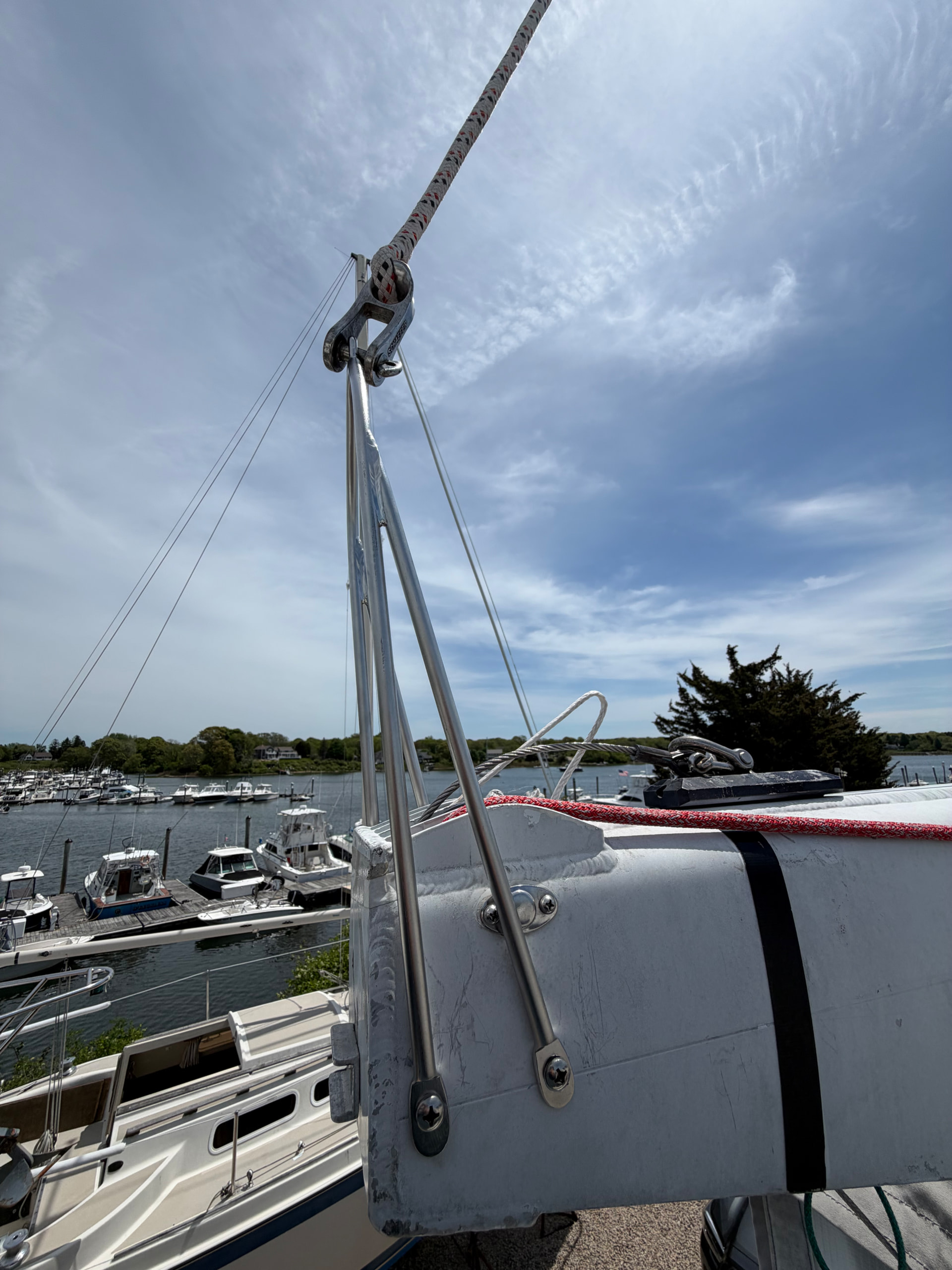

Please post a picture of it . Im super curious. The one issue that i thought of when I looked at the dimensions of the bracket is that it might not be as tall as my stack pack. But maybe thats ok.
Attachment point for topping lift on my 40/40, Nuages.

That bracket looks perfect ! Thanks for sharing

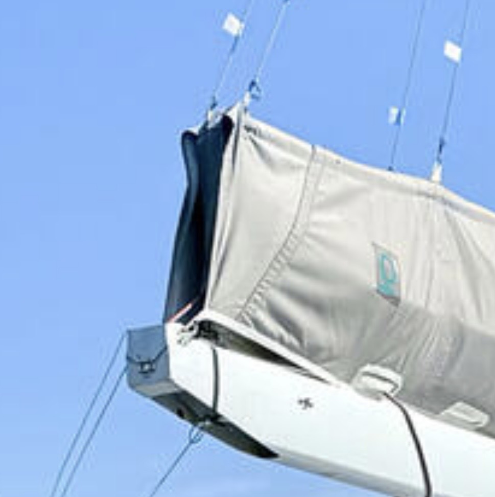

Any chance you can send a pic of the back attachment you have on your boom that holds the back of the Stack Pack? The stack pack looks great!

The lower aft corners of the stack pack have a short length of rigging line that goes around the end of the boom. Theres a little pad eye that the line goes through back there to hold it captive. But i need the bracket so I can hold the zipper captive and maybe hold a turning block so i can close the zipper from standing at the mast.

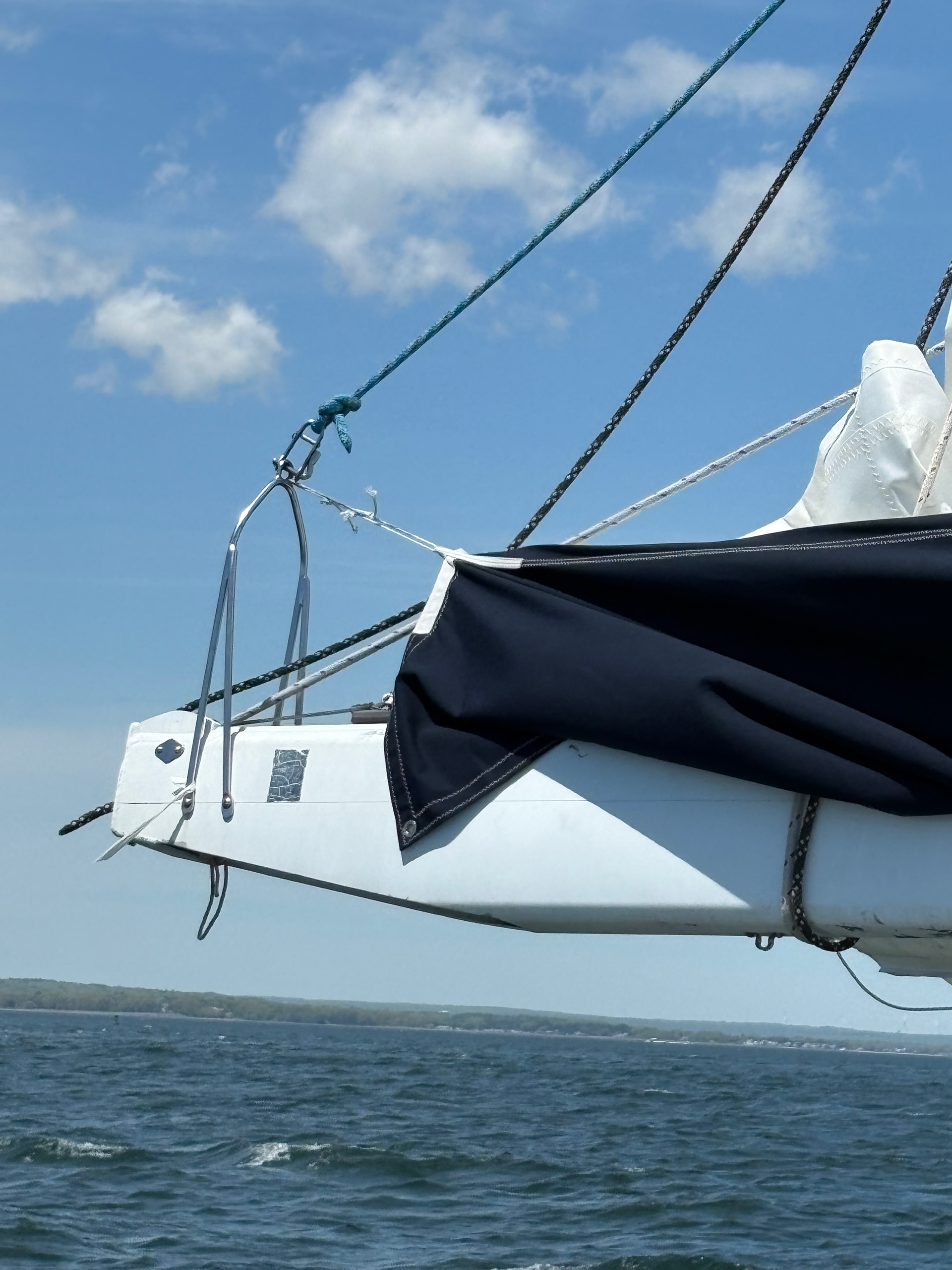

Installed the mack sails large boom bracket this morning. Its going to greatly improve dealing with the stack pack zipper. Once i get the mainsail rigged, I will attach the zipper to the bracket and attach a turning block to the bracket so i can close the zipper up from the mast using a continuous loop of small gauge
line.
Looks great. How did you decide on the location of the bracket? Looks like you went as close to the weld on the boom end as possible. Did you have any difficulty drilling?
