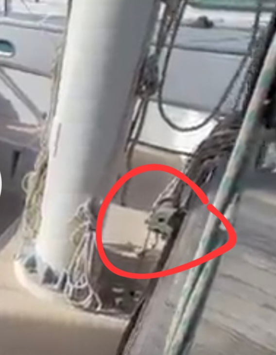

Gazella definitely is center board. One of the photos I pulled shows winch.
