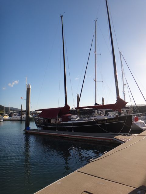

Hi all, I have recently purchased Black Magic II here in Australia. She has a missing centre board (lost to a whale near the Galapagos)
Can anyone help me with some engineering type drawings so I can manufacture a new one? All help greatly appreciated
She already sails well without it, however I am sure performance will be greatly improved with.
