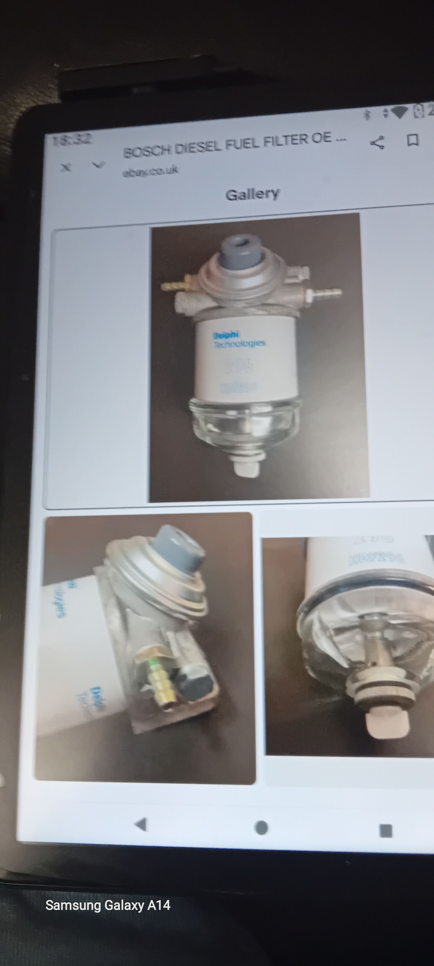

Recently had an intermittent air leak which i finally Traced to a cracked teepiece in the fuel line this took quite some time and constant bleeding of the line with the lift pump a real PIA
So whilst sorting out the leak i upgraded the primary fuel filter to one with a pump ,this was made difficult because the same make filter housing changed from bsp to parallel fittings
But it was well worth it few pumps and the fuel line was primed with fuel sqirting out at each bleed point
bosch housing with 296 filter £47
Hi, interesting filter with pump, I would like to see a photo.
Photo from e bay
