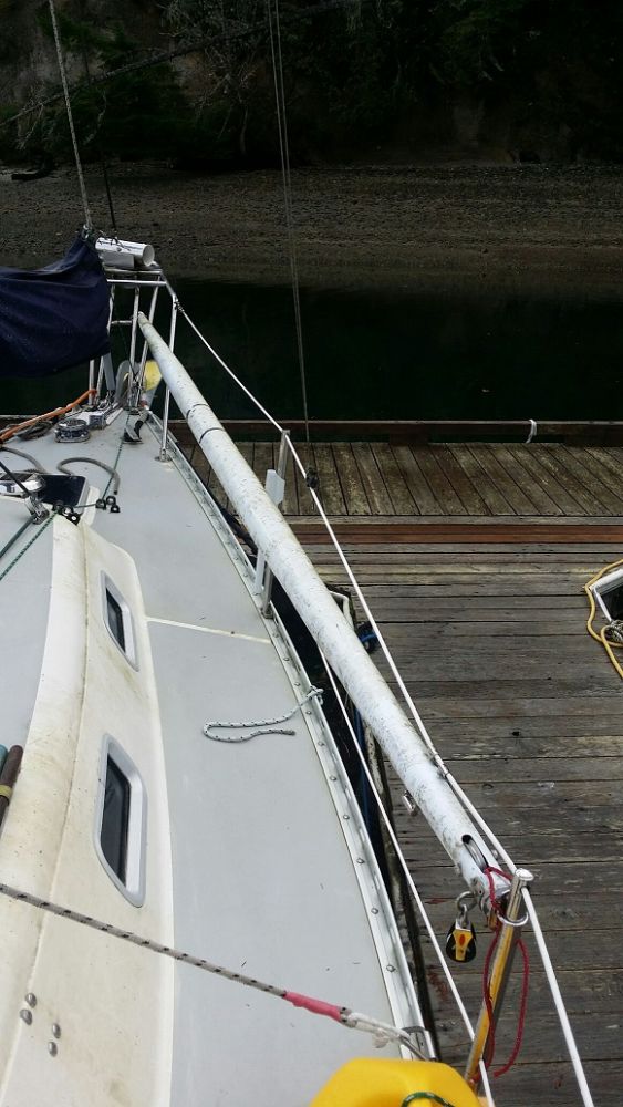

The pole on my 1986/87 F-30 is a tapered one exactly 16-feet long.
I store it wedged in the pulpit in front and tied to a SS antenna mount attached to one of the stanchions.

So the sail is retrieved aft of the pole? If I understand you correctly then yes that would be much easier. Not only is the pulpit top more open aft but you haven’t got to squeeze through the reinforcing pulpit legs. Makes sense. Not sure why I concluded the sail had to be retrieved forward of the pole.
The pics is excellent, really helps visualize the rig. I wonder where Freedom Yachts sourced that tapered pole? I had a 25 many years ago which was equipped with the gun mount - I have since forgotten most of the rigging detail but i do recall a big untaperd pole was used, so I know it is doable with a standard tube.
