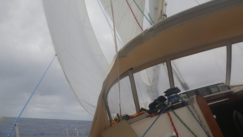

I have one on Scherezade and used a lot this summer on long stretches with little wind, mine comes with a snuffer which is
easy to use. When choosing anew I would probably prefer it to be furled along the luff, I think that’s even easier to handle.
I love the sail, really makes a difference. Kept me sailing where I would use the ‘iron genoa’ instead. While it’s a large sail I use it mostly
on longer stretches.

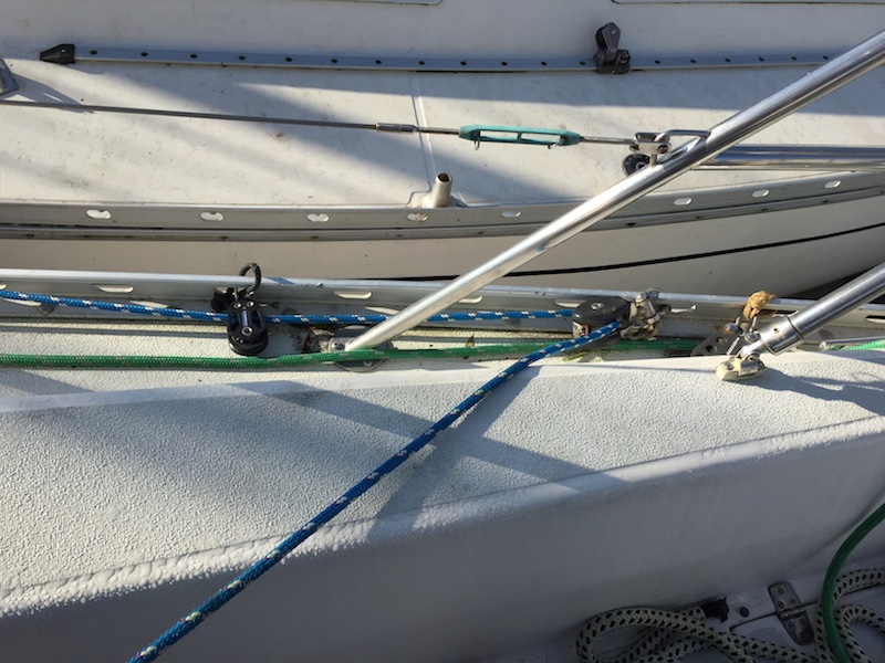

How are the sheets for the jib-top reacher controlled?
Are genoa winches required on the cockpit combing?
I have a snatch block to the toerail aft near the cockpit, from there to the winch on the cabin top as shown in picture. Not ideal, there’s some chafing over the cockpit coaming you have to check.
I considered having winches on the cockpit coaming. But the coaming isn’t made for it and should probably be strengthened. I found it too much of a hassle. Besides that, I use the jib top seldom, this configuration suits me well so far. The small ball bearing carbon block forward of the snatch block is for adjusting the sheeting angle.
I use it also to keep the camberspar to windward when I want to heave to.
