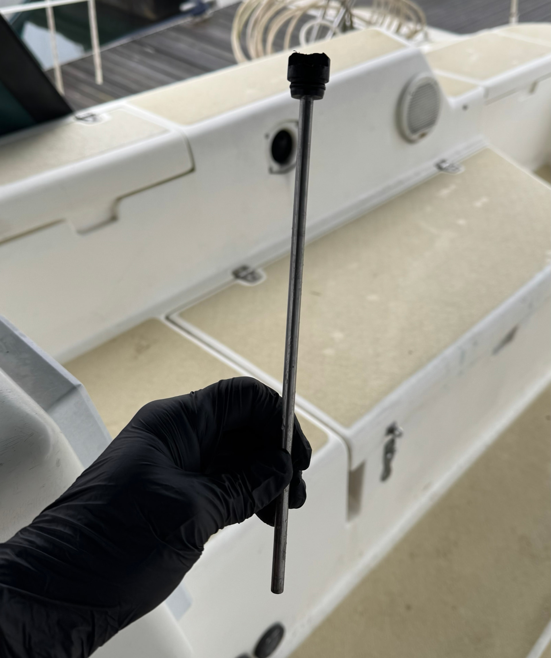

Benbirnie- your winch may be different from mine. I have the electric Harken 46.2. When assembled, the manual winch handle may be inserted into the top, pushed down to place in manual mode. Removing the manual winch handle regains electric mode. Under the top cap there is a long rod that in manual mode disengages the motor. If the rod is stuck in the down position the winch will be in manual mode. I can hold the rod and lift to remove it. If it doesn’t remove then something else is going on. There is no “pin” per se. have you completely disassembled the winch - take a pic —
Hey, apologies, it’s my terminology. I do mean a rod and it sounds like we have the same setup. With a little bit of pulling and wiggling I have managed to get the rod out. When the rod was pushed fully in, the winch handle wouldn’t sit in properly and kept popping out. Now that I have managed to get it out, I’ll take it all apart and see iif I can spot anything.

Just wanted to say that after a lot of degreasing, scrubbing and reassembling the winch is now working as expected. The disconnect rod is now disengaging. Thank you all
Can you pull the rod out without taking the winch apart?
I find I can easily remove the rod but have difficulty inserting a handle. The rod is hard to push down sufficiently. Not sure if the rod is installed correctly.
Hey, yes you have to pull the rod out to be able to unscrew the screw in the shaft. It sounds like the rod is not engaging the clutch to switch it from manual to power. I had the same problem, but the other way around. I could push the rod in and engage manual but it would not come back out. I finally got the rod out, and then had to dismantle the winch, clean it, grease it and put it back together and it works fine now.
