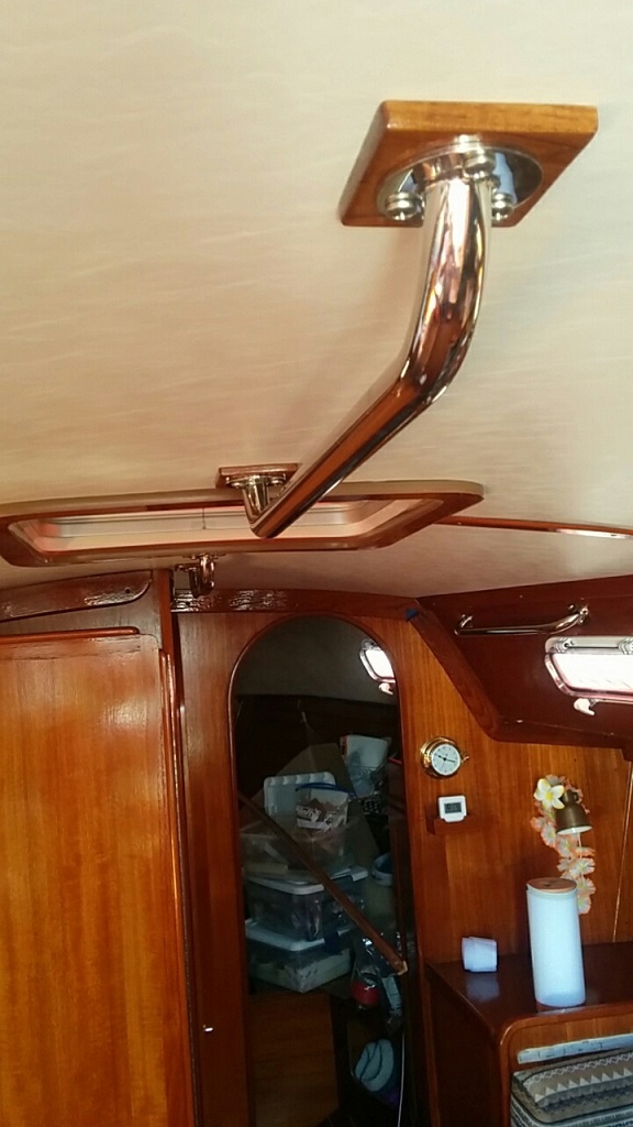

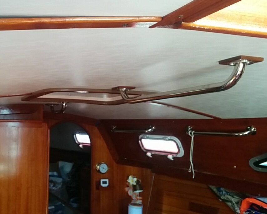

I have noticed a few posts about headliner replacement. Here is a pic of of my just completed replacement. The headliner was out of the boat for about 9 months. A combination of racing, procrastination , foul ups and life getting in the way. But it is finished, finally.
The last time I did this 15 years ago. I used the typical foam backed headliner. Never again. The foam deteriorates and delaminates and the headliner sags. I had some spare foam backed material from the original job stored in my garage. The foam on the stored material also decomposed over the years. Not Good.
I decided to use non backed vinyl material this time around. I also decided to use epoxy as the adhesive. More work, but bulletproof with respect to durability. The key was to spend lots of time making sure all air bubbles were out of the material plywood interface. This takes a lot of effort with a nylon squeege. Then you press with a big piece of ply with weights on top.
I did the press with a 3/4 inch piece of ply, my workout dumbells, some extra floor tile boxes I had laying around and, I kid you not, a new cast iron kitchen sink we bought for a future countertop replacement in out kitchen. Its a nice sink too.
A couple other pics too. While I was doing the headliner I added interior handholds. I went a little crazy , I know, but I really get bashed around at sea and I wanted something to hold on to wherever I went inside the boat.

Sorry about photos not being uploaded, apparently there is a restriction on pixel height. I need to figure out how to shrink the height without cropping everything of interest in the photo.
Hey Mike! I’d love to see these pictures when you have that figured out. I removed the foam-backed headliner last year and still haven’t decided what to replace it with. I kinda like the bare look to better access the through bolts, so it may get painted off-white and just call it good. After our recent LongPac, I definitely found out the hard way that I don’t have enough handholds in the cabin either. Extra USB outlets and the SSB will be in process soon. We should put a picture book together about all the changes we’ve done to our Freedoms :smiley:
Since Mike had trouble posting the pics, I’ve offered to put them on the forum for him. Great job!!
