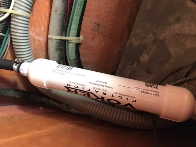

I’ve been threatening to install a holding tank vent filter for a while. Last week at the boat I did a dry “fit” based on talking with Paul Dennis. The dry fit was me squeezing into the stbd lazarette with the 2 back panels removed to access the vent hose and holding tank. I could just squeeze in and rotate upwards to use one arm for the work. Really tight :smiley: Didn’t see any leaks and no odor- good. the vent hose looks larger dia than 5/8” ID. Plan is to cut off the hose top and bottom and insert the filter between. Have several sizes hose clamps ready.
In the cockpit we get a strong whiff of stink when flushing the head- hope this does it . Pic is completed job

Pic of vent filter above :smiley: As I had to use both hands I needed to go over the lip and rest on the holding tank- dicy getting back out :smiling_imp:

I hope you have an accurate gauge on the tank, because an accidental overfill will mean a new filter has to be fitted at once. The hideous sludge when the tank content meets the nasty stuff is worse than just a plain overflow, and doesn’t easily flush out. Don’t ask how I know this!
Local standards suggest a 38mm dia. hose (inch and a half) for the vent, and, after spoiling a filter many miles from civilisation, we did without and had no noticeable problems for the next few weeks. The large diameter hose allows some air circulation, and also facilitates suction emptying, required in most European inshore waters.
New filters are £45 each ($50+), so we have become more careful, but at least we can change it from the heads compartment. We thought of putting the filter in a locker, but only the other owner could squeeze inside it; since she kept her clothes in there too, that idea was rapidly discarded.
Castaway- good info in your post. I do not have any gauge on my holding tank. As it is usually me sailing I gauge approximately the waste amount in the tank and every couple of weeks go to our free pump out to discharge. I rarely have more than 10 gal US. Tank holds 30-35 gal US and my head has a macerater… Offshore or coastal beyond 3 nm I discharge legally into the sea with the y valve. Inside 3 nm y valve is wired off to prevent accidental discharge. 1 1/2” vent would be great - with a filter- but most of our vents are 5/8- 1” depending on make and year of vessel. Do all or most of the EU recreational vessels use 38mm venting?

Tom,
Yes, 38mm is standard EU (& UK) fitting, for vent openings and filters. Pump out is easily available in Scandinavia, France, Germany and parts of the Mediterranean coasts, and at a few places in UK. New boats must have the toilet discharging to a holding tank, with no “Y” valve, though the tank can be discharged to sea when offshore. We have this system, retrofitted to our F35 cat-ketch. The tank is above the waterline, so no pump needed to drain at sea, and we just leave the valve open, then. Inshore, we check the level obsessively, and hunt for pump out facilities; in Sweden and Finland, there are barges moored at intervals among the islands for those who don’t use marinas, or earth toilets ashore at the more popular anchorages.
I agree there is little less appealing than maintenance and repair work on the sewage system, but ‘stuff’ happens, as they say!
