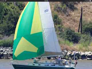

See pic - on my f35 I rigged an asymmetrical spinnaker. I use an ATN Tacker on my wrapped up jib to pin the tack with adjoining tack line to a forward cleat. Head has a sock making hoisting and dousing straightforward and drama free pretty much. I can single hand this. This configuration is good up to 12 knotts AWS - and that’s a handful. If I had it over to do, I’d have Mack Sails make the asym SMALLER. Had it less than one year and no strain on mast as I can see YET. Pic is by Carqueniz.
Thanks Camino! I actually have a small spinnaker like that, which came with the boat, but the sock was toast so I tossed it. I borrowed an ATN from a friend but just never got comfortable with flying the spinny. I’m a bit of a wimp about them. How does the spinnaker differ from the jib top reacher?
The asymmetrical only has one sheet at a time to deal with. The more of a run, you let the sheet out so the asymmetrical flies kind of in front of the boat. That works up til about 150°. My sail needs to be about 20% smaller for me to be really comfortable with it up to say 12 to 15 kts apparent wind speed. The asymmetrical head attaches about 4 inches above my jib sheave. Asymmetrical halyard attaches at mast- I raise the sock from the mast and tie off the halyard there. I run the two sheets port/ starbd, and the tack on the Tacker . Raise the shut and tie off those two lines at a forward cleat and go to cockpit to trim the one sheet. Dousing is blowing the tack by pulling the lanyard on the Tacker shackle, while holding onto the 2 chut lines that I’ve uncleared. The tack blows free. Pull down the shut and sail-tie off the downed chut until I want to really put it away.
