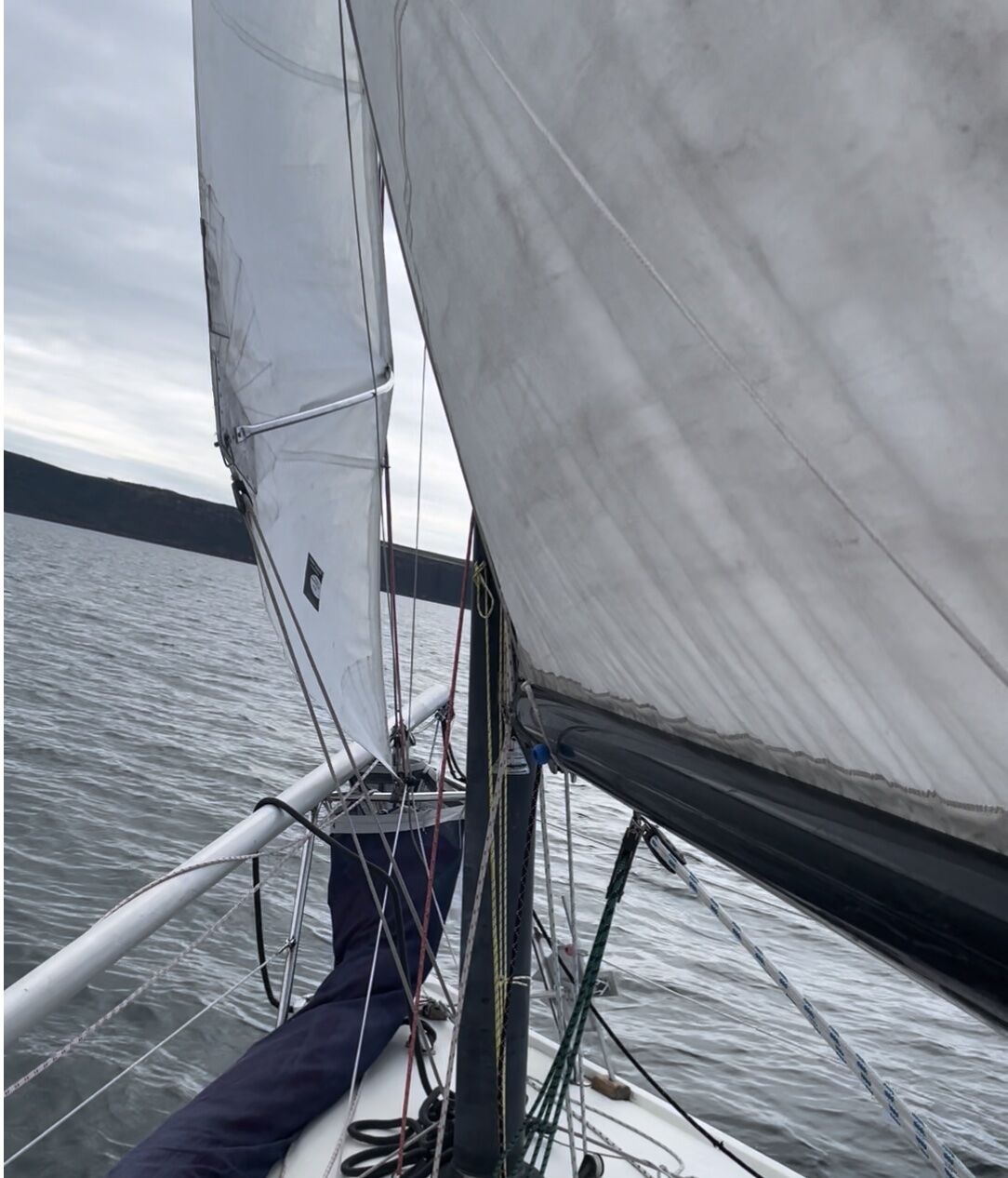

On my Freedom 21, which has a self tacking jib, I have used a continuous halliard loop which both raises and lowers the jib from the cockpit. It has made a big difference as I no longer need to go forward when I want to lower the jib and raise the spinnaker. This would solve one of your problems. However it does get in the way when anchoring. I see no reason why you could not modify the jib to become roller furling, However the difference with a roller furling boom on a main is that the boom is through the middle of the jib. My F21 jib has a wishbone boom that goes either side of the sail and something like that could be used with outhaul and roller reefing line. Can’t see both sides below but it is symmetrical about the jib.

I have a single line that terminates at the head of the jib with both ends. The halliard end goes up the forestay over the halliard block and down to the pulpit. The downhaul end just goes down to the pulpit. There are turning blocks for both ends on the pulpit. Then both go through fairleads and create a loop in the cockpit. Pull one way it goes up, pull the other it comes down (all the way). I use the sheet to control the boom and keep it centred as the boom comes down.
I did a post on this some years ago but could not locate it. I can try to draw a picture and post if you cannot understand the text description.
Thinking about it a bit more, creating a wishbone jib boom to work with a roller furler would be very difficult, you would need to get the fuller to rotate inside the boom somehow, not easy!. So going down the roller furler route would probably require dumping the jib boom and having a different sheeting arrangement.
