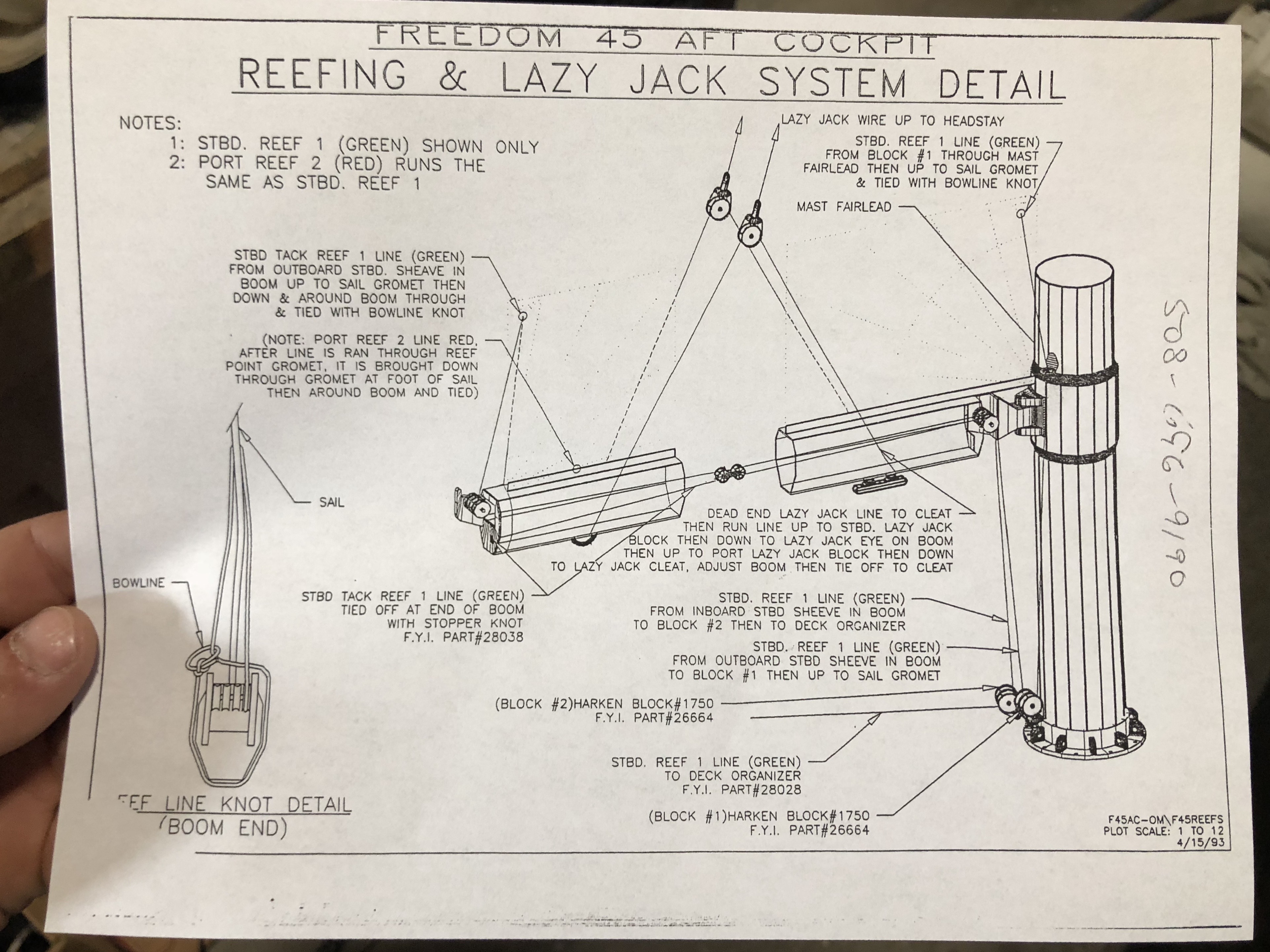

If you have Isomat booms, he’s probably referring to the single line reefing setup. This picture is from the F45 manual, but it’s the same system.
Many thanks I feel sure that is the information I require.
Best wishes
Michael

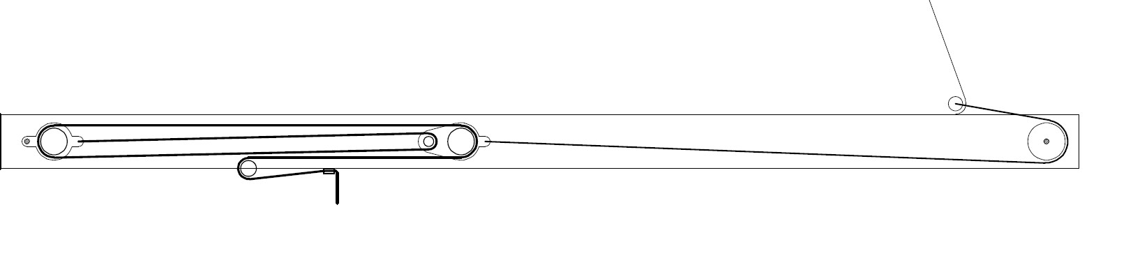

He may also be referring to the outhaul - I’m not sure if it’s different on the larger boats but on my Freedom 21 the outhaul has two blocks inside the boom (not to scale):
Thank you Ian, very helpfull.
