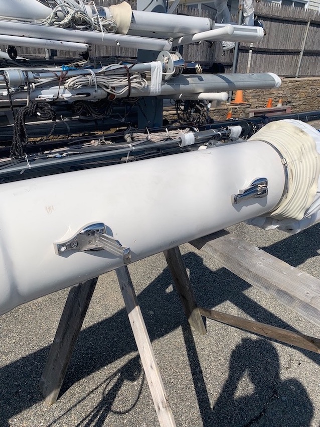

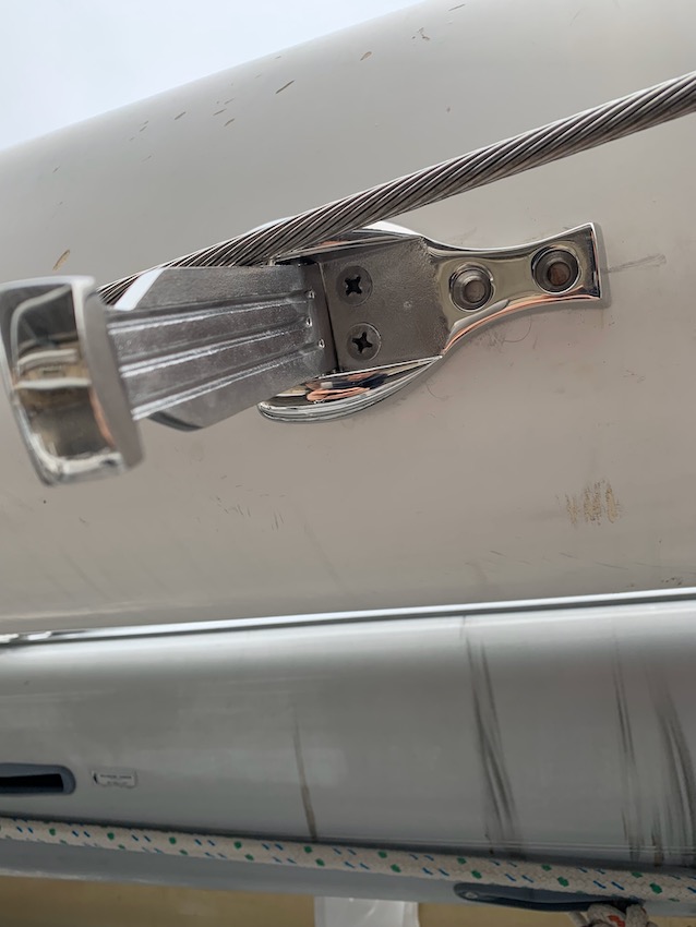

Here are two of the three folding steps I installed last winter to replace the original aluminum ones, one of which had begun to crack. The new ones are 316 stainless. In addition to the fasteners, I also bedded them in 5200. The original steps were screwed into threaded brass inserts, but Paul Dennis assured me that this wasn’t necessary, and that Freedom eventually abandoned this step in favor of drilling and tapping the carbon fiber directly.
They came out really nice looking, and they’re plenty strong. I picked them up on Amazon for $21 each.
