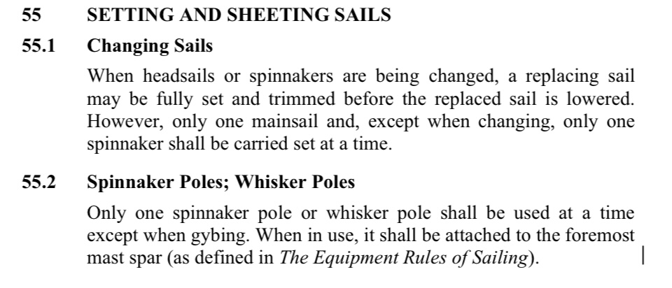

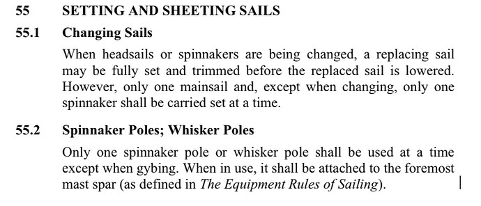

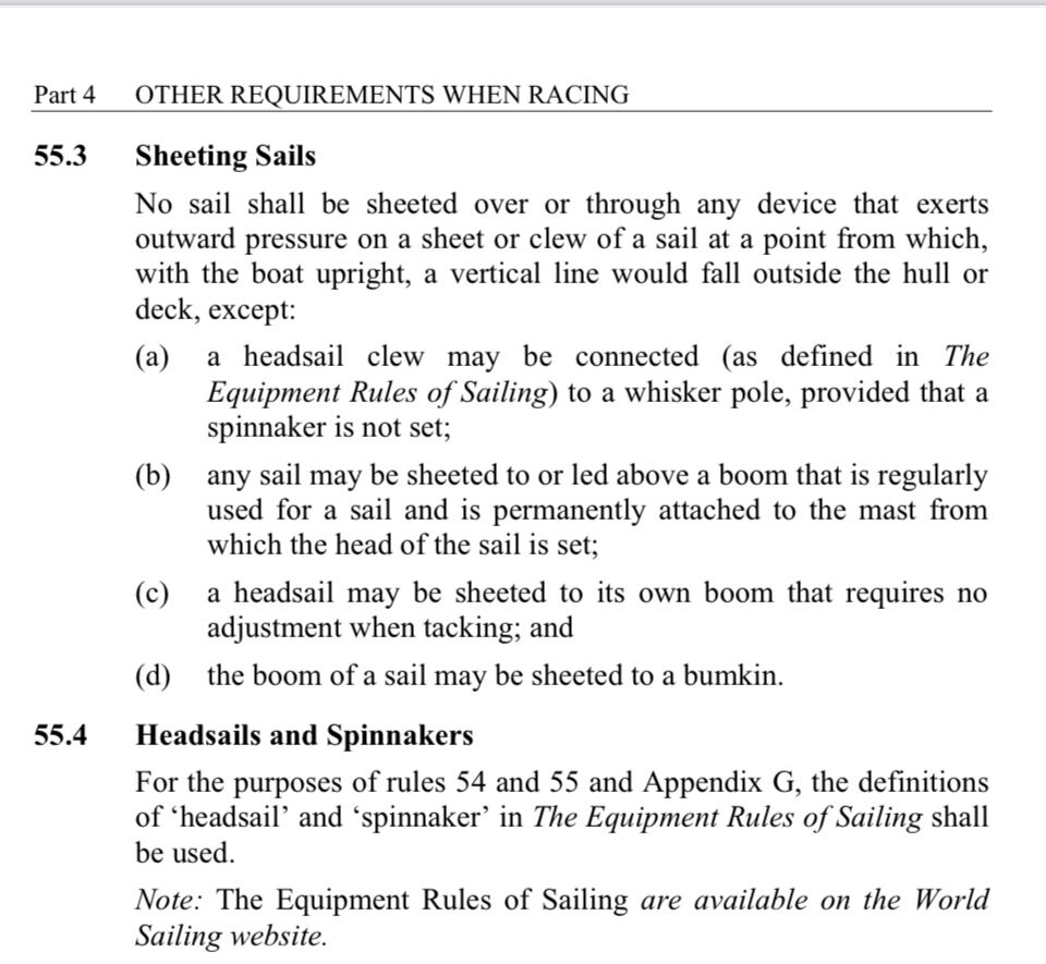

Does the original Freedom Spinnaker setup comply with the Racing Rules of Sailing 55.2 and 55.3 ?

For those who do not follow the Sydney Hobart race, the overall handicap winner was protested and penalized 1hr 5 mins for an equipment violation of RRS 55.3 which put them in second place. Essentially poling out the clew of an asymmetrical spinnaker.
you bring up a great point. I don’t think that the hoyt gunmount is legal under currrent racing rules, but any organizing authority could allow it under their SI’s. as a club judge and occasional race organizer, I’d try very hard to discourage any protests based on the gunmount.

If I’m thinking creatively, I could make the argument that the sail doesn’t have a clew at all, but two tacks, since nothing changes except for the side the boom is on. I think that’s what I would say, anyway.
The other issue is that 55.2 states a spinnaker pole must be attached to the foremost mast which would preclude the beloved pulpit gun mount.
