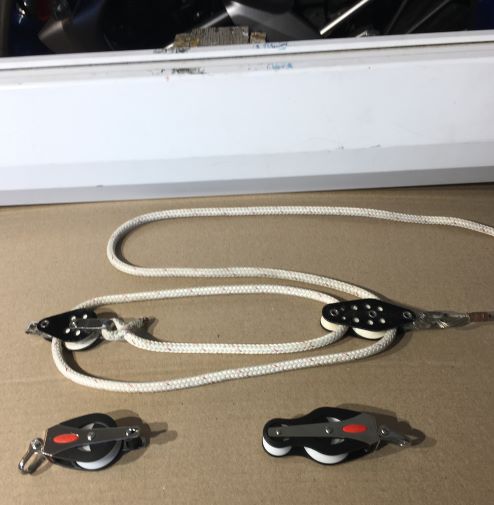

The blocks for the outhaul were in good shape but instead of using a becket for the end of the outhaul line, the block used a stamped shackle that was too small and “pinched” the sheave so it didn’t roll freely. I replaced that with a Ronstan block and since it was too easy to buy a new fiddle block at the same time, I replaced them both. Original blocks on the top, new ones below:

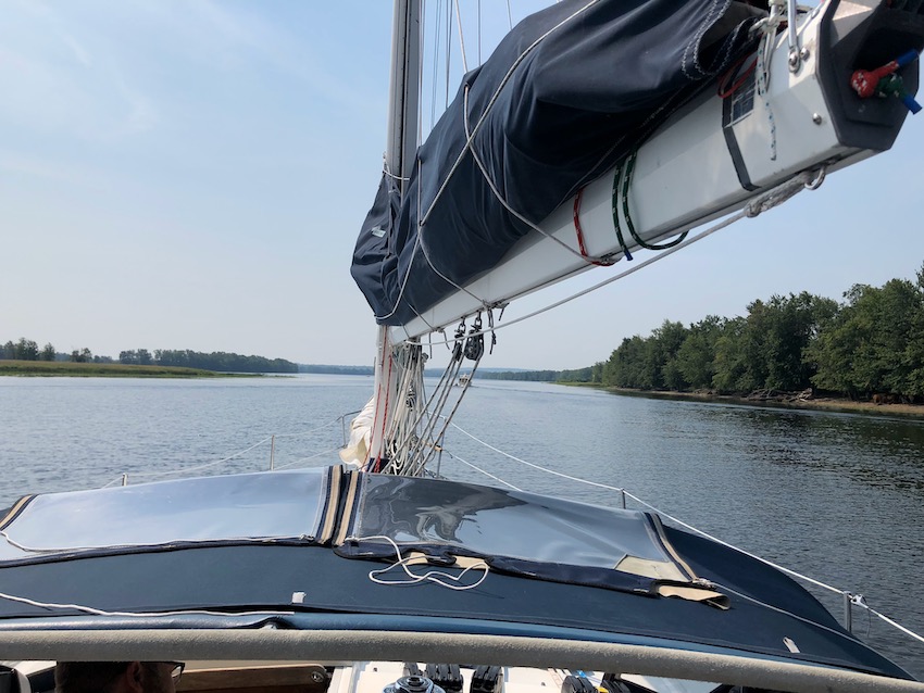

  2. Add a pad eye for a permanently rigged preventer pennant. While I had the caps off, I decided to install a small pad eye in the channel on the underside of the boom at the aft end for a preventer. I think I had to grind a little bit off the side of the pad eye to make it fit in the channel, but after that it was simple enough to drill the holes, and then fasten it from the top down with truss head screws and nylock nuts on the exterior. I also added a new cleat to the underside of the boom, just forward of the one for the lazy jacks. Once it was all back together, I tied a piece of 9mm dyneema to the pad eye (I’ve since replaced the knot with a proper splice), and ran it forward to the new cleat. Now, whenever I need a preventer, I can just take it off the cleat and tie it to the bow cleat. Of course, the ideal way to do it is to run two lines forward to cleats on either side of the boom, so that you can just take whichever one is upwind. However, I didn’t quite have the real estate for it, and I thought it might look a bit busy. It’s not too much trouble to lead it around the main sheet when necessary, especially if you remember to do it beforehand!
