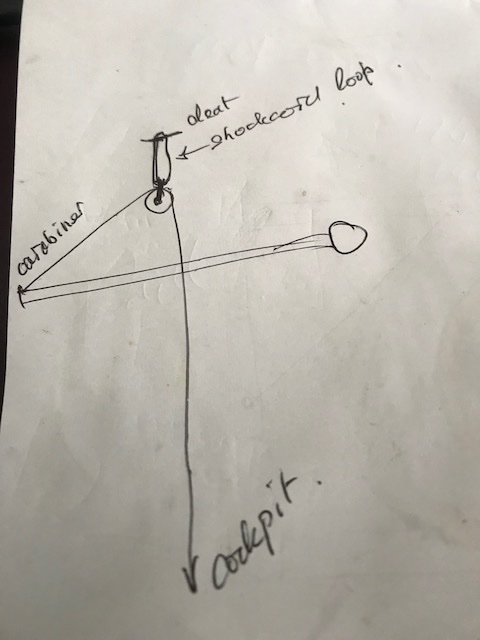

I added an easily attached rig that gets stored in the cockpit and can be rigged in minutes. Not on a freedom boat but a Coaster 33 that I have just sold. Although a gybe was relatively safe on that boat, I found it useful when polling out the genoa wing on wing, dead downwind. I had a carabiner attached to the sheet eye on the end of the boom, which ran through a block attached to a forward cleat by a shock cord loop and led back to the cockpit. Also useful for holding the boom out when I deployed my flopper-stopper at anchor
