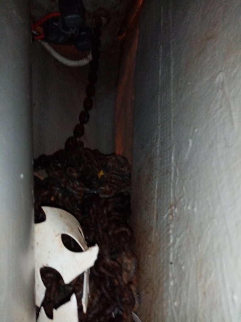

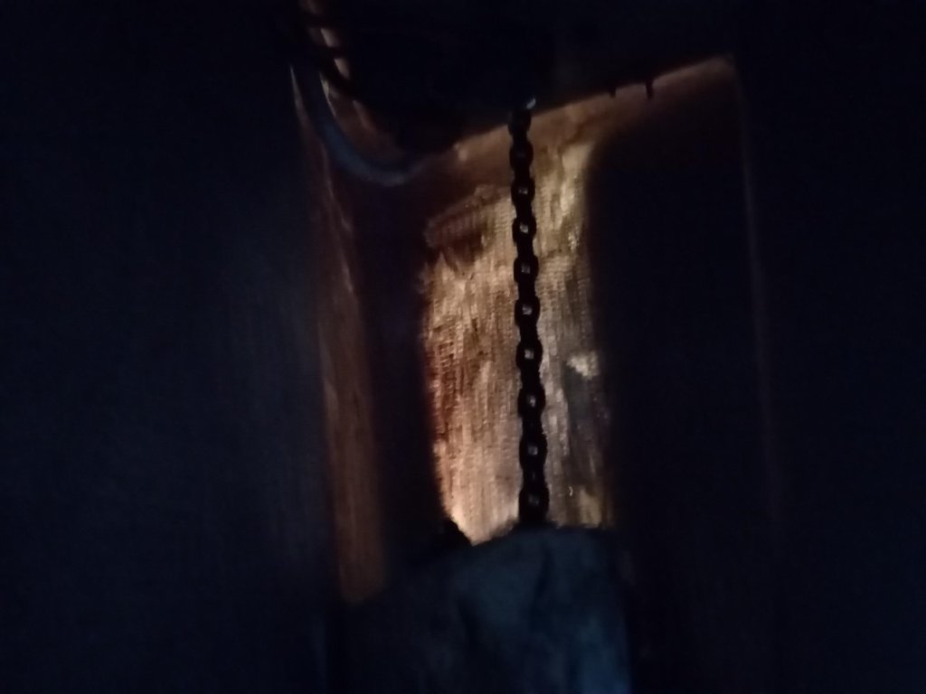

1_ storage and condition of the anchor chain, the chain does not have a special compartment for storage, I plan to make one.
on this photo you can also see that the hull is thinner at the bow, you can see in transparency that there is no balsa on the 30 cm (1 foot) of the bow… is this normal?

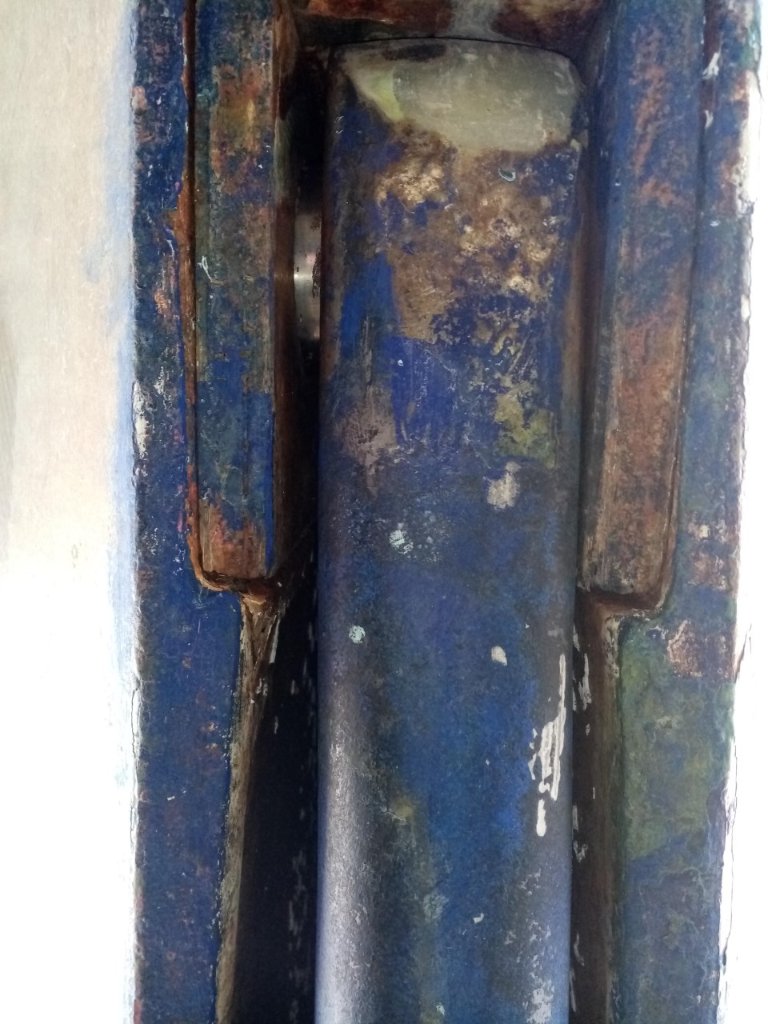

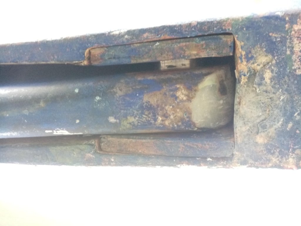

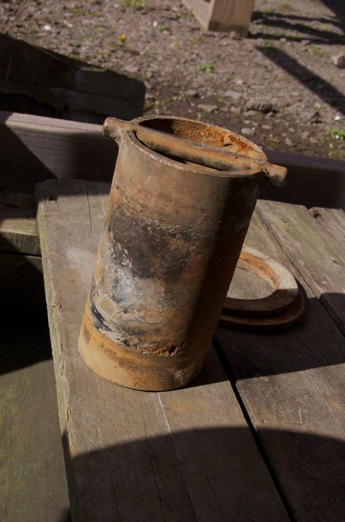

2_ the daggerboard, it looks like it’s shifted on one side and that the system that holds the tubes is a bit damaged… is it serious?

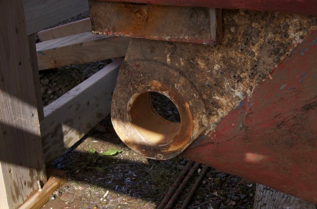

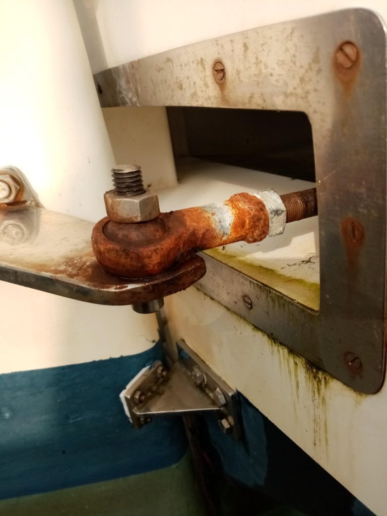

3_ rudder, the ball joint is very rusty and I don’t know where to buy a stainless steel one?

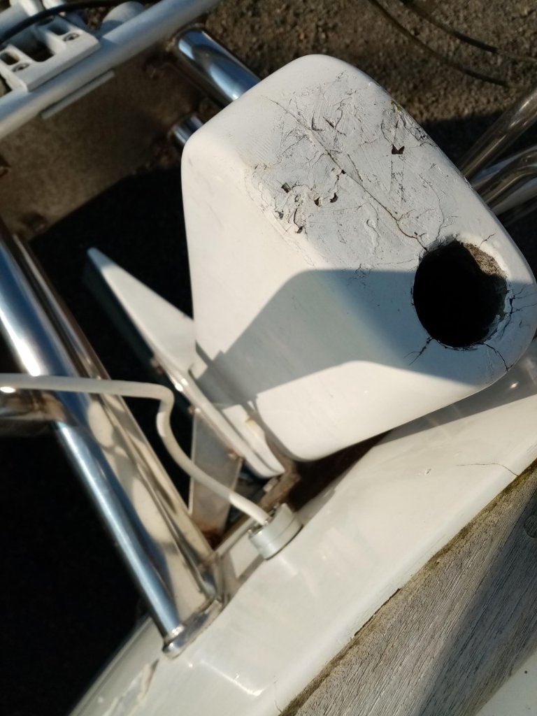

4_ the rudder has a lot of cracks, could water have got into it?

Your centreboard: it looks as though someone has already been at your CB bearing; it’s very shiny! I had mine replaced about ten years ago, when the boat was 25 years old. The tube which forms the bearing was worn and rusty looking. There were a couple of nylon washers either side of the board, too (seen here behind the tube), which are not visible on your boat.
The bearing surface on the board itself wears, too. It is a nylon sleeve, which I had replaced. The next picture shows the original still in situ.
I have no idea where you might get another connector for the steering rod/rudder ball joint; is it entirely beyond refurbishment? Though I do have a spare, it is in another country, and, unkindly, I feel I need to keep it. When I get back to the boat, I might be able to measure dimensions, if that would be any help?
It’s probably worth sealing the cracks in the top of the rudder. It may be that the only reliable way to test for water ingress would be to drill a small hole low down, and see if anything comes out. I have never dared to look. What happens to the water that gets into the hole for the emergency tiller?

nice boat, what a great feeling to own a new vessel and yes… then comes the work required! Concerning your balljoint, I am sure you could rescue it, assuming you can detach it. Suggest a good clean followed by some phosphoric acid to stabilise the surface and a few of coats of a good zinc based primer before paint. Mask of the ball joint obviously. For that I would recommend Top 2000 a great longtime grease that is incredibly sticky. In the past I have used it on a prop, to avoid barnacle growth, which I found to be better than anti-fouling. Unless you can replace it in stainless, it’ll probably be a regular maintenance item.
For the rudder I think you are looking for a “Ball Joint Rod End” made of stainless steel. I can’t say if this will meet marine corrosion standards but you can find them here:
https://www.mcmaster.com/rods/rod-ends-and-linkages/material~stainless-steel/
This is where I get a lot of my hardware.

The ball joints are a standard fitting but very expensive. I got two from Cliff Mogridge who you will find with Google. They have a non-metallic bearing surface which eventually wears away and then they make a ‘click’ noise and are loose which is bad for everyone, especially the skipper.
Getting them off may be very difficult. I used heat and a gear puller, but it’s hard to find one that fits. I had to destroy the one under the pedestal to get it off after removing the whole steering system - a horrible job.
If you want to remove the rudder or work on the ball joint, it may sometimes be easier to remove the ‘tiller’ at water level - held on by six bolts. It is very important to get the turns exactly right when putting the tiller back on.

The rudder is probably full of water and can never be repaired properly, but it is very strong. A good GRP boatyard cut the side off mine and dried it out and put it together again but we both know that it will go bad again. The stainless steel inside was OK.
Don’t try to fix everything in the first year. Enjoy some sailing too.
