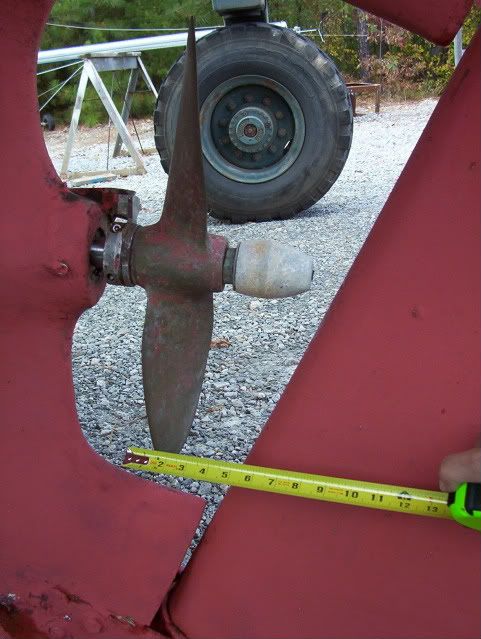

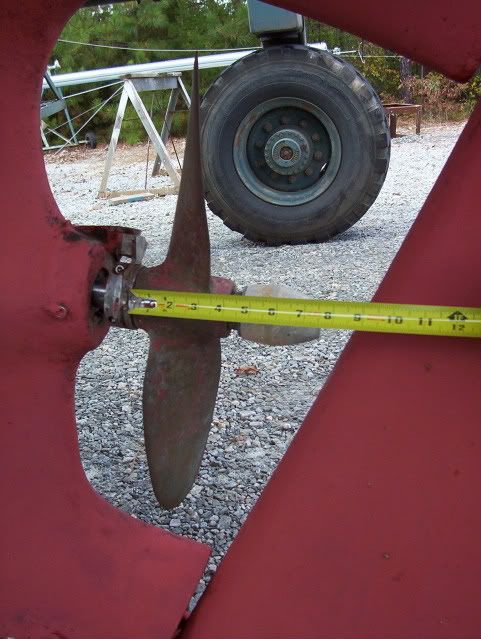

Ok! I’m still not sure the kiwiprop will fit on the F-40 CK. I took the plunge yesterday. Not sure if it was great idea that water was COOLD! So I only had time to make some very gross measurements with my wife’s sewing measuring tape.
The opening from top to bottom is about 26" so no problem there. From the cutlass bearing, along the shaft, about 10.5" to the leading edge of the rudder (take with a grain of salt, these are really gross measurements. I had a windsurfing wet suit trying to float me back up and it was freezing cold).
Kiwiprop calls for 8.25" clearance:
http://www.kiwiprop.us/space-requirement.htm
I am concerned that since the rudder and shaft are not at 90 deg angle the lower blade may be too close when feathered.
I guess some more measuring is in order.

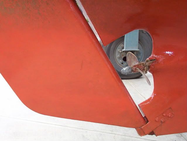

By nature of the force of gravity, with a three bladed feathering prop, one blade will stick up and two blades will hang down to port and starboard. If the blades can pass the rudder in the feathered position, there’s not much to worry about. If the prop is working, the distance to the rudder is much more critical.
Hmmm! Looking at the picture above, I am not sure there is enough room for a puller for the prop and just barely enough for the prop itself to come out.
Does anybody know if the rudder needs to come off to replace props?

I’ve had our prop off and shaft out without removing the rudder.
George
Wow, that is good news.
I know the zinc at the end comes out, but were you able to fit a puller given the small clearance? In the picture looks very tight.

OK, I hauled the boat last week-end for unrelated maintenace and took advantage to measure the prop operture. The prop in my boat is a 2 blade 19x15 RH “Sailor” model, and it feels underpropped (engine can over-rev)
Unfortunately the Kiwiprop will NOT fit the F-40 (requires 8.5" clearance at the tips). The only feathering prop that will fit is the “aperture” model by Hydraling and maybe the smallest VariProp model.
