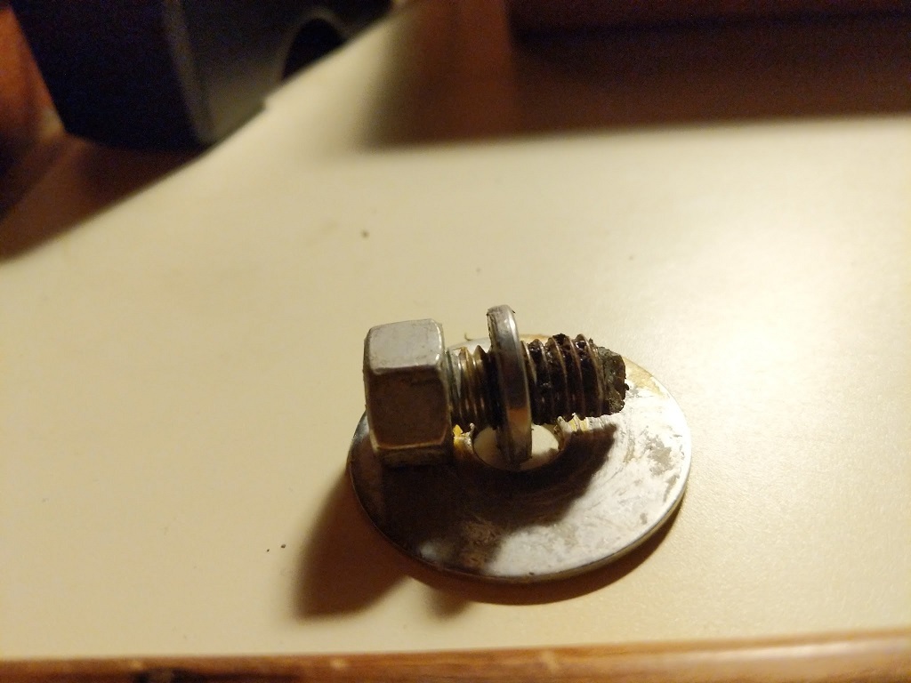

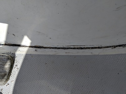

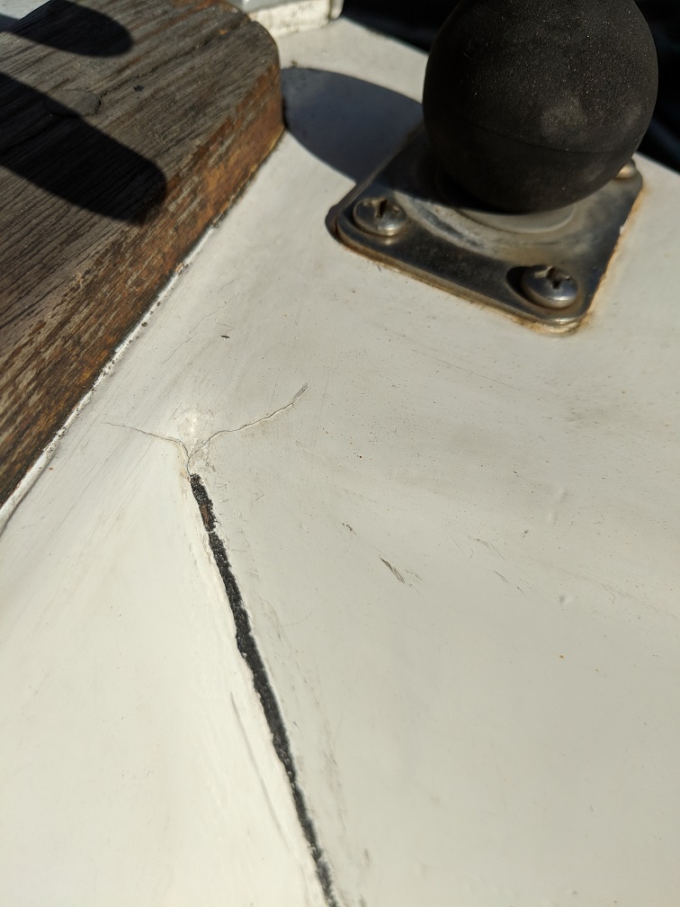

I know this is a really old post, but want to resurrect it to see how others have managed their “leaky” sugar scoops. Here’s what’s up with mine. It appears to be separating a bit from the transom because it fills with fresh water. I checked the bolts last night and a couple were loose enough that I could tighten, and one sheared right off in my hands! It seems clear to me that I need to drop the sugar scoop, rebed with 5200, install beefy bolts, fiberglass the gap, and reattach; but, I often look at solutions with a hammer and chisel in hand, so would like to be a bit more thoughtful on this. Who has rebedded their scoop and not just put in a drain hole? The port openings are on either side of the transom and I don’t see how I can reach in and get to the nuts in the middle, which actually seem like they might have been fiberglassed into the scoop so that might be helpful if I can remove the bolts from the inside and just replace. It appears the gap has been bedded with butyl and it’s still rubbery. At the lowest point, I can put the flat blade screwdriver in a little ways (maybe 2-3 mm), which might be how the water is coming in, but it seems like the gap outta be bigger given the amount of water that gets in there. Am I overthinking this and just need to tighten the bolts and drill a drain hole? Your thoughts/ideas would be greatly appreciated!
