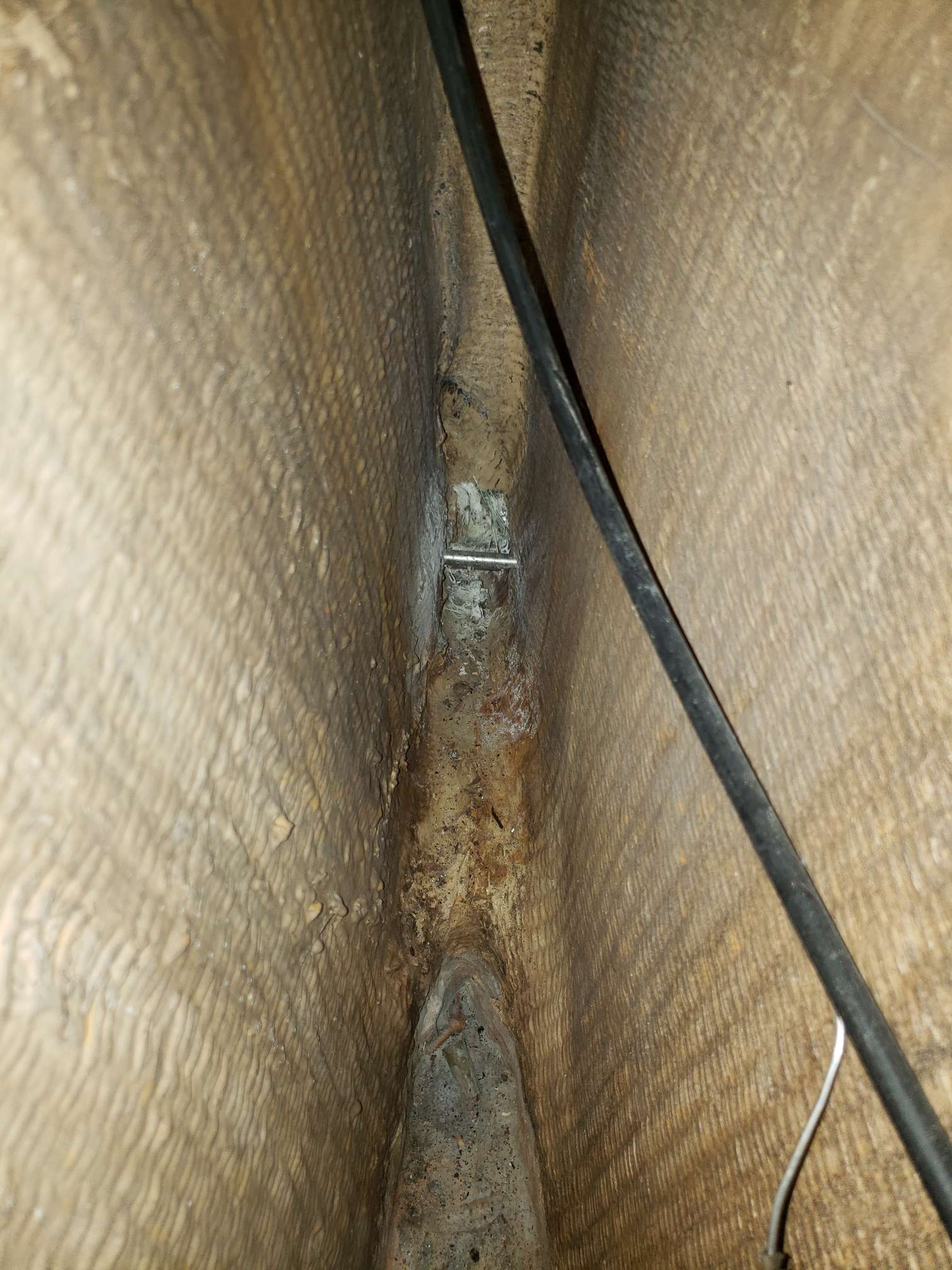

Are your gudgeon bolts in the bilge/transom are? Hard for me to get a good loock since a modified diesel tank is blocking my view. And it also seems to be a solid area with epoxied play wood in between (check picture)

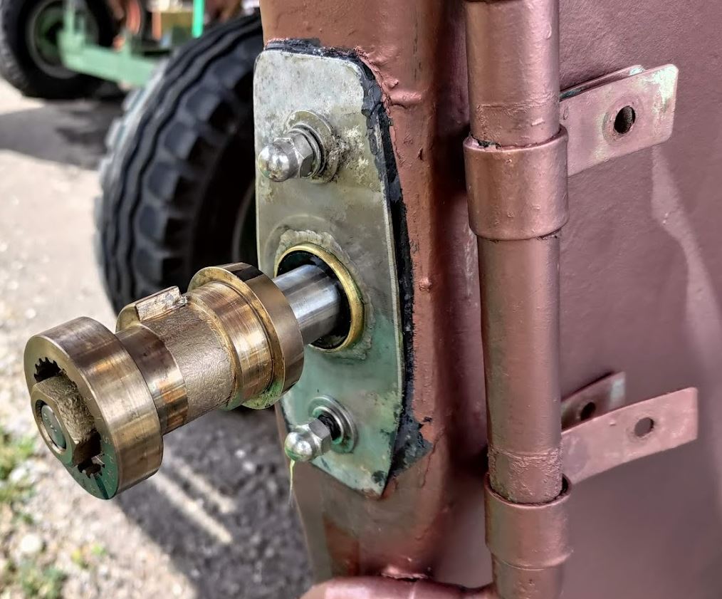

Or it might be the sterntube bolts, since I had them loosened last winter while installing a new prop.

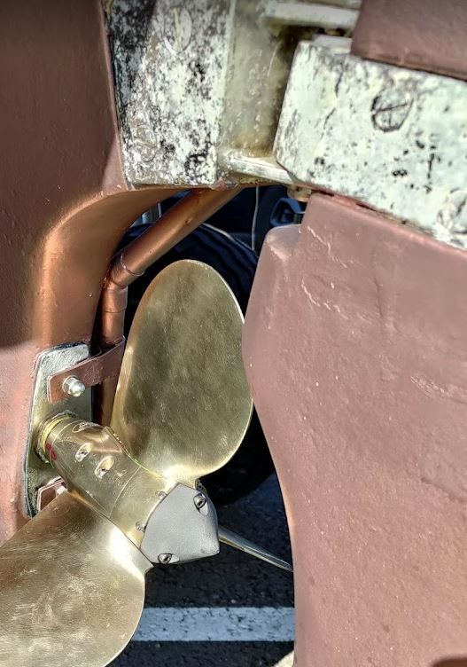

What’s that pipe/tube thing next to your propeller?
It is a cable protection for an older sonar/fish finder and will eventually be removed.
