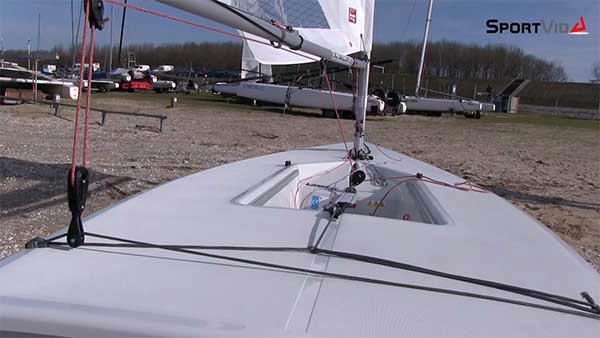

Interesting thought. When I read this, I thought of a Laser traveler.

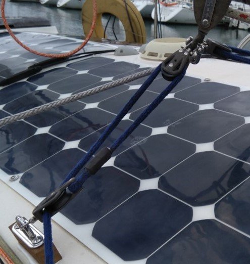

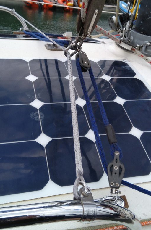

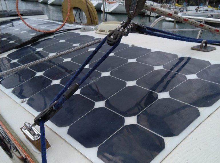

Here’s my “soft” traveller.
An 8 mm braided Dyaneema line, attached to the handrail, with very little slack, that serves as a guide and takes some of the upward tension load from the boom.
Two 8 mm braid-on-braid polyester as control lines on either side. These I attached to the cabin roof, over a little block of teak to provide a safety gap above the solar panels.
I tested the prototype a couple of days ago. Without the traveller, Nausikaa would just refuse to move at any less than 45 deg from the wind. With the traveller, yesterday I was doing 5.5 knots on 20 apparent at just over 30 degs!
Overall, very pleased with the result. The whole thing still has to prove sturdy enough, but so far, so good!
Cheers
Rafa
