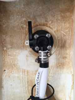

I have Forespar Marelon valves as thru-hulls on my F35 Pedrick. The po had cable tied all the thru-hulls in the open position. I removed all the cable ties except for the 3/4" water intake to the electric head. For some unknown reason I left that cable tie intact. Of curse I would work that valve every time I was on the boat and me, myself, and I eventually cracked the valve housing. The cracked valve would leak pretty good in the open position and leak slowly in the closed position. I called a boatyard for an estimate - about $735 for haul, breaking out the old valve and replacement - 2 hours of work. Yard said they didnt do replacement parts.

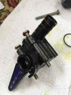

I emailed Forespar with pics of valve - got their part number - they sent me instructions on replacement the valve in the water - so for $85 (part and shipping) I replaced the valve in the water - sweet. The handle have a white plug - plug fits into the hull-side of the thru-hull. Insert the plug with a string on it and work on the valve. Pull the string and done.
Pic at top shows new assembly. White plug is seen with loop. Bottom pic is cracked valve removed.

Can you tell where the valve is leaking? Forespar is easy to work with - the valve has numbers on the side and you can call forespar and get a replacement kit - the handle lever, black stack with 4 bolts/screws. Pretty easy and inexpensive fix. Basically the replacement kit is everything in pic two above.

Sorry haven’t seen this! With the boat in the water, take the white plug on the handle of the valve, tie a line to it, go under the boat and insert it into the through hole. Should fit perfectly Then with all parts ready at hand :stuck_out_tongue_winking_eye: remove the 4 bolts, remove the housing, replace with nEw housing and replace bolts. When done pull the line to the cap and should be good. (“Should be…” is always an interesting word combination).
