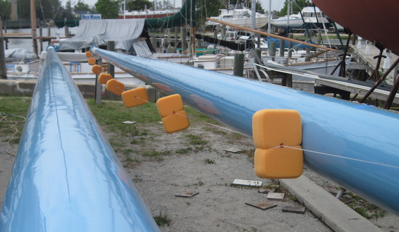

I thought I was smarter than that, so I did something different. I cut sponges with a hole in the center and down to the width of the mast, and ran some light string between them with a loop tied loosely around each one to keep the sponges spaced out (about 3-4 feet apart). I’m not sure what happened, but one of my sailing friends was probably right when he said “gravity.” I suspect that some way or another, all the sponges are on the bottom of the mast, and that is what I’ll find when I get them out.

Yes, by cables, I mean the ones for my masthead lights, VHF, wind instrument, and lightning conductors. I’ve attached a pic of them before they were installed. I’ve still got some leftover sponges and cutoff parts of sponges from this job, and they seem to be holding up pretty well. I’m starting to suspect that my string just chafed through, and they all slid down.

Yes, the wires do go through the sponges inside the mast. I couldn’t find a pic of the wire bundle with the sponges on it.
